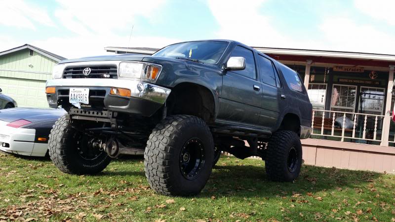

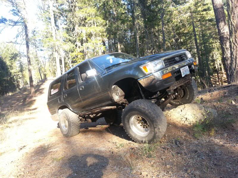

I've already started fixing things while making it my own at the same time here's a couple pictures and there will be more to come soon!
this is what it looked like when i picked it up on 33's, this was the first time out.
after that i found out that the cable for the transfer case shifter is shredded in one section which limits me to 4H only... i ordered a new cable from GMpartsdirect.com and the cable i got is about a foot and a half too short..
i put new wheels and tires on about 2 weeks after that and it looks much better with 35's

Did your death wobble continue with the new tiress? The fronts actually look very worn down.
DW can be attributed to worn TRE's, spring bushings, steering box, wheels/tires out of balance. Even the front spring could be out of square..yours actually does not sound too bad..
just noticed the cut out on the inner front fender well..probably want to patch to avoid crap getting trapped up there.
