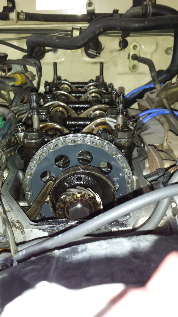

I replaced the headgasket on my 87 22r and did a valve job and resurface (shop said only a little was removed)
I put everything together but when I put the chain on I didn't plan the position good so I moved it (I don't remember exactly what happened )
And I just used the mark on the sprocket washer and dot on the cam sprocket to line up with the crank pulley mark at 12 o clock.
I remember my first attempt to start didn't go well because of the fireball in the carburetor :0
​​pulled the dizzy out, turned the engine 180* and re-installed it and it fired right up with a slightly high idle about 1000-1200
Later I installed a working vacuum advance an the idle went up even higher to like 1300-1400 then I installed a aem wideband to verify my fuel afr and it was super lean so I richened the carb and the afr's are good now buy I'm idling at like 1700!
I re-sealed my intake manifold and my carb to the intake manifold but no help. I also replaced all the small vacuum lines with silicone vacuum lines. It took like 15ft!
Here's a pick of the cam timing with the engine at TDC
Any suggestions?

When you check your timing with the light how does it look ??
If the cam gear is off it won`t even be close to where it should be.

when I check with the light it's at 8* IIRC with the hoses from the vac advance unplugged
Whatever it's supposed to be at but at a much higher rpm.
