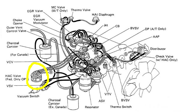

I live at 5000' here in Cody. I am not sure if this has the high altitude package or not. The vin # does not indicate anything. Is there a way to tell without pulling the jet?

That altitude isn't super extreme but it may make a difference. The HAC is located on the passenger side fender wall, looks like this:
You jets may be different as well, but determining if your truck has the high altitude package would be a start.
