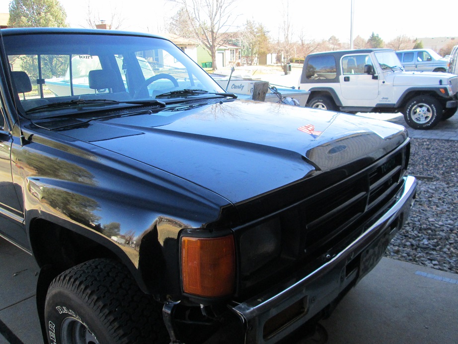

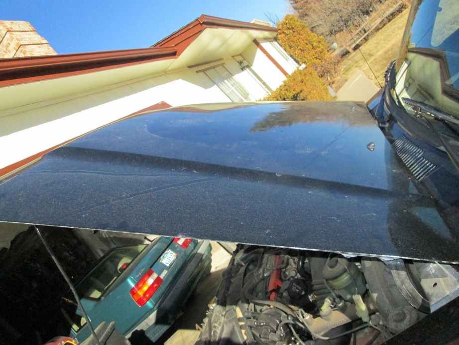

I did find a better hood at my local pull & pay yard last week and did the swap. My original hood had a lot of hail damage on it. More than I wanted to deal with.
Attached Thumbnails My to-do list-001.jpg   My to-do list-004hail-damage-last-september-.jpg   My to-do list-005-detachment-windshield-washer-hoses-.jpg

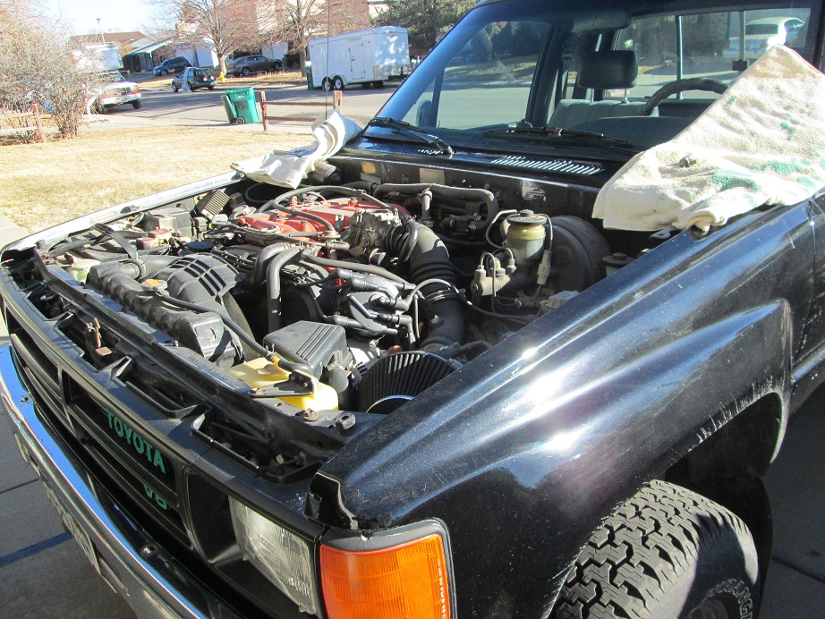

Then I removed the old hood. Nothing hard about this, but I did use some old towels under the corners of the hood to prevent more damage to the cowl and fenders.

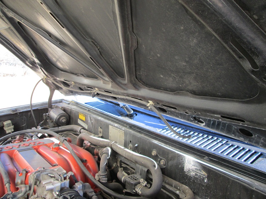

I had to pull the windshield washer nozzles and transfer them to the 'new' hood. There is just one "locking" tab on the bottom side of the nozzles and it is very easy to break these off if you don't squeeze them from underneath and slowly work them out of the opening. I also had to address some broken hose clips under the hood.
Attached Thumbnails My to-do list-007.jpg   My to-do list-008-windshield-washer-nozzle-attachment-.jpg   My to-do list-015-broken-tubing-hangars-replaced-.jpg

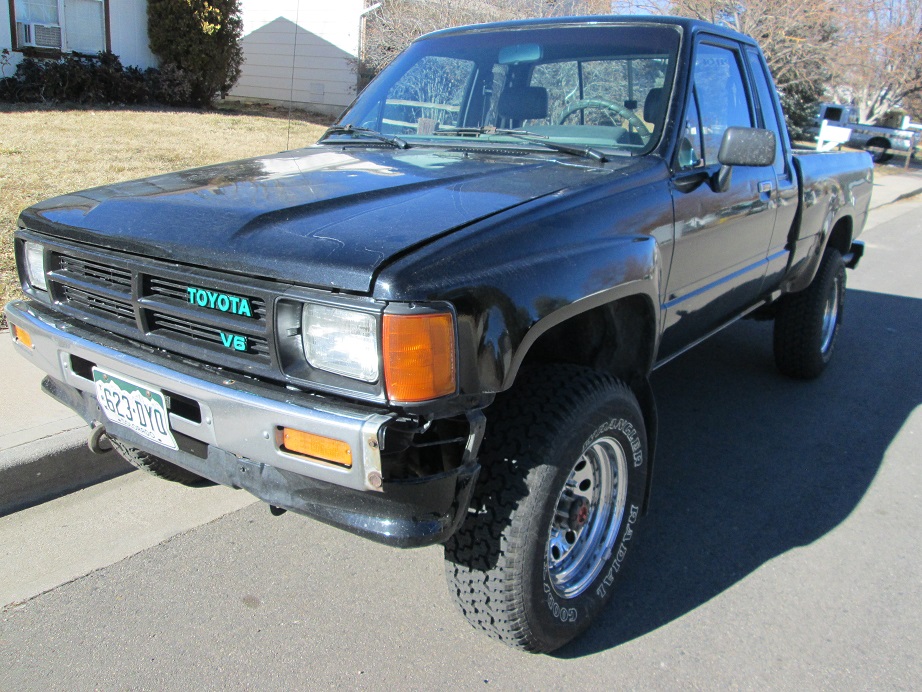

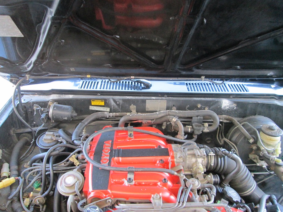

Then it was just amatter of attaching the 'new' hood ( 4 bolts ), reattaching the windshield washer hoses, and realigning the hood seams.
Attached Thumbnails My to-do list-016-hood-pull-pay-installed-.jpg   My to-do list-019-windshield-washer-tubing-installed.jpg   My to-do list-020.jpg
