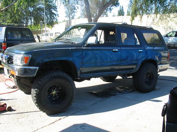

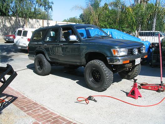

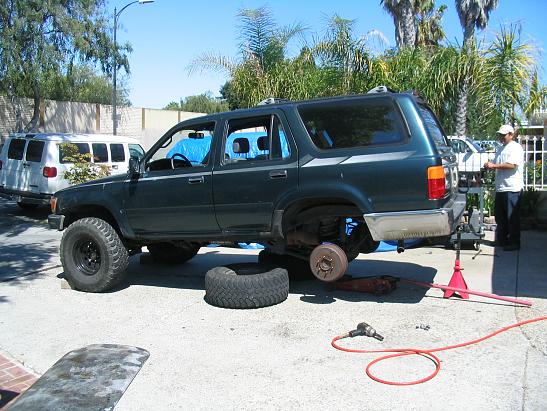

Today Robert aka "RMA" and I installed FJ80 coils & 4crawler BJ spacers on my 94 4runner. Total time took about 3 1/2 hours. Thank you very much Robert for all the help man! I really appreciate it! Couldn't have done it without yah!

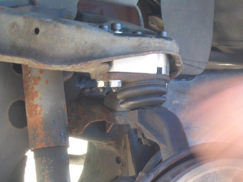

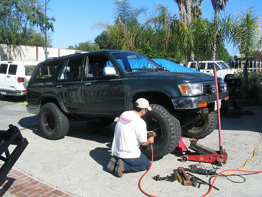

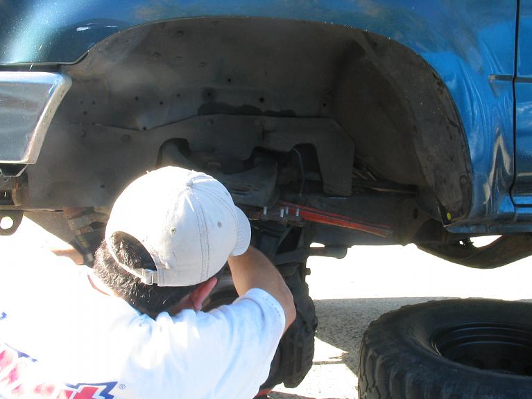

Working on installing the front bj spacers. Last picture is with bj spacers installed w/o the rear 80 coils.

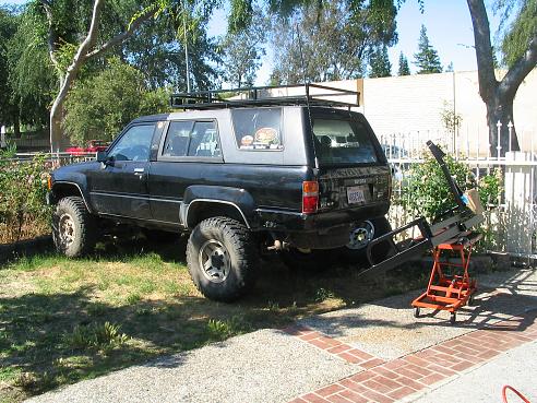

2nd pic is Robert's Lexus V8 powered 1st gen! Very SICK!

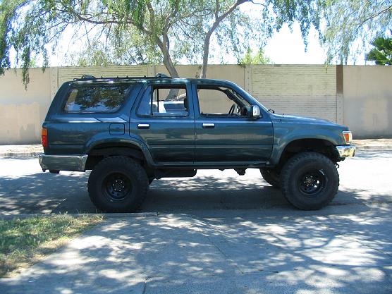

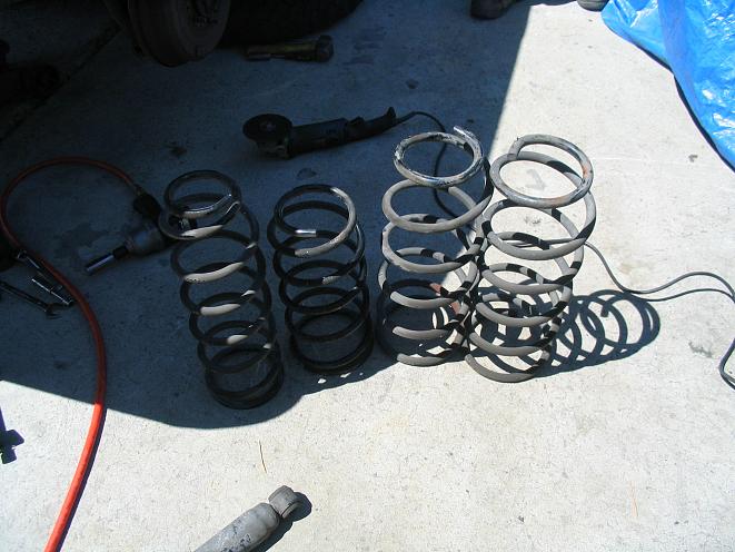

2nd pic shows the coils. From left to right: fj80 front coil, stock 4RN rear coil, and fj80 rear coils. Last pic shows the end product!

Looks sick! What size BJ spacers did you use? What was your total height gain?

He said he got the BJ spacers from 4Crawler so I'd assume they are 1.5". Unless he got a custom size set I guess..

Yup I used regular 1.5 4crawler spacers. Not sure how much it lifted (forgot to measure) but I would say 2-3 inches (t-bar wasn't cranked either).

So I'm confused, did you install fj80 coils in the front of the veichle, or is the front only with 1.5" BJ spacers? So just so I understand so I can plan my ifs lift you have only 1.5" BJ spacers with stock 4Runner coils and struts up front. And Rear is FJ80 coils with stock length 4Runner struts? Are you running the front FJ80 coils in back or are you running the rear FJ80 coils in back? Did you get the short sided coils or long sided coils? Or one of each?

The front is 1.5" ball joint spacers. The rear is STOCK rear fj80 coils. 2nd gens dont have coils up front. You cannot run stock shocks with BJ spacers and FJ80 coils... So you'll need to upgrade them. You could also do brake lines up front and will probably need them in the back. You'll also need to adjust the panhard and LSPV.
