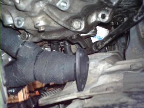

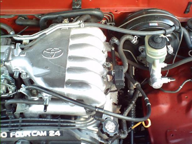

Well I have attached a few more photos of work done today THE MOTOR is IN!!!! Now for the easy stuff right... oh I wish..
Oh only thing I dont like about my crossover is flange is hitting heatshield under truck. I over compensated, but I will fix this and install a flex complier as i seen on mtgoat's thread. Mtgoat thanks for the advice on cermic coat I ran out of time at shop and had to put motor in today... hope it goes good with second flex on down pipe.

Did everyone's motor stick out this far, mine seems to stick out further then all pictures I have seen on here...maybe thats cuz i got the new 3.48675

If thats the heat shield that bolts to the the frame, just remove it. There was no way mine would fit either with the cross-over coming down that side.
Can't really tell in your pic how far the air chamber is sticking up, but with a 1" body lift mine doesn't touch the hood. There isn't much you can do about the engine height. Depending on how much interference you have, you'll either need to cut the reinforcement ribs under the hood, do a body lift, or cut the hood and cover it with a scoop.

After looking at the pic again it looks like the hood will hit the air chamber and throttle body.

I cut that heat shield on the frame in half, that was the only way I could get in back on. So now I have 2 heat shields hehe. I may have bent it a little too.

Ya I plan on cutting heat shield in half and taking out only half. Also from all pictures I saw only little hole in hood n add scoop. But with my motor bolted down it still looks like a lot more is sticking out then that little coner. HA no biggy I will just find a nice custom scoop cause i AM NOT A BIG FAN OF BODY LIFTS

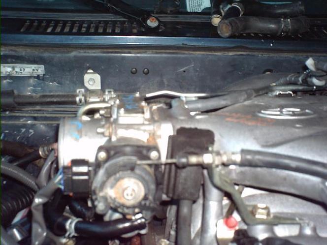

Well I am just try to do all the mechanical type jobs before I even take a gander at the electrical. So I got heater hoses, throttle cable, old cc out, few hoses all done. Problems I am running into is my trottle body doesnt have a hook up for my kickdown from trans or a place to hook up my cc cable, I am going to not worry about cc for now but I dont see why a my throttle body doesnt have a spot for my trans. If anyone has a 2002 or so 3.4 with a auto please look under your hood and post picture please. I am also having hard time figuring out how my harness is going to reach to ecu on ps kick panel... anyways I am just trying to do little everyday... sorry for no pic this time

This is a 2001 throttle body, note the CC cable is the one in the back.

Mtgoat that is exactly like what I was hoping mine would look like but as you can see from my picture way different. Just to claify my donor truck was a 2002 4 runner 4x2 with auto trans I got motor and ecu. I talked to Jonathan at rancho toy truck and he said that the 2001 and up 3.4's have an eletcronic throttle body that is controlled by the ECU for cruise control. And the newer 3.4's dont have a provision for the kickdown cable, he also said this is only TB that will work with my my harness and ecu.
The thing is when I bought this motor it didnt have a TB jonathan found this one and installed it for me, I dont want to do some jerry rig kickdown cable setup so I am just trying to figure out what to do.
I am also freaking out cuz I read in another thread that my setup is not going to shift right do to trans speed sensor. I have a 1992 truck with out I !!!!!bought the above items because I was told by rancho it would bolt right up and I could us my trans.... Now I am either reading it wrong or it basically is going to always throw error and run in a limp mode and shift wrong,, So this is what I am freaking out about right now.... Please someone out there has to know what I need to do. is there a fix or do I have to get newer trans and what about axle drop for 4x4. Son of a b@%$&%!!!!

... I talked to Jonathan at rancho toy truck and he said that the 2001 and up 3.4's have an eletcronic throttle body that is controlled by the ECU for cruise control....
I thought it was 2003 and up. Maybe the 2wd is different?
