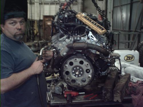

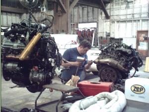

Here's my 3.4 beast... not that u havent seen one
Well I thought I would show a few pictures of my new motor and even an action shot of me1ambrose... We are using a huge shop (CAT SHOP) at my work since the sawmill is shutdown this week. All over head hoist and everything its pretty sweet but with sawmill coming back online next week my project will have to be moved to the tarpped over canapy at my home...
Anyways here r some pics...
The one picture is the dipstick hole we drilled in about 5min. first with pilot hole of 3/16" AND THEN A #V drill bit and a numatic right angle drill... As Elvota had suggested in his swap thread. This was a lot easier then we thought it would be.
As of right now the plan is to use the 3.4 p/s, alternator, a/c, and starter. If you guys see a problem with this let me know.

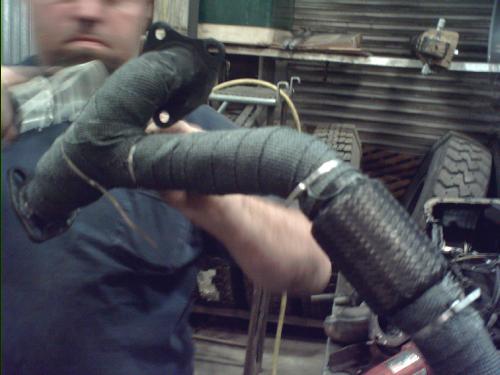

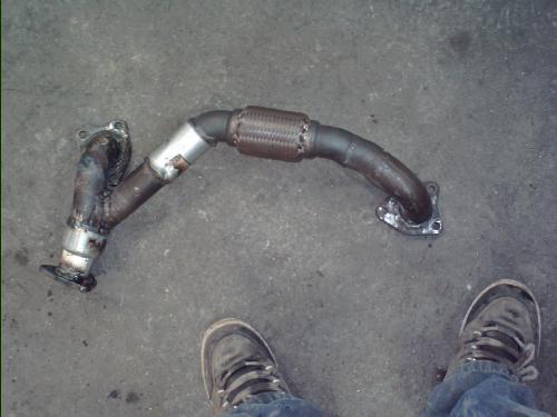

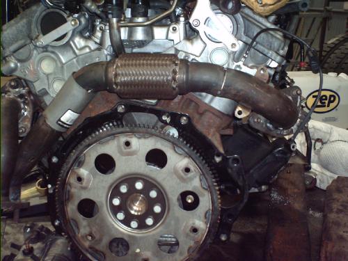

Engine readines and Crossover pipe mod
Well today me1ambrose put in a longer day then I did but anyway we got the engine mounts off the 3.0 on to the 3.4. The oil dip stick is complete and mounted, Fuel line is rerouted to Passenger side, and Crossover pipe is put together and welded about 65%, tomorrow I am cutting off the double pipe collector and fabing up a single collector. This will give me more room as well I saw few guys had problems in this area and had to BFH their firewall, dont get me wrong this may be my backup plan as well.. HA ha I hope it fits. Here are a few pictures I followed how jason4x4 did his crossover. If you want more details got to following link. https://www.yotatech.com/forums/f160...r-pipe-138902/ And the price so far for me to make is about $75 for the wrap alone(I might take this back and get smaller roll, $3.00 for coupler, and another $15 for stuff I am suppose to spray over the heat shiled rap. Oh and that is me Millwrightbrian cutting https://www.yotatech.com/forums/imag...enchainsaw.gif on the crossover and me1ambrose "joe" welding it up.
Crossover Notes:
1 After 2001 they are all double wall and only good for the flanges. cut flanges off pipe and save.
2 Obtain old crossover pre-2001, rancho toy truck gave me one for free.. kick azz.
3 Follow jason4x4 thread... Its pretty simple! and he did good job of step by step procedure.
Best tools: (basic fab tools)
- Die grinder with cut blade and sanding wheel
- Grinder with cut off wheel and grinding wheel
- Tourch
- Wire feed welder
- and what would have been nice is a sawzall that some body forgot to bring to the shop.
