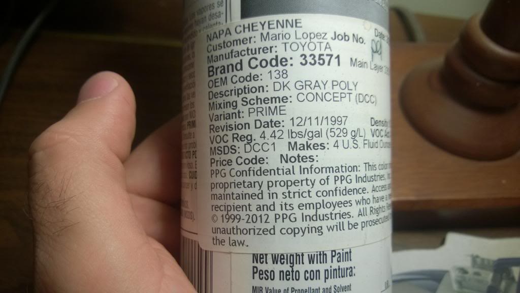

I don't consider myself to be the obsessive type...

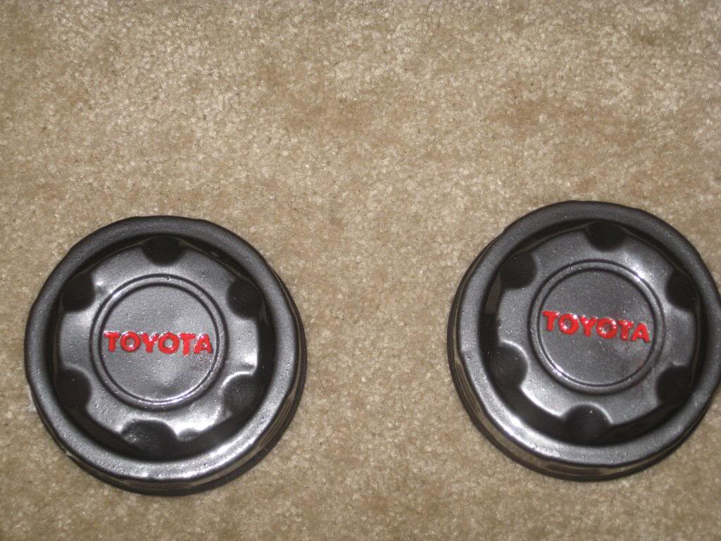

What it looks like

Snobbs...I found that paint code you posted a few minutes before you posted it. I copied the pic just so you felt useful...not that Im gonna order..I mean use it.
cough thanks cough cough. mumble grumble.
