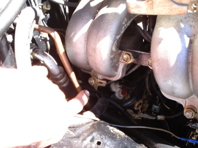

radrace2001's Avatar
Joined: Feb 2009
Posts: 18
From: Las vegas
thank you for the response. i am sorry it did not help. it might be in the higher rpm's for that problem. have you checked all the grounds on the motor especially the one on the intake? you might have a bad connection there. it controls your injectors add other sensors i believe. you can try cleaning it and making sure the bolt is tight.
Attached Thumbnails Mass load of parts replaced, still no start-22regroundstrap002.jpg
