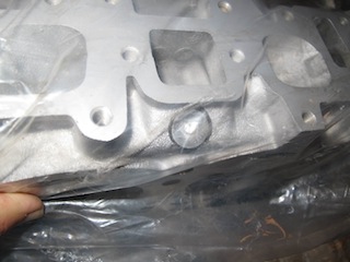

Also does anyone know what this hole was drilled/plugged for?

That looks like the normal sand blasted and hot tanked finish, not paint.

that should not be drilled all the way threw. most of the time the shop that did the work will put a item like that on to mark it as one that they did for any warranty
work that the customer might come back to them with. it should have numbers or something on it, that way they can identify it was there shop that did the work.

I had a plug like that on a head that I had machined and they told me it was basically a tattle-tail plug to see if the head got too hot if you try and warranty it...

If you overheat the engine that patch will fall off and will void the warranty.

My neighbor said the same thing about that thing I thought was a plug, that it falls off if it overheats/warranty thing. It does have numbers.
