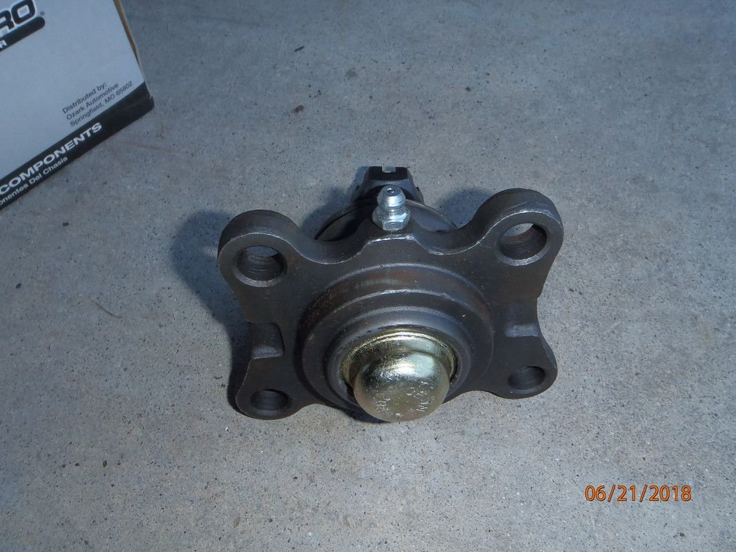

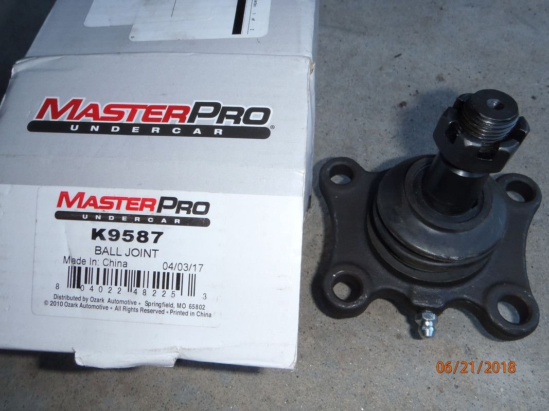

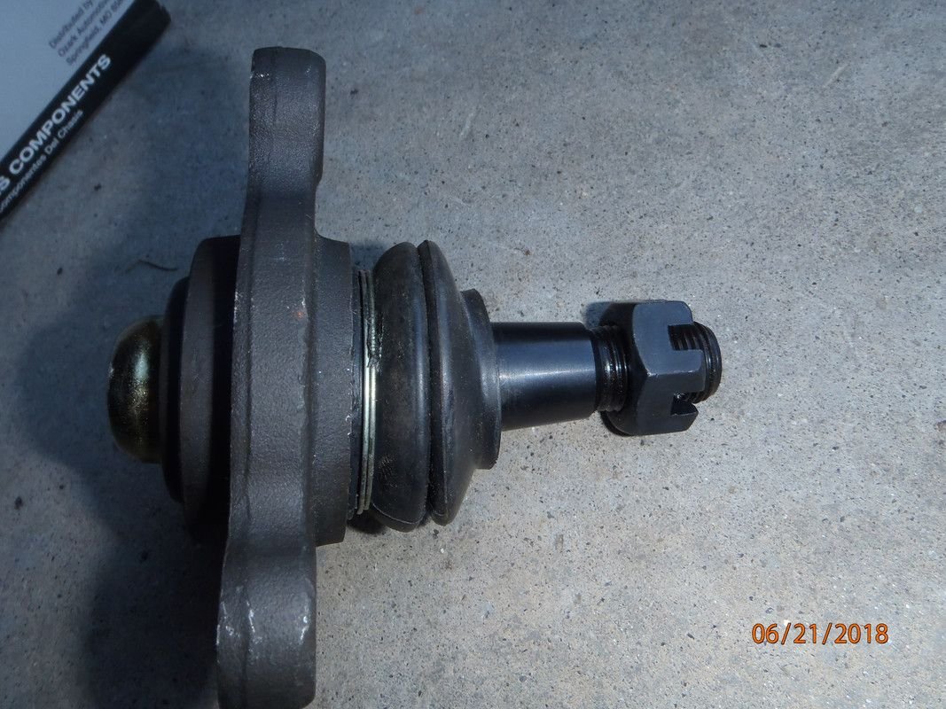

masterpro k9587? i could get it to either sit in the knuckle recess correctly, or align the four bolt holes correctly, but not both things at the same time (which meant it wasn’t installable).
purchased for the '88 beater in 2018.
That's right

hard to believe these are still being sold. i purchased one 3 years ago, and it didn't fit (it had too much chinesium in it). apparently hasn't been changed, just sell ˟˟˟˟ty parts. this was for the beater '88 that has now become a parts donor for my two '87s.
