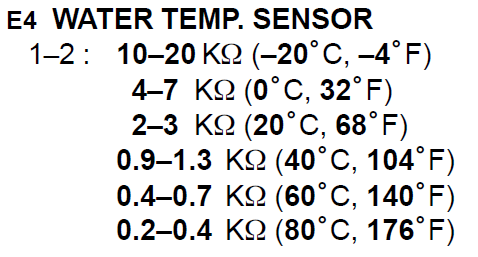

Ohm test the sensor body to ground and check the resistance, should be at or near 0 ohms (200 ohm setting is best if not automatic).
If you disconnect the temp sensor, ohm meter between the terminal and the housing (or ground) and here's the specs at different temps just to validate the actual sensor is good.
Assuming the wiring from the sensor to gauge is good (could test the ohms directly there to see, but pulling the gauge cluster is a bit of work), I'd guess air in the system. If there was no coolant work done around the time the issue came up, was the coolant level low? If not, maybe head gasket leak? If low, coolant leak of some sort maybe, like hoses, water pump, etc. It's possible to blow a head gasket with out loosing cylinder compression, just not too common that I'm aware of and only is a coolant leak in that case. My dad had a camry that did that before. If you do a compression test on all 4 cylinders, that would check to see atleast if the cylinders are sealed and not pumping air into the cooling system via blown head gasket. Could also smell the exhaust, coolant burning has a bit of a sweet smell, I've grown up knowing the different smells though (oil, coolant, rich, etc), so not sure if it's too easy to translate to other people though xD.
