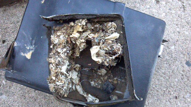

I picked up this truck last year in May. I noticed when the blower was on high there was little to no air flow coming out the vents. I figured since its coming up on winter i better get this solved.
I checked the blower cage to make sure it was turning, it is. Had to be a restriction in the dash so i pulled the blower motor housing out an the Evap core housing out and the Evap core was completely plugged by a mouse nest. I simply removed the Evap core, cleaned out the box an reinstalled everything.
I know have air flow out the vents..

A pic of the core itself.

My pick up has 205k on it.. i know it sat for a couple years due to the frame being rusted in half behind the cab. Frame has been redone an i've been driving it from time to time an fixing issues along the way as $$ allows. After removing all the crud from the evap core an the core itself. The air flow from the vents is great now. Had no problems heating the cab up last night while i was out driving around testing, even had to turn the heat down. Where as last year it would be on high the entire 20 minute drive to work an there was very little heat coming out anywhere,an the windshield would barely stay defogged/defrosted.
