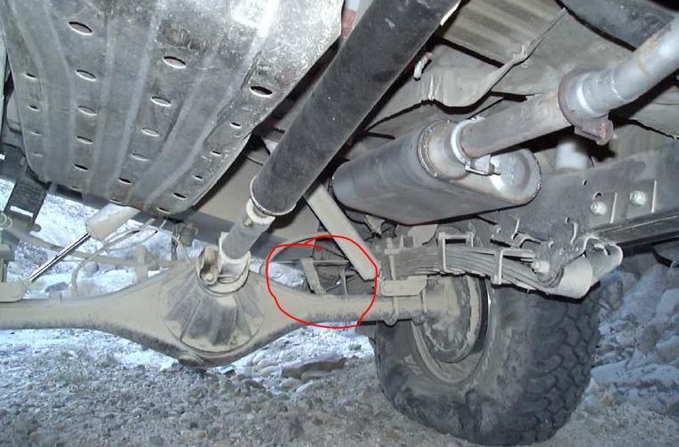

I don't have my 4runner here at work but it appears your bracket might be bent, here is a pic I found online that looks to have much more rise than yours has.

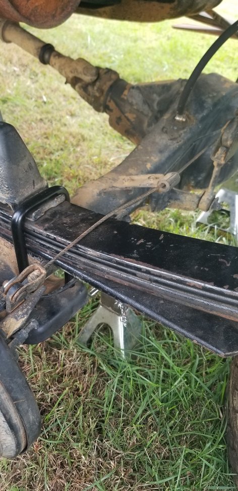

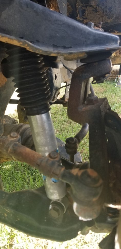

I also found measurements of stock on 4crawler. He stated top of 15" wheel to highest point on fender in the front is 13.5"-14" i am currently sitting at 18" up front.
Front side
Front
Setup im installing. I was able to bend the brake cable tab and now have 1/8\" of clearance from springs
Setup that was on when i bought truck

Here are some pics.

yeah your spindles are not factory and its hard to tell on my phone from the picture but it looks like theres a piece of bracket between your frame and lower cross member which would amount to the added lift you have up front.
Yea sorry didnt realize the picture of the front was so crappy till im at work already. That is what i was thinking that the crossmember is dropped to accommodate the lift from spindles. I didnt think those were stock spindles but couldnt confirm.
