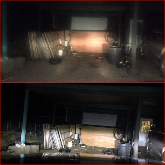

So I purchased Some CREE LED headlights and an H4 conversion harness off of amazon and I installed everything last night. Overall I am pretty satisfied with both the quality of the lights in terms of beam and quality and also the H4 Harness. The pictures don't really do the light upgrade justice, it is way more noticeable on an open road the only thing I'd like to be different is the lens' to be glass . The cutoff is great as these are DOT approved lights. I'd say Low beam I can see clearly to 60 yards and High beams on a flat road is 100+ with very good side coverage also for spotting the deers and what nots. Only thing they don't show in the Video is that I had to loosed the upper radiator support mounts to get the Harness tucked up underneath. I think I took my first low beam halogen picture at 826pm and I was sitting on my couch at 940pm so its very straight forward.
Video I followed: 1st gen 4runner LED headlights
-Amazon item 4333003571- 5''x7'' 6''x7'' High Low Beam Led Headlights for Jeep Wrangler YJ Cherokee XJ H6054 H5054 H6054LL 69822 6052 6053 with Angel Eyes DRL (Black 105w Osram Chips)
Headlight Link Headlight Link
Amazon Item- KAJE-0003- 1Set 2 Headlight Harness H4 Headlight Relay Harness H6054 H4 Relay Harness Toyota Pickup Headlights H4 Wiring Harness Headlight Relay Kit For Toyota 95-97 Tacoma 88-95 Pickup Fix Dual Ground Problem
H4 Conversion Harness link H4 Conversion Harness link
HALOGEN POWER DRAW
LED POWER DRAW
LOW BEAM CAPARISON HALOGEN LED
HIGH BEAM COMPARISON

I'm with Co_94_CU on this, but I'm not picking on the OP in particular here. The OEM manufacturers are guilty as well. The problem with sharp cutoff low beam headlights is that they work great if the following two assumptions are true. 1) all roads are flat. and 2) all vehicles are the same height. Since, of course, neither of these assumptions are true, any sharp-cutoff light is going to fairly frequently put full intensity into an oncoming driver's eyes. This is equally as true of late model OEM lights as it is of aftermarket lights. The DOT has been totally asleep at the switch on regulating these things.
On your low-beam LED picture in the first post, notice how brightly those tables on the left, and the area past the lamp post, are lit compared to the halogens. That's the light that's going to hit the oncoming driver right in the eyes if you meet coming over a hill, or if he's in a low-slung sports car.
Halogen or sealed beams have a smooth transition from the intense center to the outside of the beam and are generally much more diffuse, making them much less objectionable to oncoming drivers. Granted, they don't light the way as well, but at least oncoming drivers can see.
Do anything you want with your high beams, but skip the sharp cutoff lows, please.
We can talk about all the variables with vehicles height and roads all day but the fact of the matter is that a properly adjusted head light, that being set at 32-36" at 25' with very little hot spot/overlap, with a fresnal lense will rarely impact other drivers and that goes for anything whether it be LED, HID, Halogen.
The area to the left and right are lit up more because the headlight itself has better light coverage and a wider beam it has no impact on what the oncoming driver sees because the cutoff is the same through the whole headlight. I spent about 40 min getting them adjusted right. I think a lot of peoples anger and concerns regarding headlights comes from those that are not adjusted properly. that being said as a note: Anytime you mess with your suspension or anything that might require you to remove your headlight you should ALWAYS check and adjust them. Its just like getting an alignment when you change tires or put new suspension components in.
