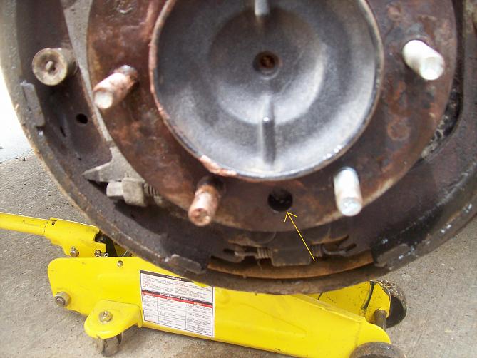

Past couple weeks i've noticed a small amount of fluid running down the passenger rear tire which appears to be comming from around the studs. First I checked my brake fluid and that was good. I started taking her apart an believe its comming from the hole in the picture (not sure if this is possible for anything to come from here...) or the seal between the axle and tire/break assembly. Any ideas about this?

It can only be one of two things. Brake fluid from wheel cylinder or gear oil for bad axle seal

x2 on axle seal.

My vote is gear oil...

Sounds like its gear oil....Anyone know what size the bolt is too drain and fill the rear diff. is? I don't have anything that big so gonna have to buy one.

definately gear oil and your inner axle seal is shot... hear tell they are a major PITA to replace... good luck with this one...

Better check the diff level soon to make sure you're not too low.

yea im with the majority here, axle seal gone bad usually caused by the wheel bearing going bad also.

yeppers; I was going to suggest that bearing while you're in there as well; you have to have it removed with a press anyhow to get to the outter seal

use a 6point socket to, if you want to make sure its diff fluid. just smell it.
