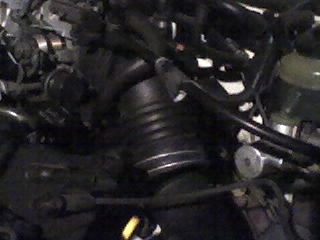

Old Sep 25, 2006 | 12:06 AM
doc76239's Avatar
Joined: Mar 2006
Posts: 147
From: MArysville, WA
Hmm
Well I removed all the intake stuff and breather tubes, and am trying to figure out what factory stuff needs to be reused.

Old Sep 25, 2006 | 02:34 AM
freshman's Avatar
Joined: Sep 2004
Posts: 293
the first factory rubber air intake from the trottle body needs to be reused. Do not tighten the clamps (fctory rubber tube to K&N tube) and not until you pt it in place to be able to play and find the right angle during installation.

k, that makes sense. I tried that and I can't figure out the angle of the plastic K&N elbow. Is it turned to the left or more up?

Old Sep 26, 2006 | 05:41 PM
freshman's Avatar
Joined: Sep 2004
Posts: 293
lots of playing there. just make sure to clear 1 plug wire that will cross on top of the tubing to connect to the igniter coil.
Old Sep 26, 2006 | 05:44 PM
doc76239's Avatar
Joined: Mar 2006
Posts: 147
Bumpin yota you rule, That is exactly what I needed. One ? the black box at the front side of the filter element is still attached?
Old Sep 26, 2006 | 05:51 PM
Bumpin' Yota's Avatar
Joined: Feb 2003
Posts: 3,689
From: Sarasota, FL
yes and its hose goes to the backside of the big round filterplate. Also there should be several mounting brakets on there too...but i dont have pics
