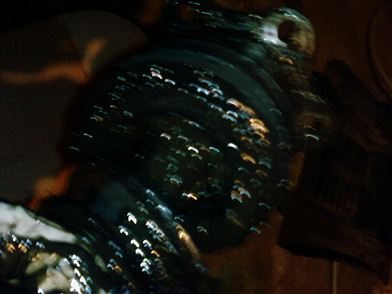

Like the title says I just replaced a bad cv axle, got done yesterday. Its still making the noise. Its like a "pop, pop, poop" when I am turning hard either way. haha, i thought for sure it was the bad axle (look at the pic)
Could this be the brake caliper bolt hitting the control arm?

sorry but your picture quality leaves a bit to be desired...try to hold the camera steady and clean the lense

Clunk on sharp turn....really?.....I bet its your turn stops. Throw some grease on there and see if it still does it.
Oc..after a few beers, the picture is clear as a bell!

X2 on RE-RE, I bet its the turn stops as well. Climb down under and grease those and I would bet your problem goes away.
As for the bers, yis it wrks grat that pictre is now vary claer.

Thats what it was! thanks guys, i threw some wheel bearing grease on there and 90 % of the noise went away. I might have to fab up some rubber things to go on there since I hate the noise so much and grease isnt gonna last long.
