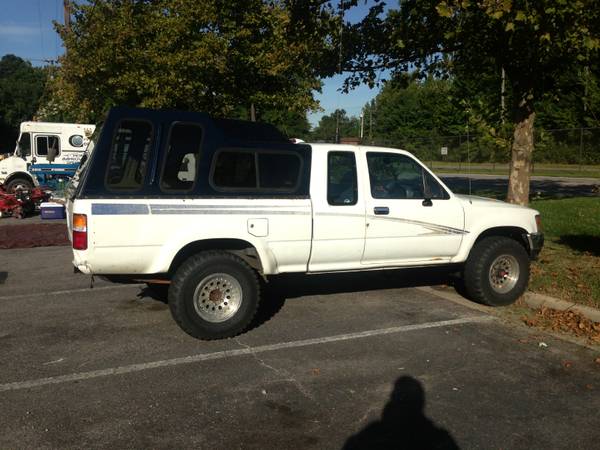

Here are some pics.

Get rid of the fugly topper and put a decent rear bumper on there. I think you did alright.

Yes. The camper shell is going as soon as it stops raining. Ok awesome. Thanks guys, that makes me feel a little better. I have had several 22re but never the v6. Always heard they had problems. but seems to be a great running truck to me. Interior needs some cleaning but is in overall good shape too.
