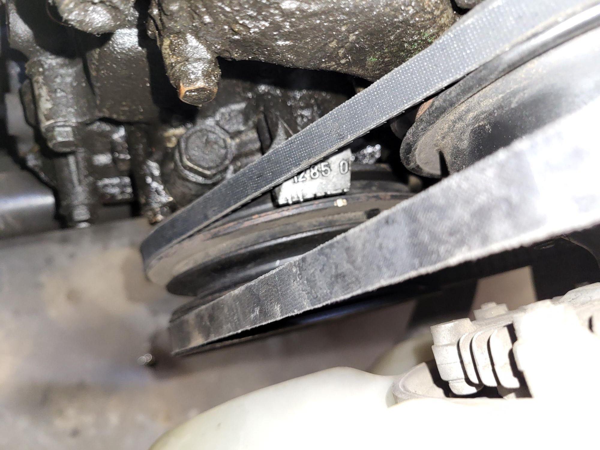

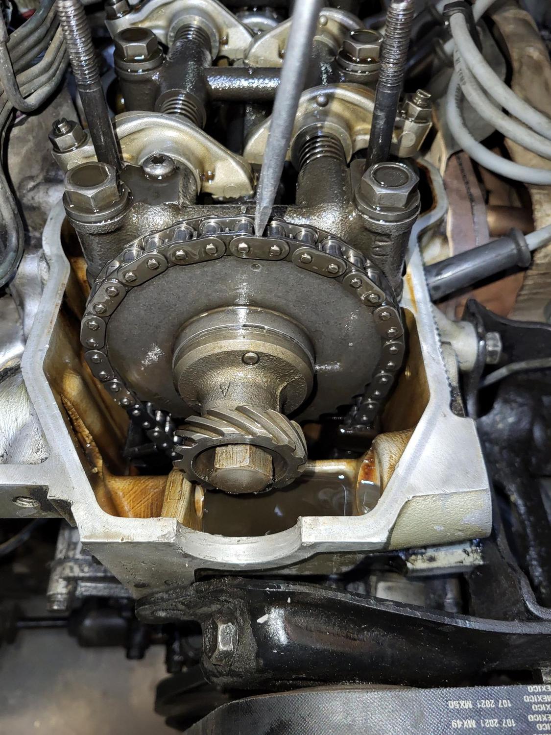

Thanks Keycw... I don't have a way to check fuel pressure but I did an odd check by undoing the cold start pressure line and it is spraying VERY hard. Is it possible for the cam gear to be one tooth off and the car still run?
The way I replaced the valve steam seals and the head gasket (yes... new gasket) was to simply wire the timing chain up and reset the cam sprocket. When eying it, crank at 0 degrees, rotor pointing to #1 and the cam sprocket pointing straight up... well almost straight up. maybe a half-tooth to the right.
The block and chain has about 30k miles on it so I didn't change that. The chain guides look good and are not damaged.
It sure looks correct to me but I am a v8 guy... so what the hell do I know about Toyota 22RE's?

Thanks Guys... I have a great timing gun and the timing advances to about 18-20* when it starts. I am thinking I may have the cam sprocket off by one tooth. Is that possible? Seems that would advance the timing, but I would have thought it would run really rough. Yet... it doesn't. No rough idle... it just stalls.

So, a little advise. I adjusted the timing by moving the chain one tooth over. When the cam gear is just past straight up, the crank timing is between 12* and 13*.
But when the crank is at 0* the cam seems way off.

I think it was likely correct before you moved the sprocket.
Most 22r engines show the dot near as much to the left as your first image shows it to the right. when the crank keyway is at vertical.
Your harmonic balancer may have slipped it's rubber so that it is not accurately indicating TDC??

Yea... I thought as much. Thanks for the directional help. I will put it back to how it was. With the crank at 0*, the cam sits just to the right of the vertical. It must be a vacuum leak then.
