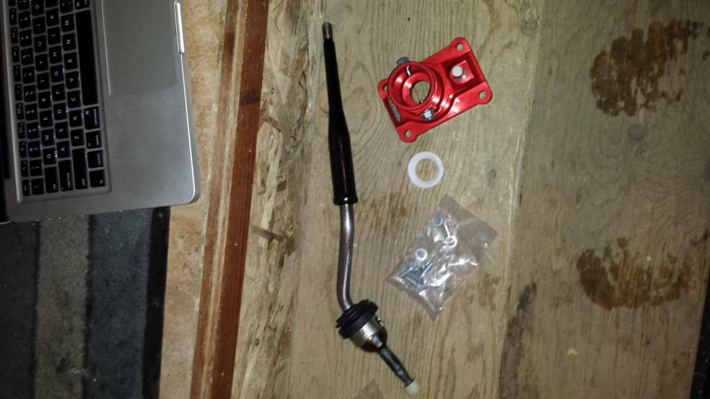

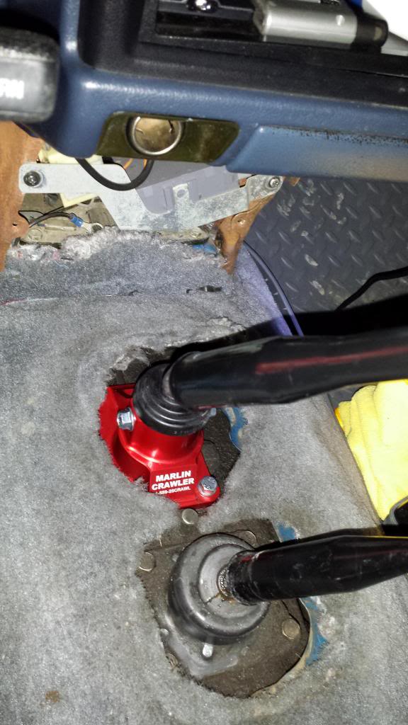

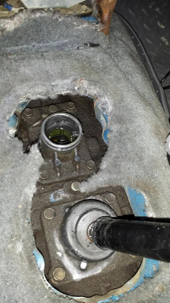

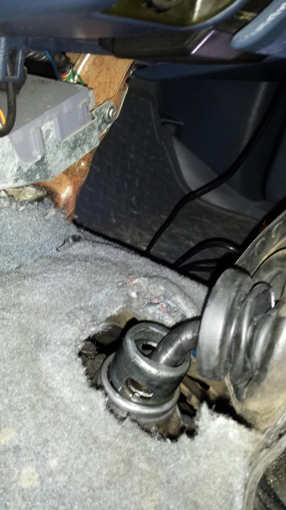

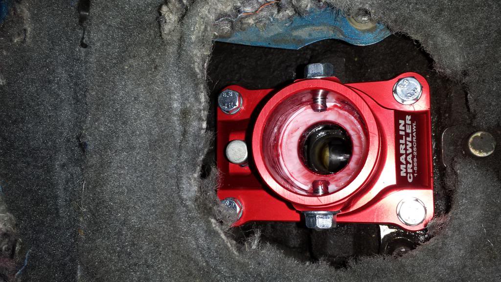

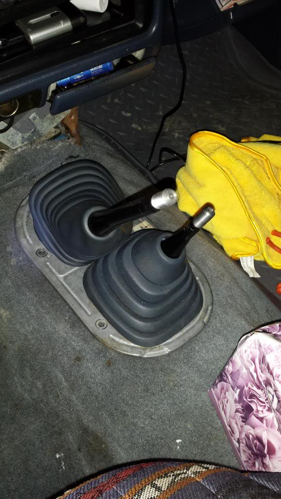

Marlin Crawler Short throw Shifter kit
One of the typical comments you hear about our trucks is the sloppy shifters, more so the older they get, and my wife especially, her Subaru's shifter is very close patterned. I waited a bit before this kit came out, Blue and others here have said it is a huge difference so I got one yesterday and installed it. Really high quality parts, and one of the biggest differences that sets it above other kits is that it actually shortens the shift pattern with modified shifter/socket and modified tunnel combined with with their already proven shift seat. The other kits use a spacer which only changes the shift angle to achieve a shorter pattern. Shipping was relatively quick, although I had to wait until stock was in when I wanted one, guess they are selling well. There is a core charge of $100 which makes this kit pretty decent at $179 after core exchange. They have the manual for this online which is very easy to follow.
Pics of kit:

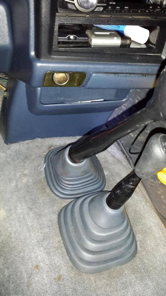

shift knobs off, shifter boot base ready to come off:
lower shift boots coming off:

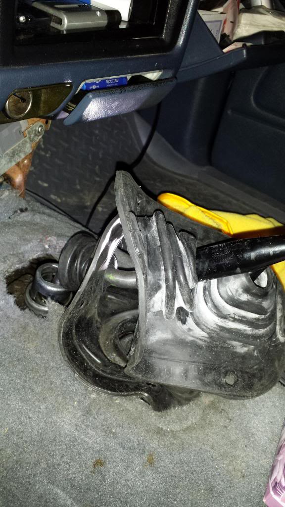

Boots off, shift retainer comes off easily, push down and twist:

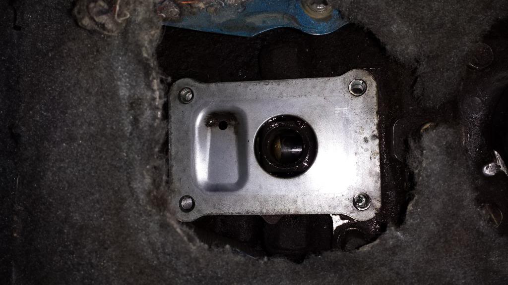

Shift tunnel, 4 12 mm bolts:
Oil splash cleaned off, ready for Marlin shift tunnel:

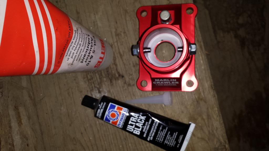

Marlin tunnel with shift seat, ready for silicone on base:
Shift tunnel installed, torqued to 12 ft lbs:

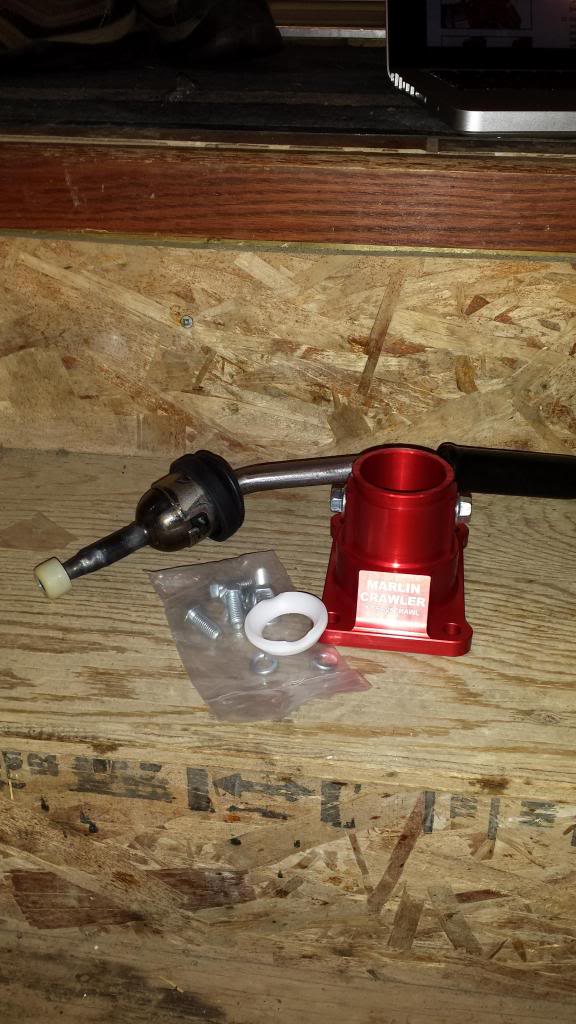

Side by side comparison of shifters, Marlin shifter with modified shift socket:
Shifter installed, new transmission boot (included) installed:
Back together:
Went for a test drive and it is TIGHT. It shifts nice and the pattern is close, what a great kit, really glad I bought it. I'll see if my wife notices.
