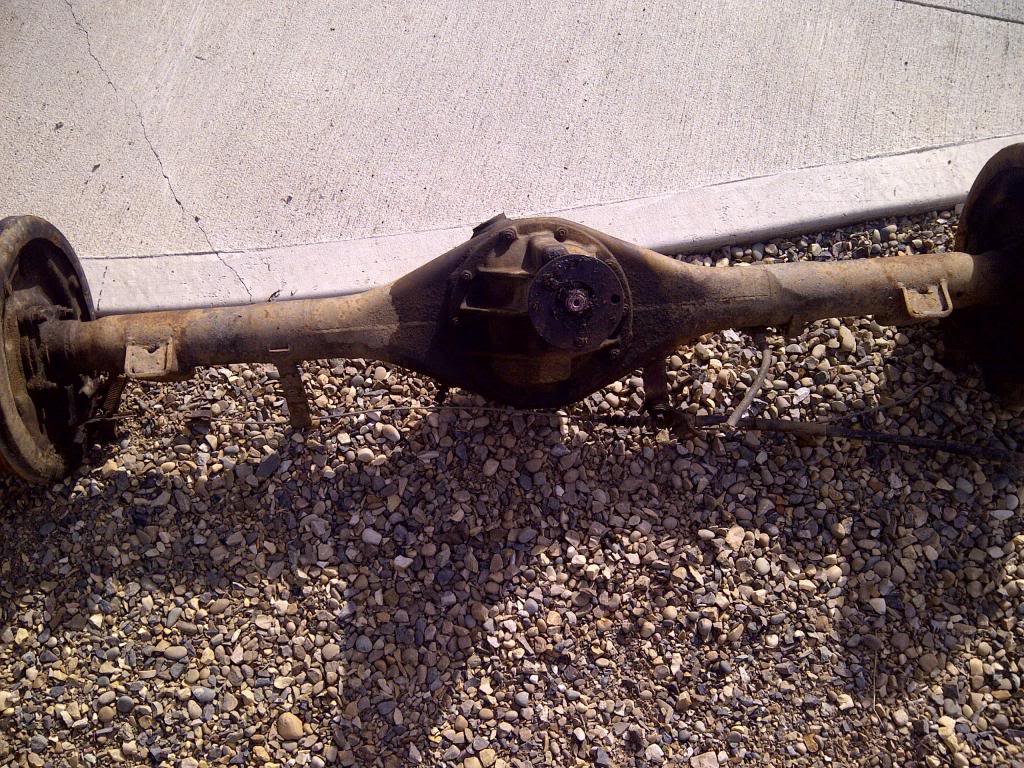

I noticed the rear drivers seal leaking, and there was a nice whine coming from the rear drivers axle. I found a donor axle in town for $150 so I bought it, tore my rear end apart and found a seized bearing. I used an the axle out of the donor rear-end, changed the seal and it's been quiet as a church mouse ever since. Donor rear end:

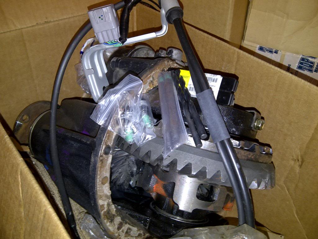

After that I found an e-locker (4:56), bought a harness, studs/bolts and switch for it. Here's the rear 3rd, need to clean the surface rust but it has lots of meat:Name:  elock_zps1c1c8c53.jpg

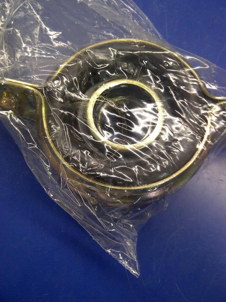

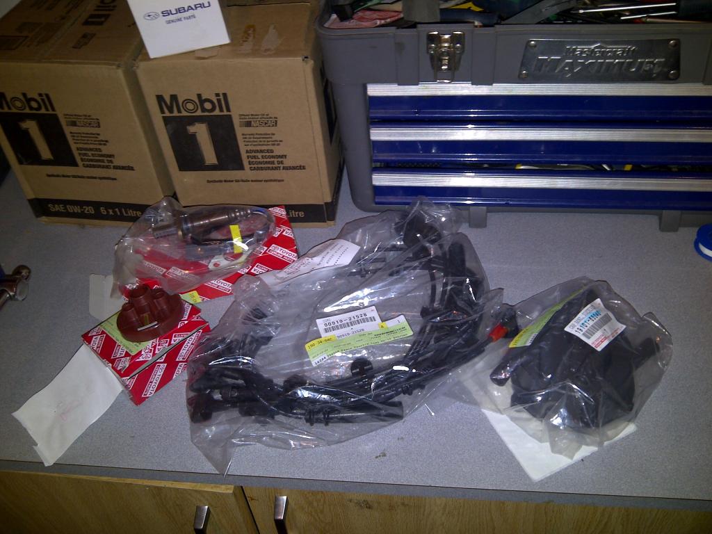

Next came cap, rotor, wires and 02 sensor and centre bearing, have to wait to install 02 sensor, I broke one of the flange studs off:
Size:  110.8 KBName:  centrebearing_zps68ba4c25.jpg

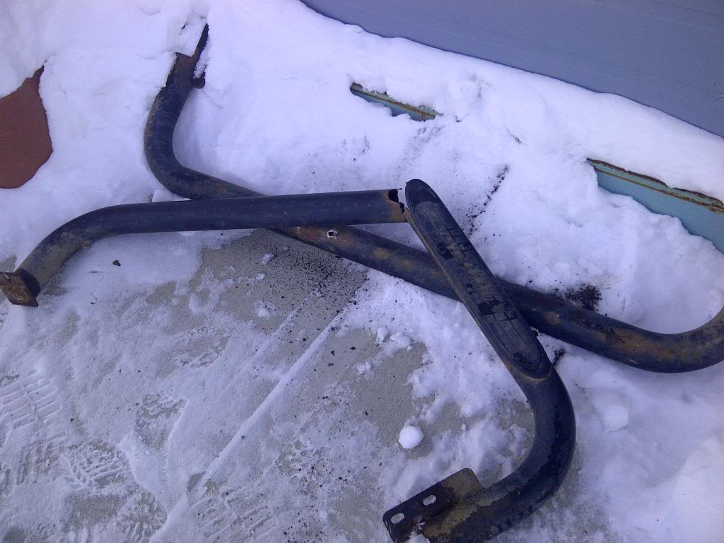

I knew the smittybilts sidesteps were in bad shape, so I took them off, they were rusted right out:Name:  smittysidesteps_zps3a8931d2.jpg

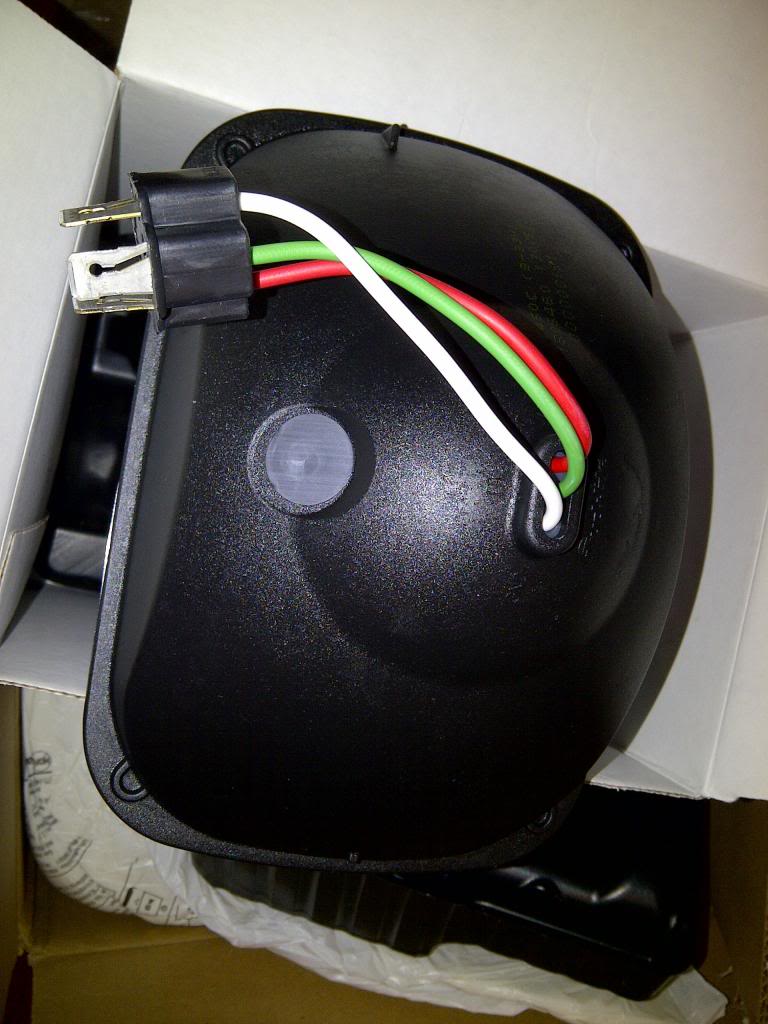

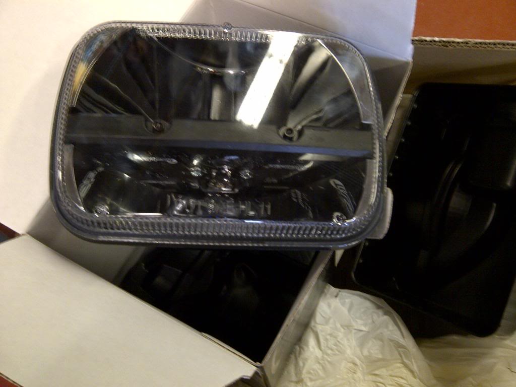

Got a nice package in the mail today:
Size:  57.0 KBName:  liteboxed_zpsdfc602c8.jpg
Size:  118.3 KBName:  trucklites_zpsdc6214e1.jpg
Size:  65.9 KBName:  93lightbody_zpsb41a20d0.jpg

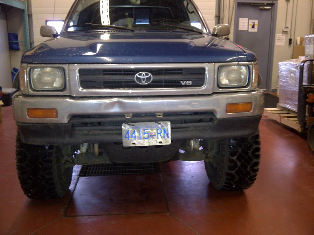

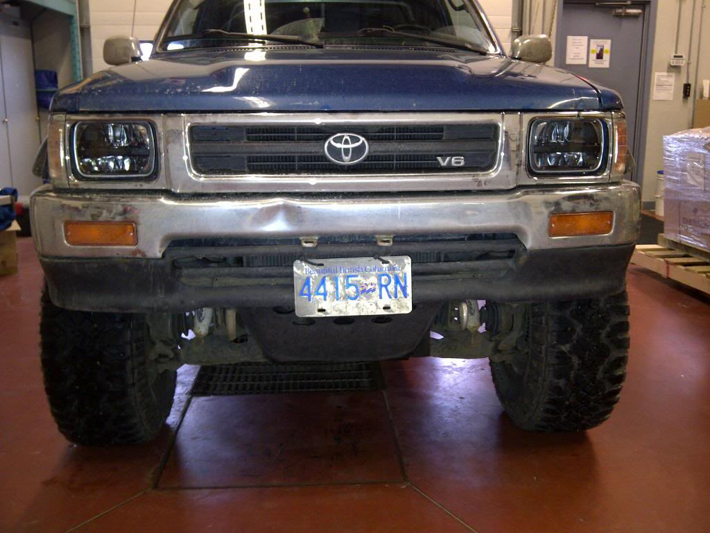

before:Name:  stocklights_zps347bd34d.jpg

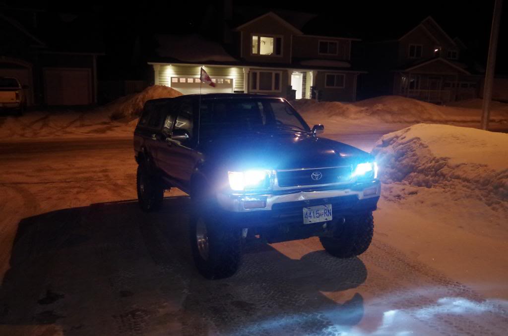

After:Name:  newlightsoff_zps9fcda1fa.jpg
Size:  95.7 KBName:  sideoff_zps349ddecb.jpg
lowbeams:Name:  lowbeams_zpsdaa8a1a1.jpg
highbeams:Name:  newlightshibeam_zps54c0cf04.jpg
These took 13 minutes to install, they are like night and day compared to my stock glass headlights. Are they as good as HID or H4's? No idea and I don't really care - no re-doing my headlight harness,no ballast, housing, lightbulbs etc. And these are very well built, military grade aluminum housing, and DOT/SAE approved. Shipped with tax to my door, $461.10. I'll get some road pics and post this weekend.

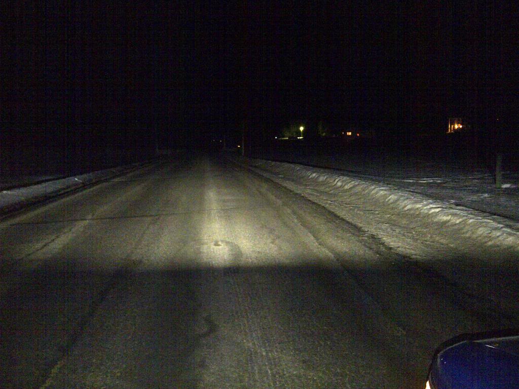

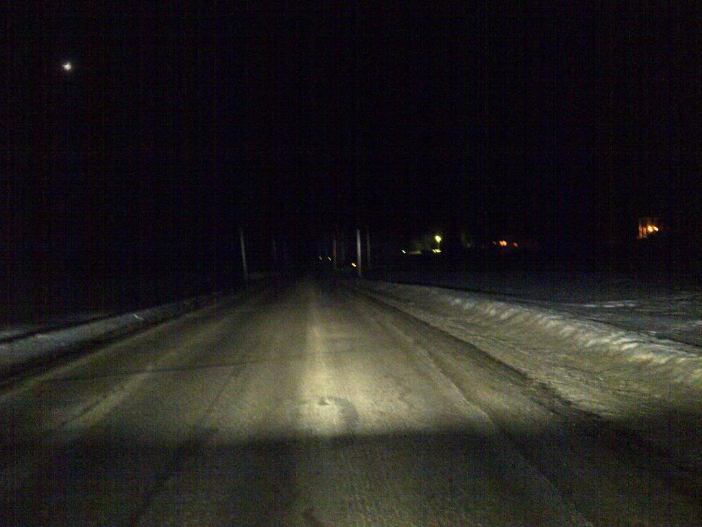

some pics tonight:
low beam:Name:  lowbeam_zps923a5e9b.jpg
Hi beam:Name:  hibeam_zps41121aff.jpg
These are cell phone pics, they don't do justice to the nice white light and the low-beam and high beam cut-offs; they are very sharp. I drove on they highway for 45 minutes, no one flashed me. I hit fog down at my turn around point, I really like how nice the pattern was.

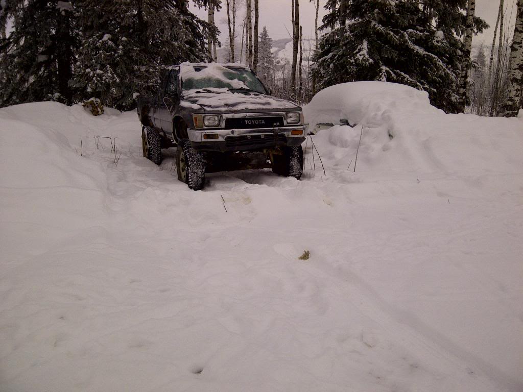

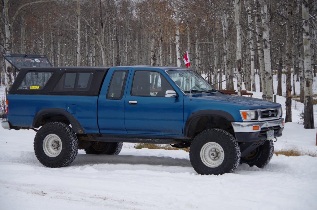

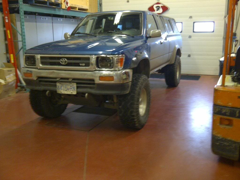

Thanks! Here's a couple of pics from this winter:

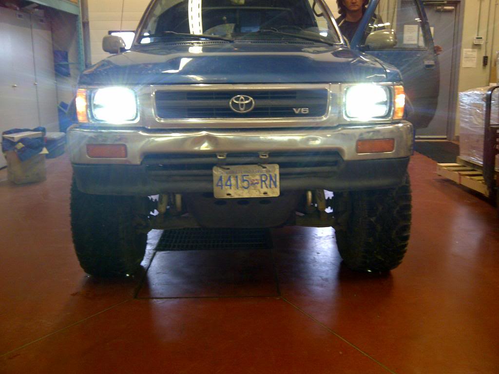

One from tonight's road test after borrowing a headlight alignment box from a local trucking outfit:
