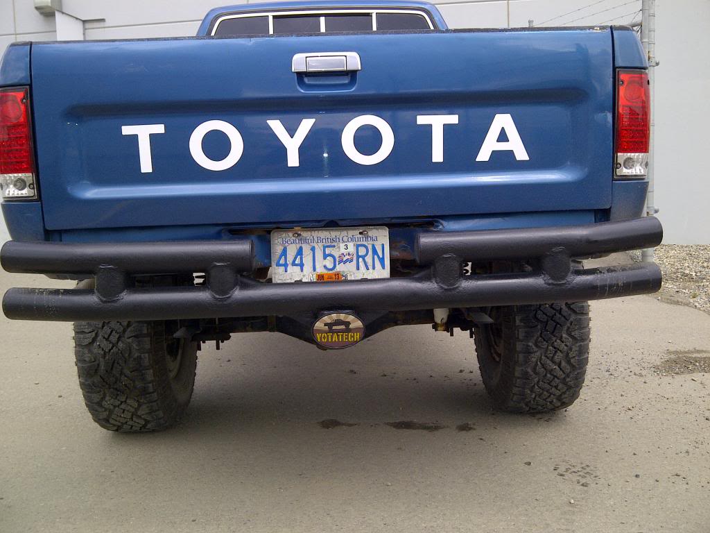

Old May 31, 2013 | 03:22 PM
  #47
RSR's Avatar
RSR
Joined: Mar 2013
Posts: 1,047
From: Central TX
Johnny,
Where'd you get the Toyota tailgate sticker/lettering from? Looks great.

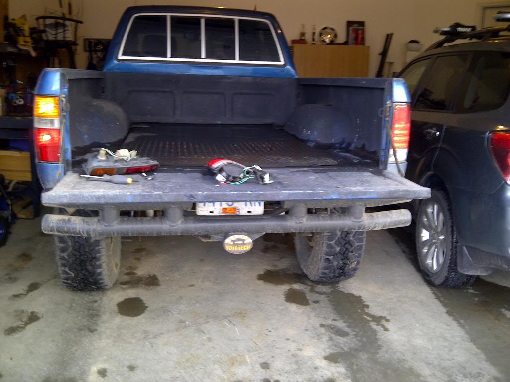

Also, any chance you can mount one of your original rear factory tail lights and show us the brake, reverse, and turn signals for comparison? They look good but would really appreciate a comparison shot. Thanks!
Old May 31, 2013 | 05:34 PM
  #48
JohnnyCanuck's Avatar
Joined: Feb 2012
Posts: 699
From: Vancouver Island
Originally Posted by RSR
Johnny,
The tailgate sticker is from jamesdeancreations.com. As for the comparison between taillights, I'm putting new rear shackles on so once I'm done that I'll pop the oem tail light in and take some pics for you.

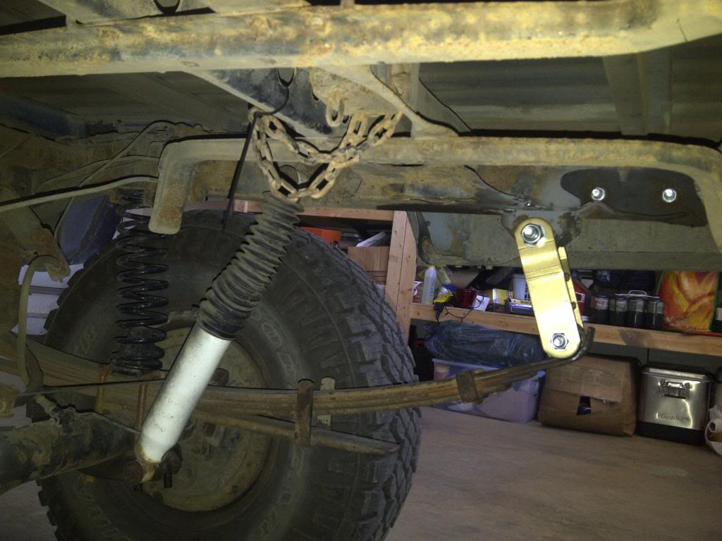

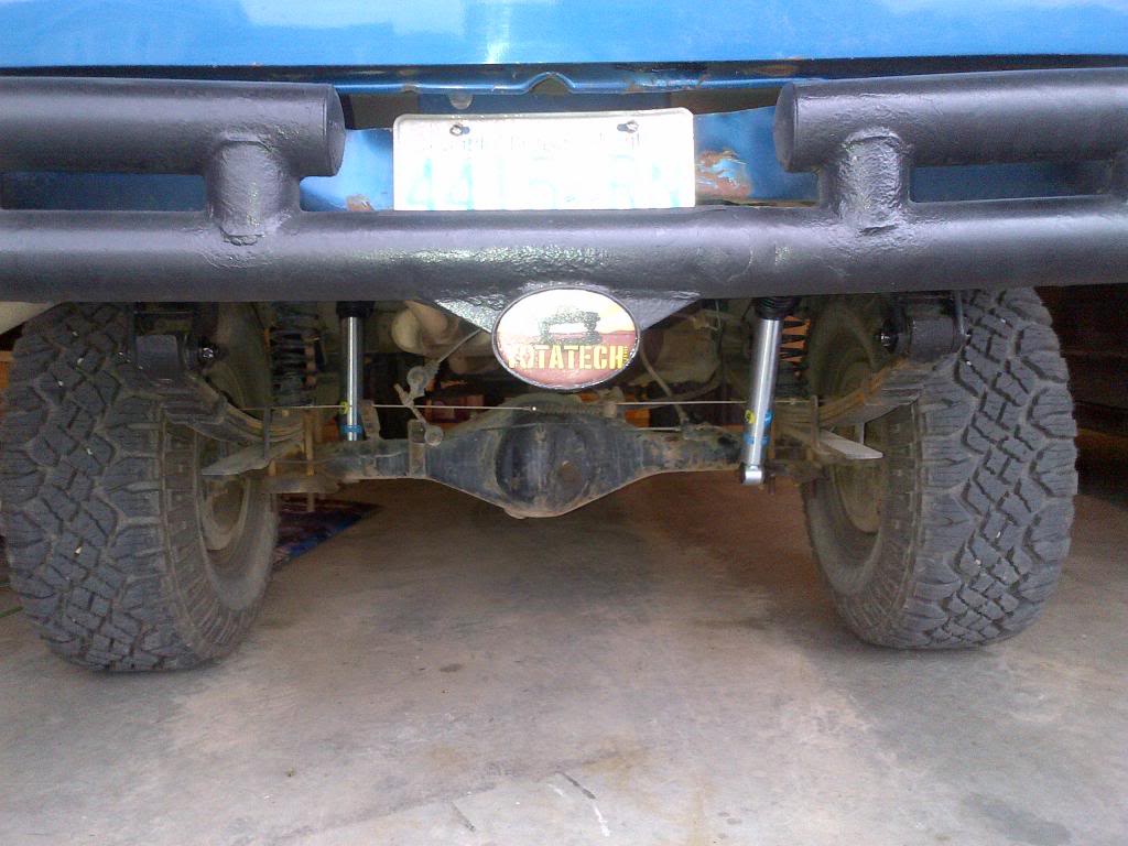

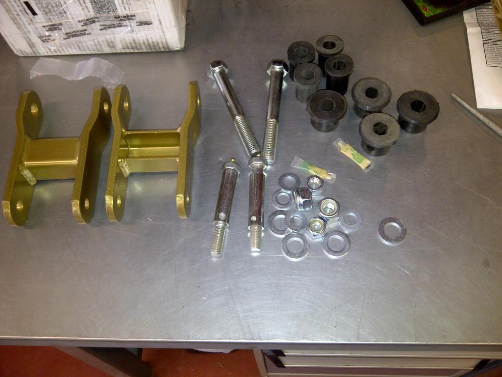

Got my new rear greasable shackles on, what a pita to get those top shackle bolts out. Ordered some Bilstein 5100's, should be about it for now on the suspension.:
Kit:
installed:
Old Jun 1, 2013 | 05:17 PM
  #51
bone collector's Avatar
Joined: Nov 2009
Posts: 2,025
Likes: 40
From: Northen Indiana
where did you get the shackles from? are they stock length or longer? notice any difference in ride quality?
Old Jun 1, 2013 | 06:45 PM
  #52
Joined: Feb 2012
Posts: 699
They were 2.5" longer than stock from Suspension Connection, about an 1" lift. My old shackles were seized on both sides, the ride is considerably better and quieter. Once I get the bilstein shocks installed it will be about as good as it gets, especially since I dumped the 3" lift blocks for the zuk mod.

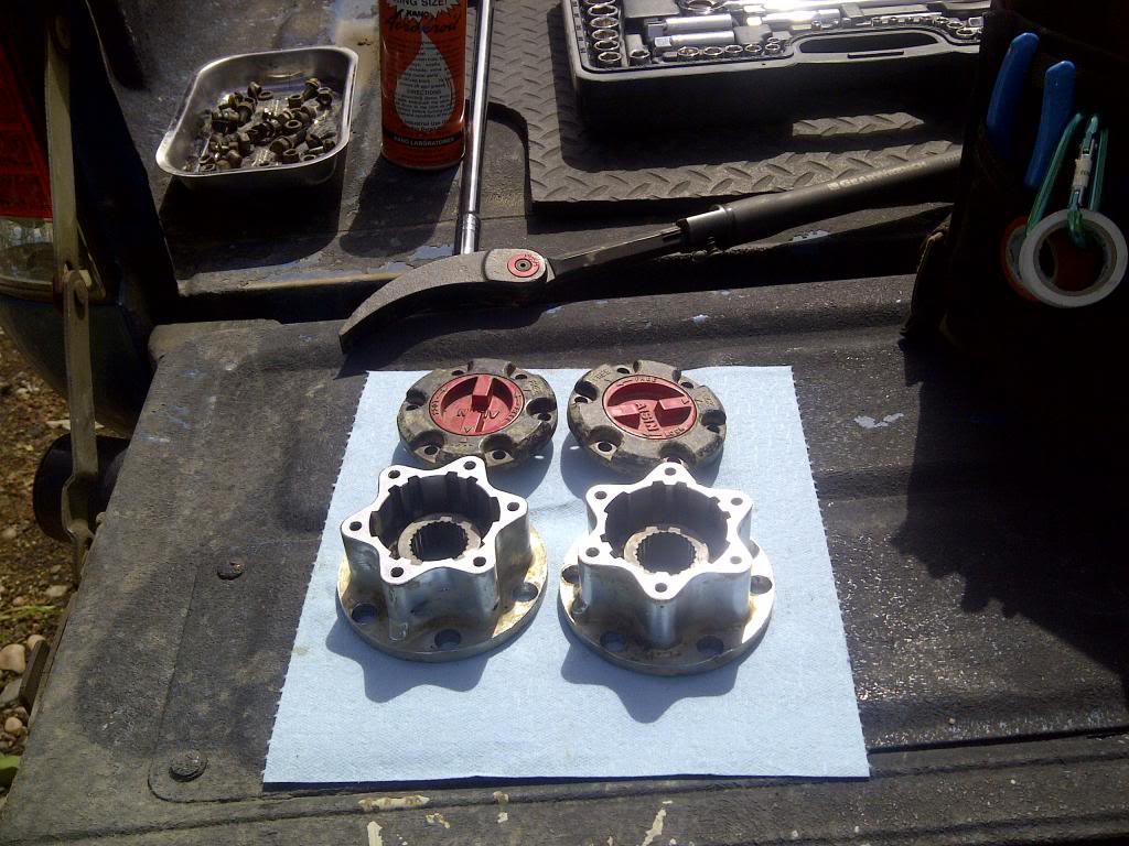

took the locking hubs off my parts truck:

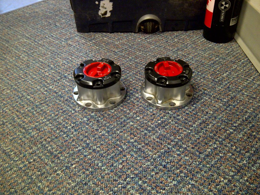

Rebuilt them, painted them, just waiting for gaskets to show up from dealer:

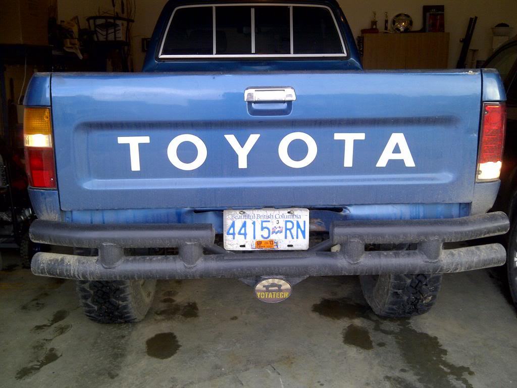

Old Jun 13, 2013 | 06:17 PM
  #55
Joined: Feb 2012
Posts: 699
Johnny,

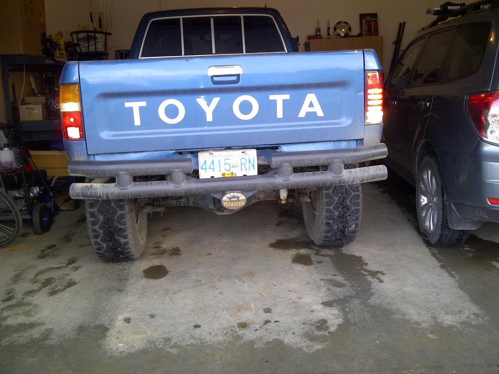

these pics aren't the best, but I have to say that during the day, the oem lights are just as visible.
brakelights:
reverse lights:
left signal:
tailights:

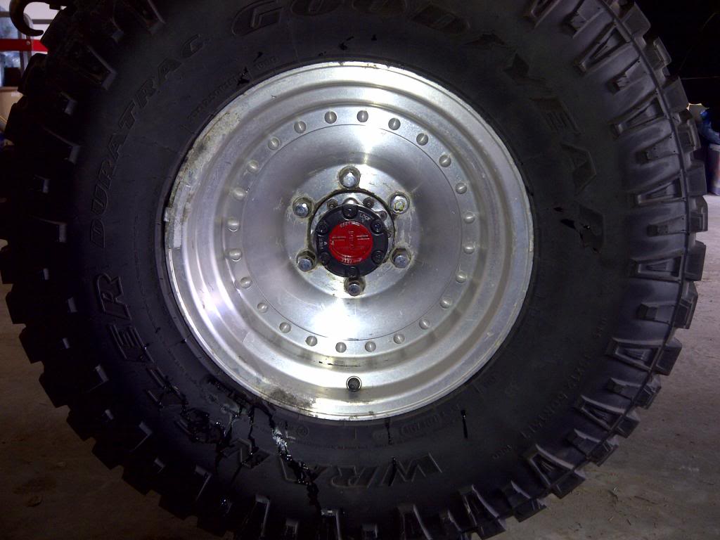

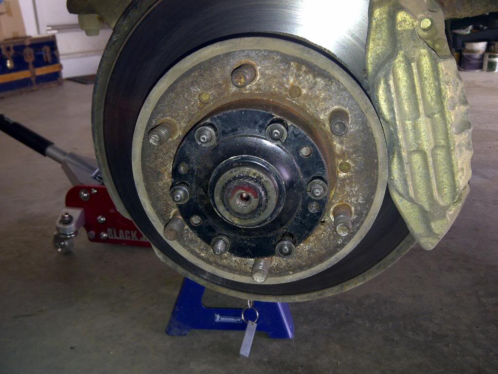

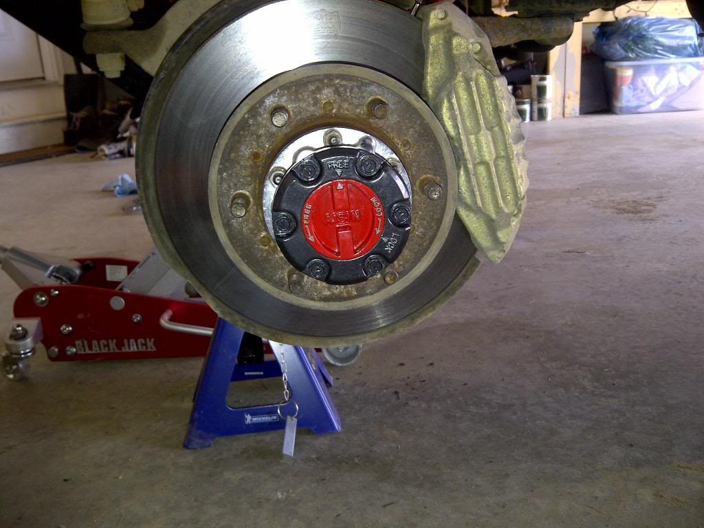

ADD --> locking hubs
My gaskets came in for the locking hubs I rebuilt so I got them in, took me just over an hour and a half.
Before:
Tire off/ADD hub:
Dustcap/bolt off:
Hub nuts/Cone washers off:

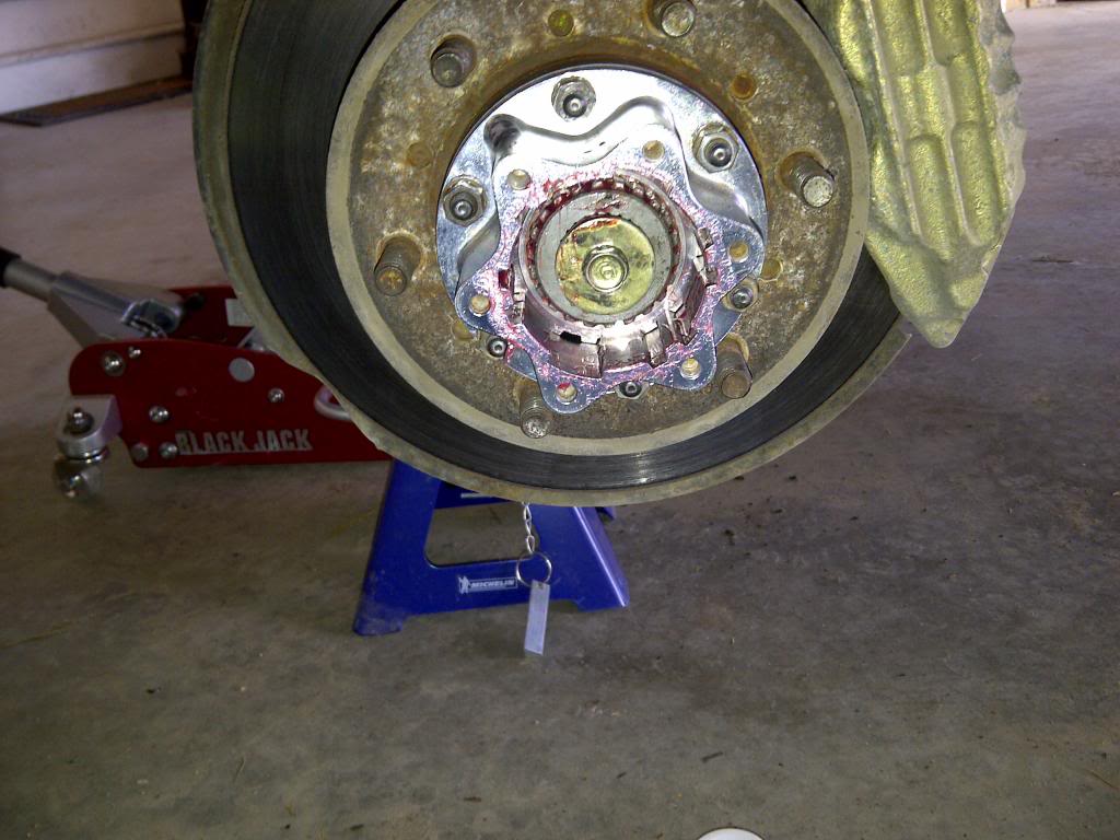

ADD hub off:
Rebuild lockers, gaskets and painted dial bolts:
Hub base on:
Dial on:
Tire back on:
Back after test drive, everything works great!:
It seems quieter although it's probably in my head, to have my cv joints not spinning for most of the year is a bonus. Thanks Yotatech again for the various threads I used to rebuild the hubs and change these out.

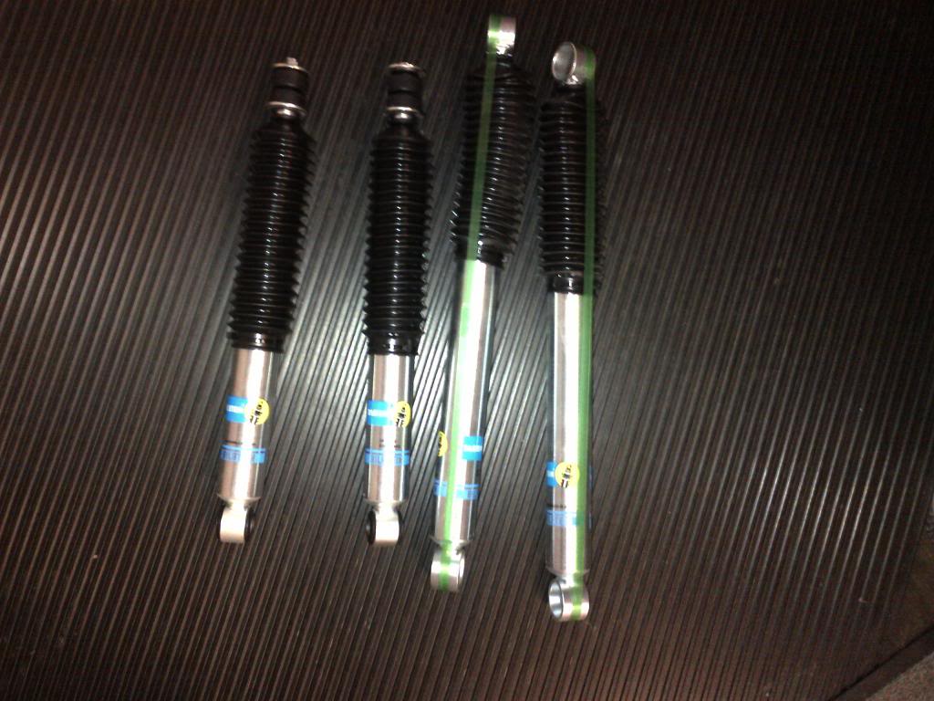

Bilstein 5100's came in:
front:
back:
World of difference from my old shocks.
