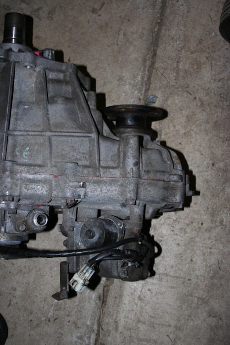

Hi there toyota world. I just bought this new JDM engine and transmission. it is going in my 91 runner, but after looking at the transfer case, I notice the JDM one looks way different... They are both 3vze engines, and the transmissions look identical, but what the ??? the transfer cases are way different!! the new one has some extra electronic crap on it, and I have no idea what it is.
I have scowered the web for a picture of a transfer case that looks like this JDM one but I cant find any. Please let me know if I will be able to install this in my 4runner, or if you know what the difference is!
Heres the new JDM one with the extra electronic stuff:
heres my old one:
any insight will be greatly appreciated!

It would be awesome if I could use the new transfer case, as the JDM engine did come with the JDM ecu...
I cant find a pic of a transfer case like this ANYWHERE!!!
nobody knows what the electronic unit is? I'm thinking it may be some sort of AWD mechanism...

Does it have three shift positions, ie 2h 4h 4l. I wonder if it's a full time 4wd transfer, it should only have two shift positions, 4h 4l if it was. That could be a differential lock? I really have no idea though.
Old Jan 10, 2013 | 04:35 PM
big1000's Avatar
Joined: Dec 2012
Posts: 67
From: Morro Bay CA
yes it has three shift positions, but its all in one line. front, middle, and back if you know what I mean. my old t-case you move the shifter over and to the right for 4L.
I'm thinking this is some sort of electronic solenoid for AWD...

OK so it appears that this unit is an actuator for an ADD system. can anyone expand on this? I don't know if I can put it in my truck or not... I guess the 4x4 shift knob had a button on it for the ADD system.. (automatic disconnecting differential)

That is the actuator for the center diff lock. It lockes the transfer case so you get 50% power split front and rear. They only came in the 80 series landcruiser, I think. Reguarless, it was a non option for the USA domestic market. The early years it automatically locked when in 4lo, but starting in 93 or 94 they became switch activated to have it in 4hi as well. Get yourself a switch and run that thing. I know a source for CDL switches if needed, let me know. This is what it looks like
What kind of hubs do you have...ADD or manual?

I don't think that is right...
Did the shifter come with the t-case? If so, is there a button on the side of it?
To me that looks like a shift on the fly VF2 t-case, there would be a button on the shift lever that will kick it in and out of 4wd and the shift lever itself actuates the hi-low.

That is definitely not a Land Cruiser t-case.
Here are pics of a VF2 electric shift t-case we got in from Australia, it looks pretty dang close to what you are asking about.
Check out the shift rail, single motion forward and back. This shifts the hi & low and as mentioned before there is a button on the side of the shifter knob that shifts 2wd to 4wd.

That is definitely it! So will I be able to hook this up and engage it into 4wd? My wiring harness is not set up to do so, and I do not have the shift knob with the button...

The main give-away that is doesn't have a CLD is the single hi-lo shift rail. There is no way to shift 2wd to 4wd except the electric motor on the back of the t-case.
The second give-away is that the actuator on the HF2 Land Cruiser CLD t-case is on the top on of the drop section, not on the back of the case.
The last tell-tale that it isn't CLD is the width at the drop portion. A center diff lock would be down in that portion of the t-case and what is shown is too narrow to contain a center diff lock.
We got our t-case as a package deal that came with a 1KZ-TE diesel engine and another oddity, a A340 auto trans that has the newer Tacoma style LH drop bolt pattern, but it is a RH drop t-case. Both Marlin and Inchworm said they hadn't seen one like that before, but they must exist, we have one. Supposedly the drivetrain came out of a 1993 Toyota, we don't know if it was pick-up or 4Runner for sure, but the evidence we could find, point towards a 4Runner.
