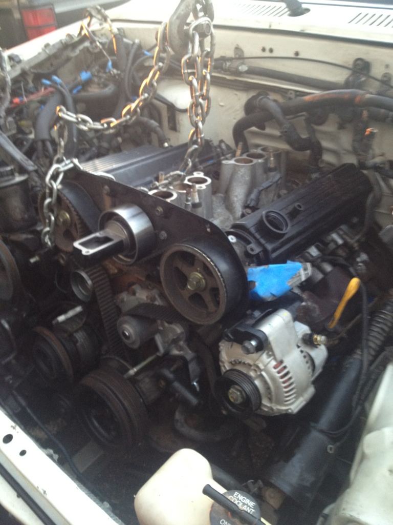

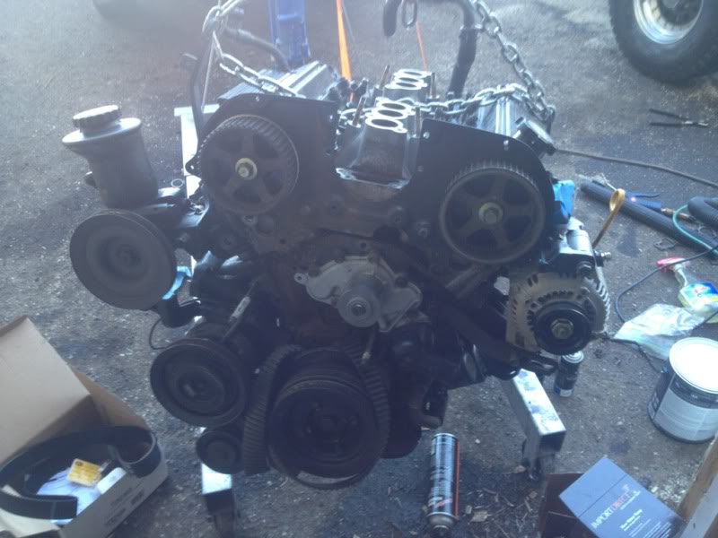

Ok so I got my old engine and tranny out of the 4runner. I disconnected my good t-case and then pulled the engine/tranny as a unit. It wa super easy as I already had the heads pulled from the engine due to a blown head gasket. I'm debating whether to wire in a custom switch ( huh huh custom bro) for the JDM transfer case or use my old one. I've come to the conclusion that the unit back there just fires some sort of pin into the tcase, engaging the 4wd.
Enjoy the pics many more to come.

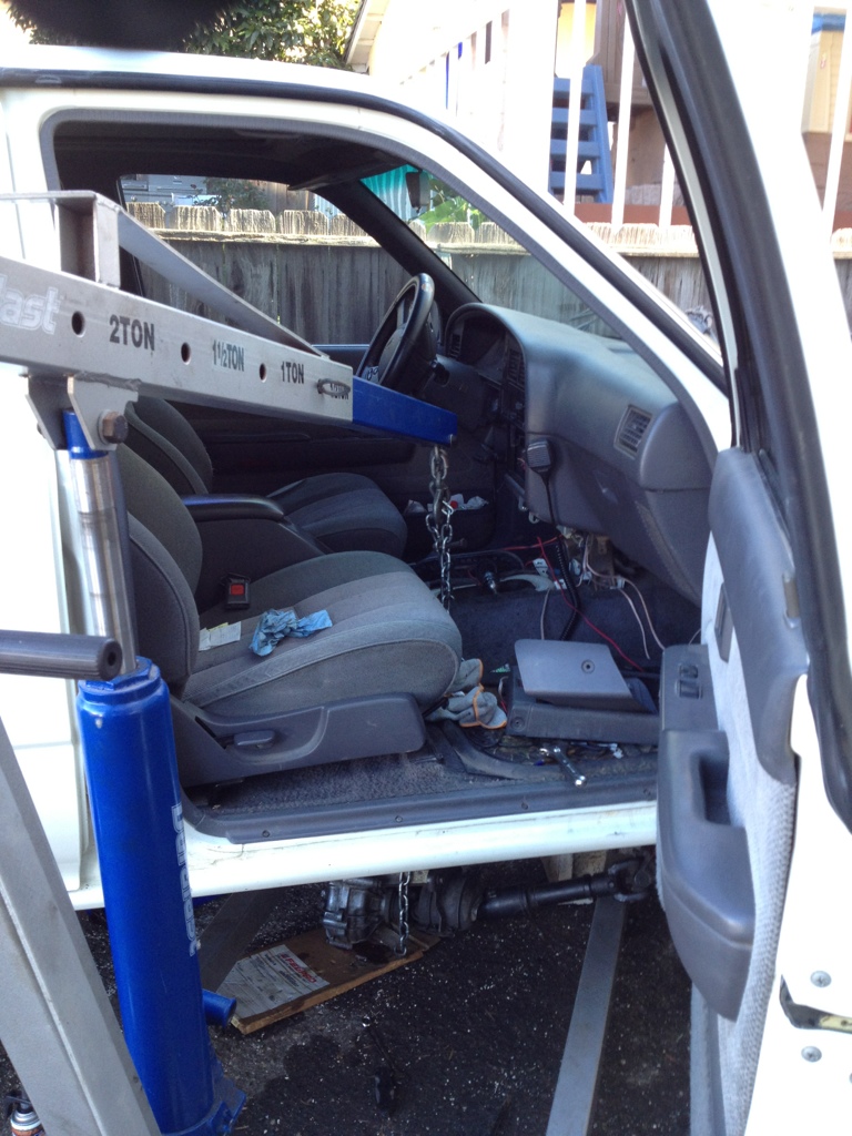

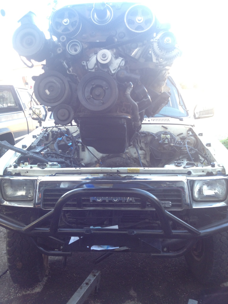

I just went ahead and changed the connector on my old harness to the connector on the starter for my new engine...
I got the engine in yesterday:

All bolted up...

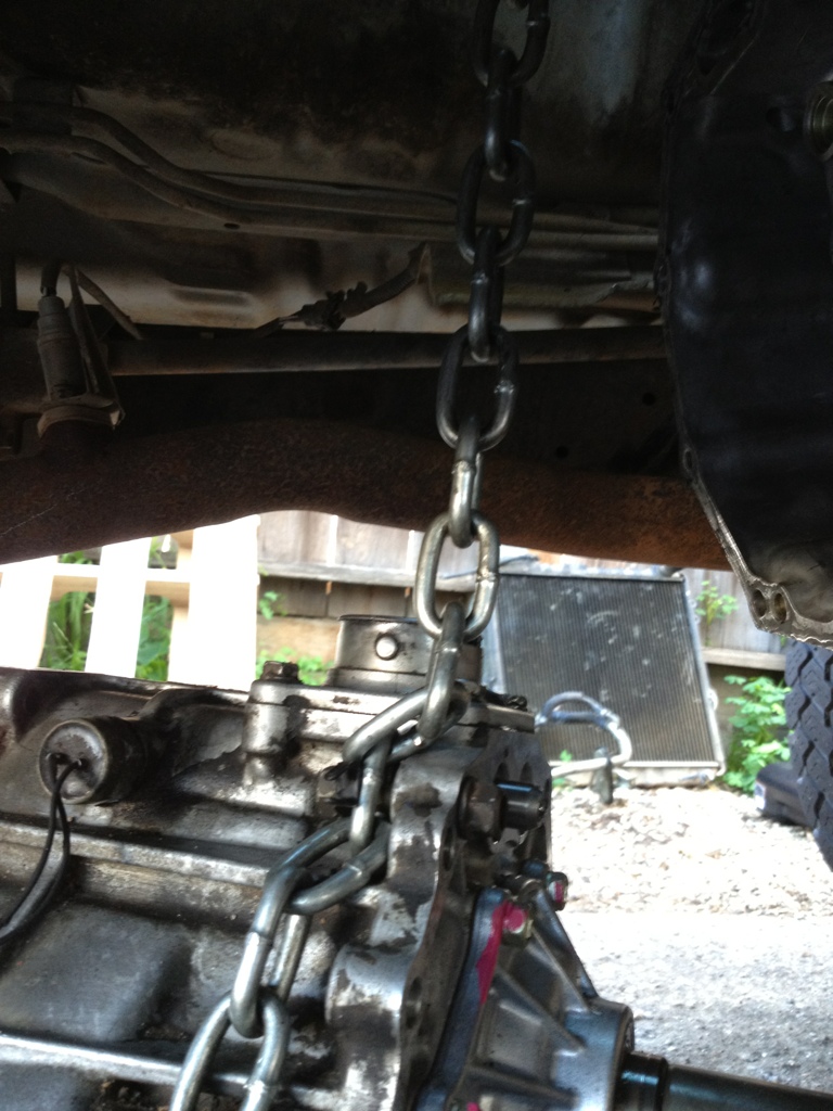

I went to AutoZone and they didn't have a transmission jack so I got smart on installing the transfer case...
