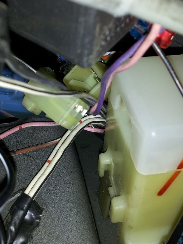

I'm going to pile onto this thread too...my 87 4runner SR5's dome and mirror lights all stopped working.
But, my "key in ignition" buzzer still works.
And, my door lights (when you open a door and the ligth on the inside of the door panel lights up to warn other drivers) work fine.
Bulbs are OK - just won't turn on.
I feel like before it happened I tried plugging in a regular plug into the SR5 service light plug found near the dimmer switch - anyone know if they are related - maybe I shorted something out in my moment of idiocy?
Really want to figure this out but am pretty worthless when it comes to chasing electrical stuff (I do have a multimeter!).
Phil

I have seen pics of the light that warns other drivers that you are out but never seen or worked on one. The only suggestion I could say is to check the plug that comes down the windshield post and eventually comes out near the bottom. Make sure it is still hooked up. When you find that plug, I would start my electrical checks there.
The dome and mirror light do eventually connect just above the drivers visor if I recall right. No sense in pulling that part out, but would suggest pulling the mirror assembly out to get access to the plug on the mirror and if you meter will reach the plug by the fuse box/coming down thru the windhsield post and see what you have as far as resisitance checks. Best that I can offer, maybe someone else can help you.
Thanks Terry! Pulled the visor and headliner back to find the wire, which runs down the pillar and....what do you know?....it wasn't plugged in! Found the end, hidden inside the kick panel...was hidden by a bunch of alarm wiring. Here is a photo of the two plugs:
Dome and map lights all work now
