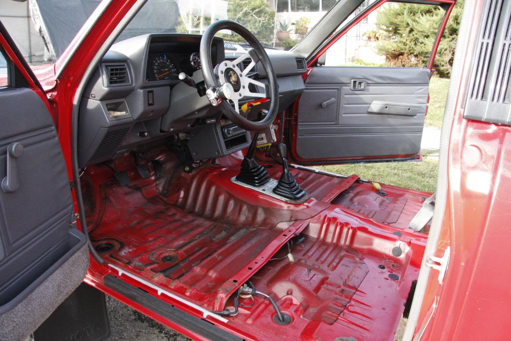

try this..> from Home depot.
Size:  123.4 KBName:  _MG_2793.jpg

can you comment on the smell?
Love the suicide knob as well!! I use to have one but I lost it!
Old Sep 4, 2010 | 09:44 AM
Teuf's Avatar
Posts: 5,592
Likes: 24
From: Dixon, Ca
Smell? well none. I used a bit of craft sticky spray, and the silver stuff is just foil n air. I love the suicide knob too.

It looks like Teuf installed something else in his red pickup... foil w/ the air bubble in between? You could try doubling up the 2 different types on the floor, and use the roofing material in the doors. I installed the roof repair inside the rear fenders/tailgate on my 4runner, and it rides pretty quiet now. The floor has roofing repair, then Jute padding, then the HD vinyl "carpet" flooring.

Yes mine was the tin foilish kind, no smell whatsoever. Ok I see the post about the roof material.

I had to readjust clutch pedal, after I put mine in. takes up a wee bit of room.

Well I put mine in for Noise, so that area was important. Heat not a problem
