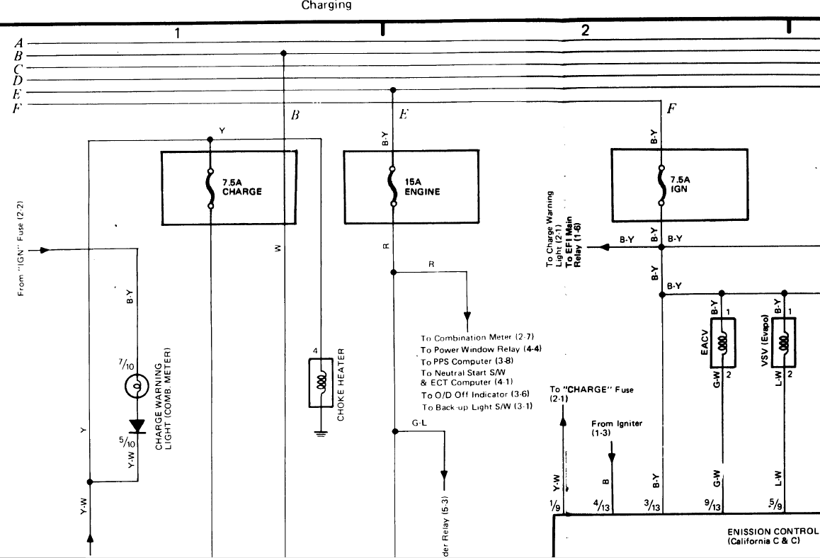

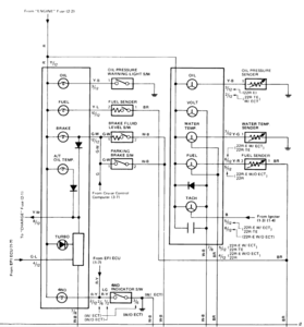

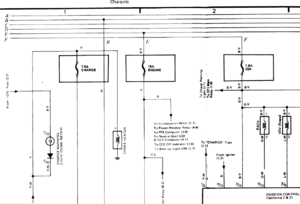

Post a picture of fuse blocks in your engine and cabin.
Find Engine fuse. On the 22RE that powers the tach is installed. Connect to wire that only has power when fuse is inserted. (Red in the case of 22REliable).
Attached Thumbnails Installing a tachometer-screen-shot-2018-06-13-7.00.13-am.png   Installing a tachometer-screen-shot-2018-06-13-6.59.36-am.png
