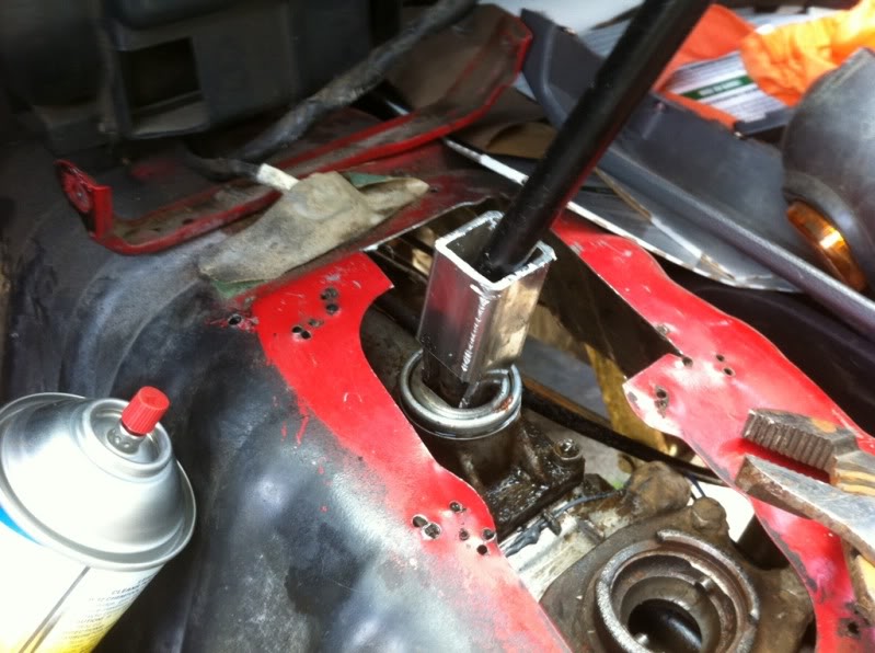

here is what i made for shifter coller removal and reinstall

That's pretty sweet!
