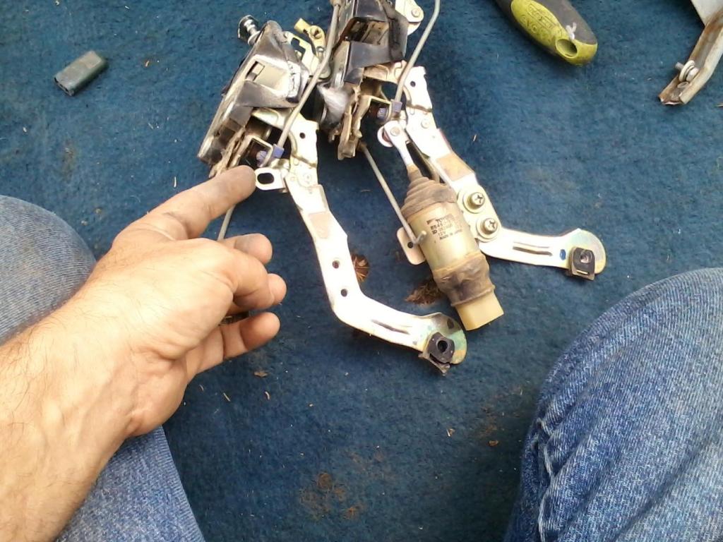

Here is the motor and where it goes.
When you get the latch assembly out. You have the option of installing an electric door lock. I am not installing it as I think your main harness in the dash has to be wired for it. I removed the electric motor as I wont be using it.

Thank you for the info and pics! so what kind of door lock fits? just a universal power door lock actuator motor?
