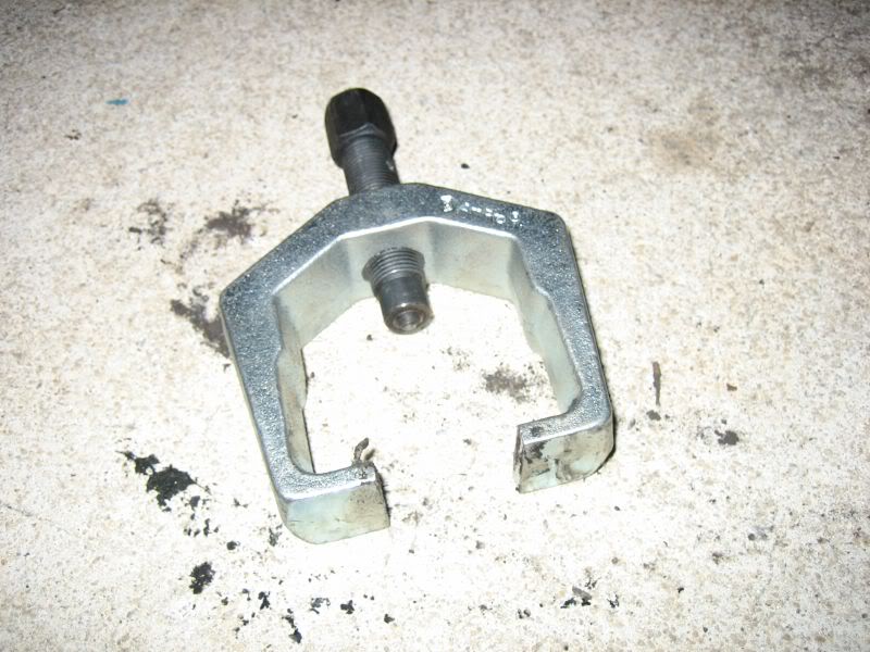

i need to install new tire rod ends and new idle arm. would this be difficult to do this myself? i did basic engine stuff but never anything with suspension. 4x4 parts is going to charge me 700 for parts and installation. do i need any special tools? what is that bracket thing down there?
Yes, it's very simple work to do just make sure you pick up one of these tie rod/pitman arm pullers(see below).
this part?
YES!!!! It makes the work easy!!

BigBlue's right, that's all you'll need
just make sure you get an alignment done (unless you trust you'r skills enough to do it yourself), beacuse the tow will be messed up when you're done

It's real simple, pick up some PB Blaster and that tool. I like to use torque wrenches and they're worth it if you do a lot of your own maitenance.

tie rod/pitman arm pullers. ok thanks... how exactly do you use it?
Tighten on the pitman arm or the TRE and hit it with an impact.
If no impact, tighten it up, hit end with 3 lb sledge, tighten it as much as possible again, repeat. Eventually it will pop the pitman arm or TRE off.

MAKE SURE TO LEAVE THE NUT ON!!!!!!! Either the balljoint or the TRE! 'Cause sometimes they come off, sometimes they POP off!!!
