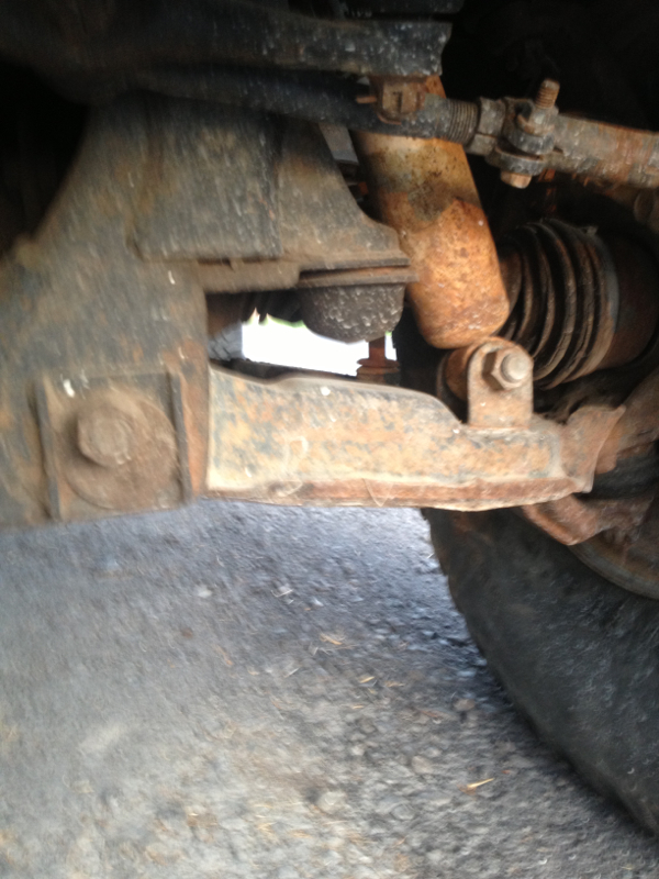

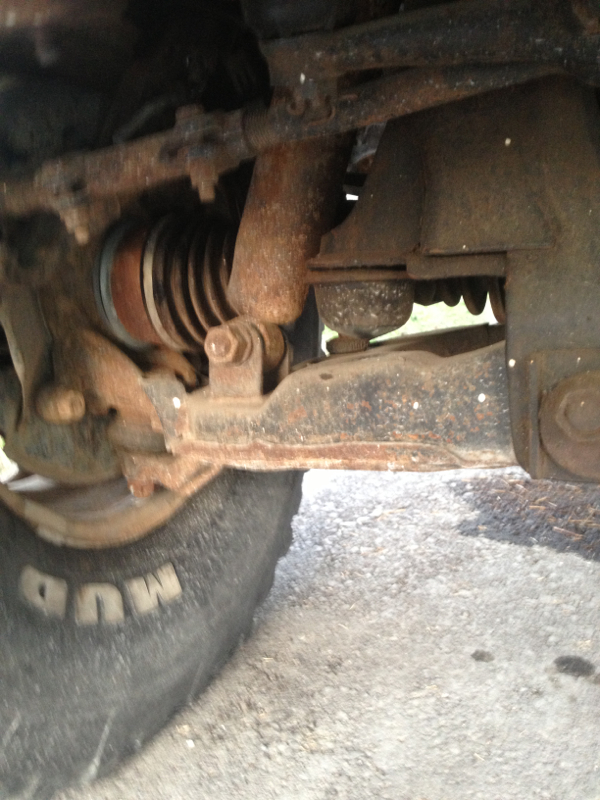

Here are some pictures of the bump stops. On left one should be about 2 inches of clearance, on right side maybe half inch.
Right
Left
Old Jul 11, 2013 | 06:16 PM
Punchy's Avatar
Joined: May 2012
Posts: 591
From: 91765
Jack up the passenger side letting the suspention hang freely.
Look at and match the amount of threads that are showing on the drivers side Tbar adjuster.
If the amount of threads looks the same already then the Tbar has gone soft or check the Tbar mount points for loose bolts or bent.

standard shocks only dampen wheel travel, not hold height. most likely an issue with the t-bars. take measurements from fender lip to center of axles and tell us. also take pic from further back so we can see what's going on and maybe someone will find something you didn't notice. use plenty of penetrating oil any time you want to mess with tbar adjusters or any 20+yr old hardware
