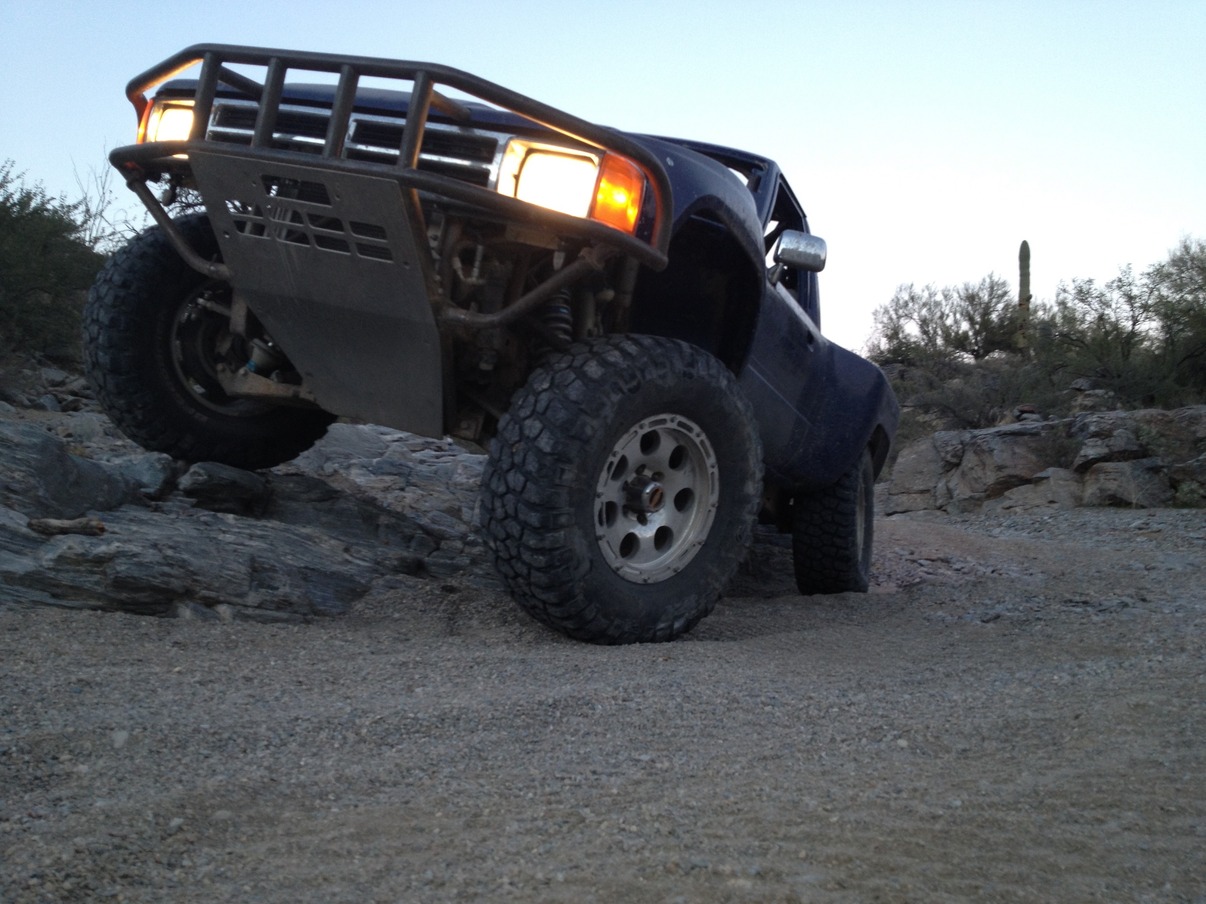

I realized I don't have any good off-road photos of my truck. I need a friend with a good camera!
I'm cycling 15" of wheel travel in the front w/ IFS.
I'll make it a point to get some flex pics next time I'm out.

Sick!

On factory LCA pivots, UCA cross shafts and w/ 4WD? Nicely done!

Im still waiting for RCV to get the '86-'94 CV shafts on the market. I talked to them today, they are still having testing issues. They said another year maybe. bummer. I snap the stock outer CVs like nothing.

I'd be surprised if RCV can ever get T-100 length CVs to work with anything more than 13" of travel. This is why some of us have migrated to Center Mounting the Diff and running even longer CVs.

I'm getting 15" with the 930 inner CVs, I just keep snapping the end of the stock outer off right at the snap ring groove. I've looked into the center mounted dif. I would have to re-engineer the front end to clear the 3.4 V6 oil pan. I just need to learn to keep my foot out of the throttle when I'm in 4 wheel drive until RCV comes through with the 4340 shafts.

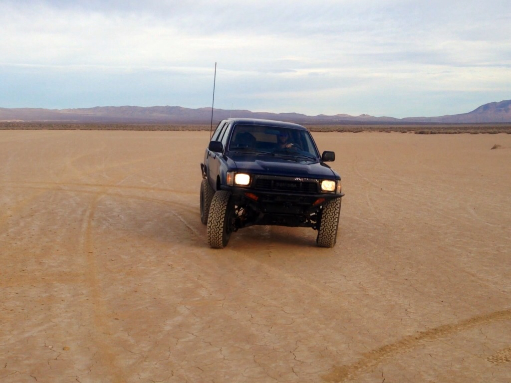

I know somewhere earlier in this thread someone said no "flat ground pics" but here's a flat ground flex pic without using ramps

Sweet! The video background I have in my mind is helping to make that picture even more badass! You were having fun man!

Haha, that was after the half wheelie Mark, just pulling back up to my passenger/videographer. I did pull a still of the wheel off the ground from that video, but that's showing lack of ifs flex more than ability to flex, so I figured this one is more appropriate. And my first contribution to this thread.

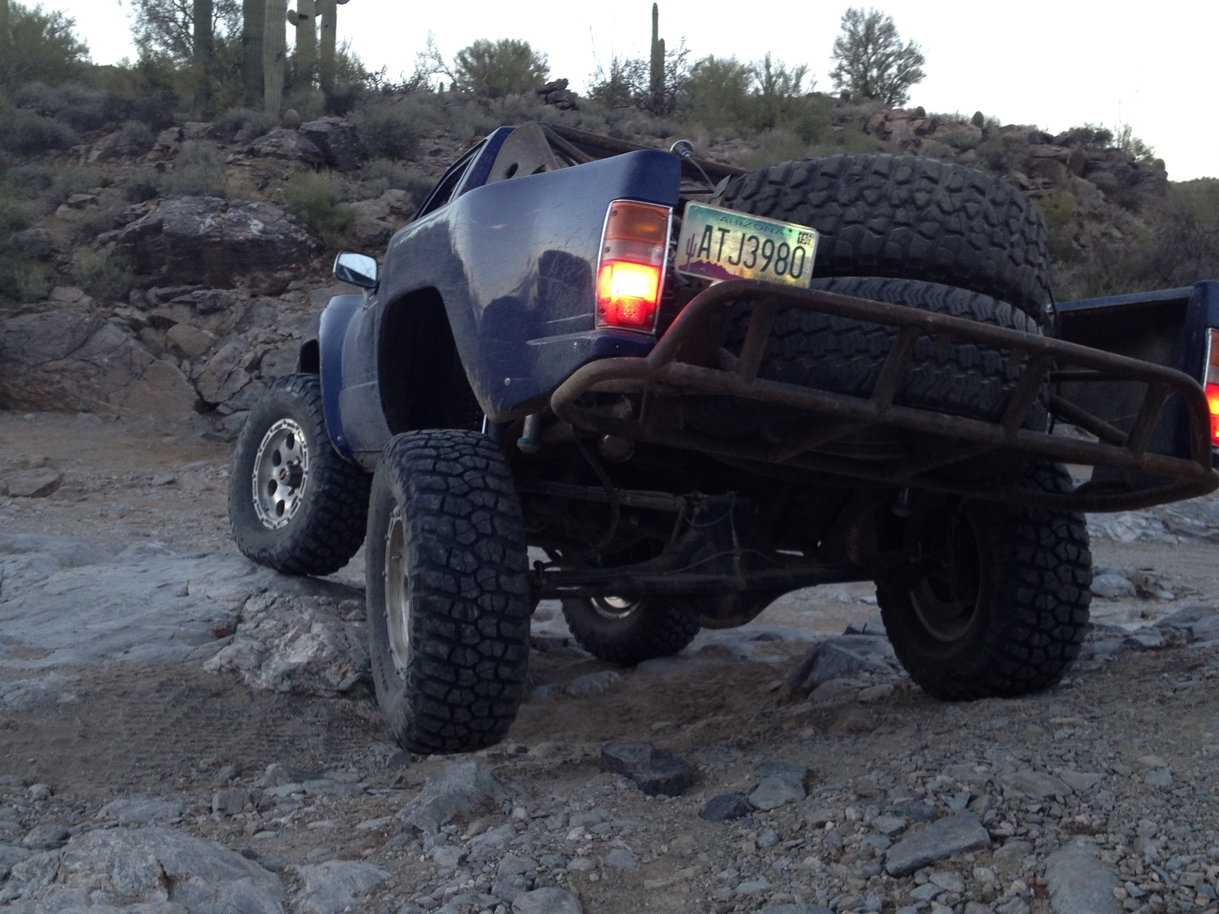

Posts: 4
From: Tempe, AZ

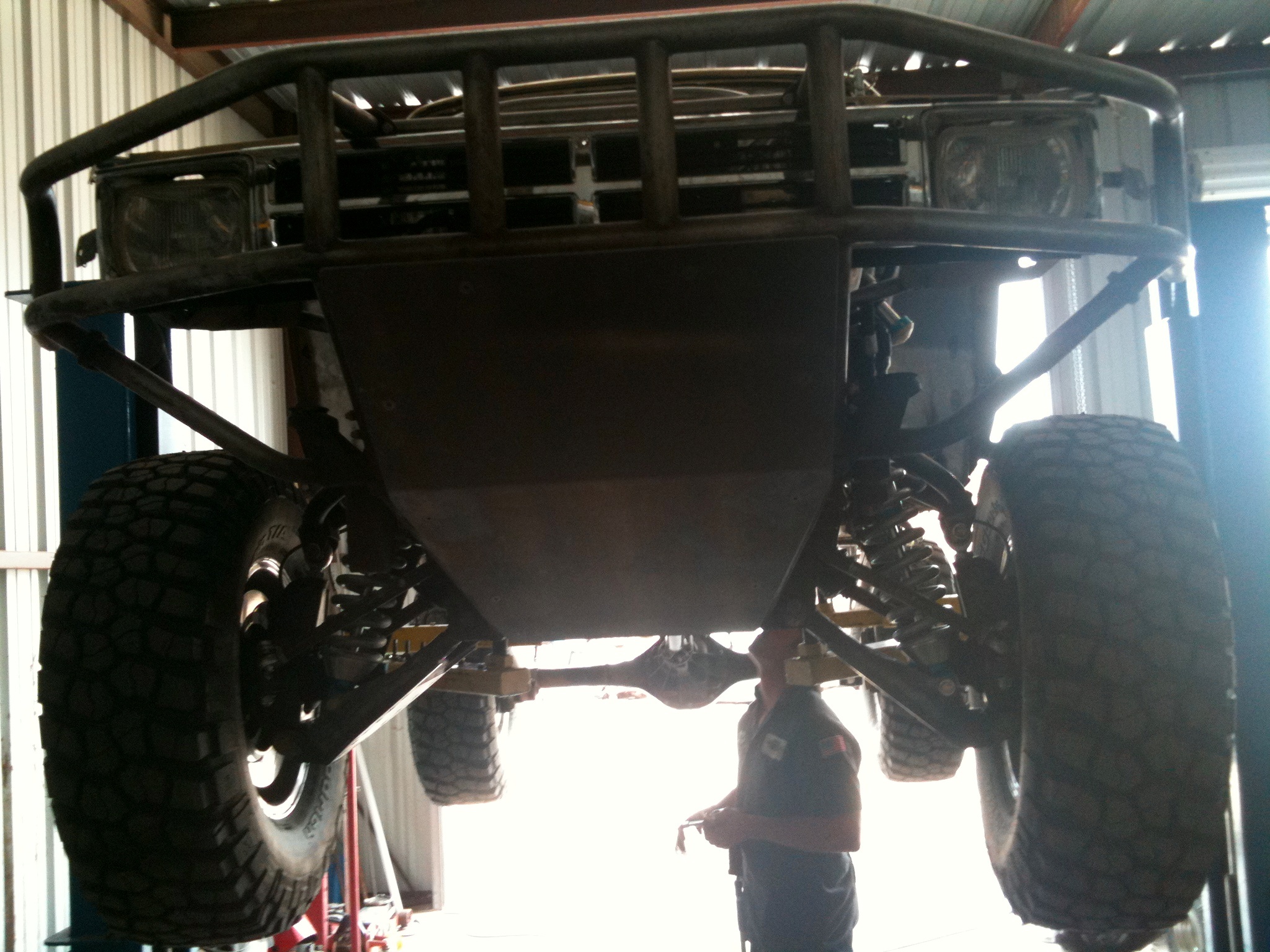

Here u go!
Went out this weekend and got some good pics.
Attached Thumbnails IFS Flex Pics-img_0218.jpg   IFS Flex Pics-img_0204.jpg   IFS Flex Pics-img_0206.jpg
