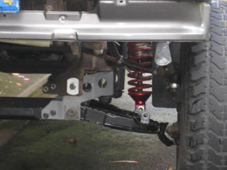

This past weekend I got the 4" drop bracket kit mostly installed. The 35" tires seem to be have the right proportions. I am over my limit for posting pictures and the jpegs my camera is producing is over the 48kb limit. This is the only image I could find that was small enough to work.

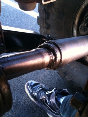

at this point i am making my axles my self. like a short drive line.

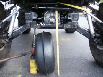

that is a 22 inch tire. Ifs at full droop.My set up has about 12 inches of travel.

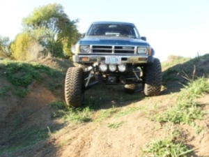

still holding together. As soon as i lower my gas tank back to stock location body lift is byby.
