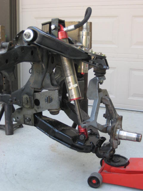

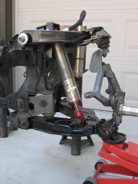

Here is a ProComp / Blazeland combo. Its just a mock up for testing some different shock configurations so not everything is bolted up. The shock is a 10" travel and the upper shock mount is a shock tower I built way long ago to restore the factory bayonet tabs the Downey double hoops required be cut off.

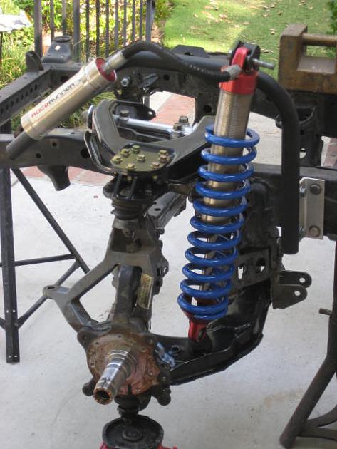

Here is another pic. This time I was mocking up for a coil over coversion. Note the lower shock mount on the arms is missing.

Thanks for the info and pictures BlazeN8. The Coilover conversion looks awesome.

yeah the smashing of the bracket into the ground wont happen.....maybe with TC's kit but i dont think it would with blazelands kit, it gains more travel by lift and width not by increasing the uptravel...you would have to cut off your bump-stops and move them up to achieve bracket smashing into the ground and if your worried about IFS strength get an IFS brace and some LCA braces that go to the tranny x member...my bracket lift came with the LCA braces

Seems like you could go with a lot shorter shock, 10" is a waste?
I have this much uptravel on my SAS and thats mild.
I dunno... bracket lifts do weaken things alot considering the stock IFS of a toyota is weak to begin with. The rear lower control arm brackets bend and tweak FAR to easily. You'd really need some rear truss's and a cross brace for the rear brackets if you seriously wanted to jump the truck.
Just out of curiousity why the larger T-bars? This have something to do with the added leverage the longer arms provide on the arms?
