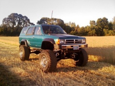

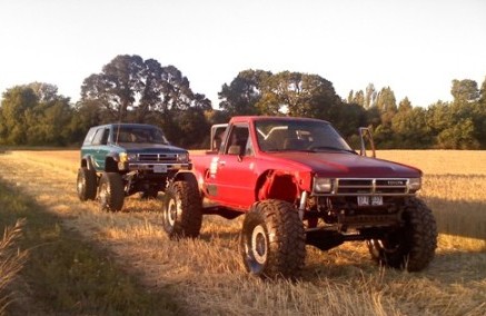

I put about 3 thousand miles on the blaze land drop bracket combo with no problems at all. a lot of gravel roads , trails, sand dunes and pavment.i welded both mine and a freinds 93 4 runner drop brackets to the frame.I had some improvment in highway maners. He has stock a arms and said it made a big diffrence.I would recomend any one using a drop bracket lift to weld it in place if you plan on keeping it.

A few pictures.
Attached Thumbnails IFS Bracket Lift with Long Travel-malloys-1-runner.jpg   IFS Bracket Lift with Long Travel-long-travel-build-1-008.jpg   IFS Bracket Lift with Long Travel-2-runner-molloys.jpg

so you Welded your drop brackets to the frame? instead of JUST bolting them? therefore making it stronger correct?
that 4runner is AWFULLY TALLL...lmao but it's REALLYYYYY sexy...are those 35x14.50's?

no i would defently use all the bolts.I just put like 6 1.5 inch welds strait down from the singal bolt so you have two holding point insted of one per corner. 37 x 14.5 tires.
