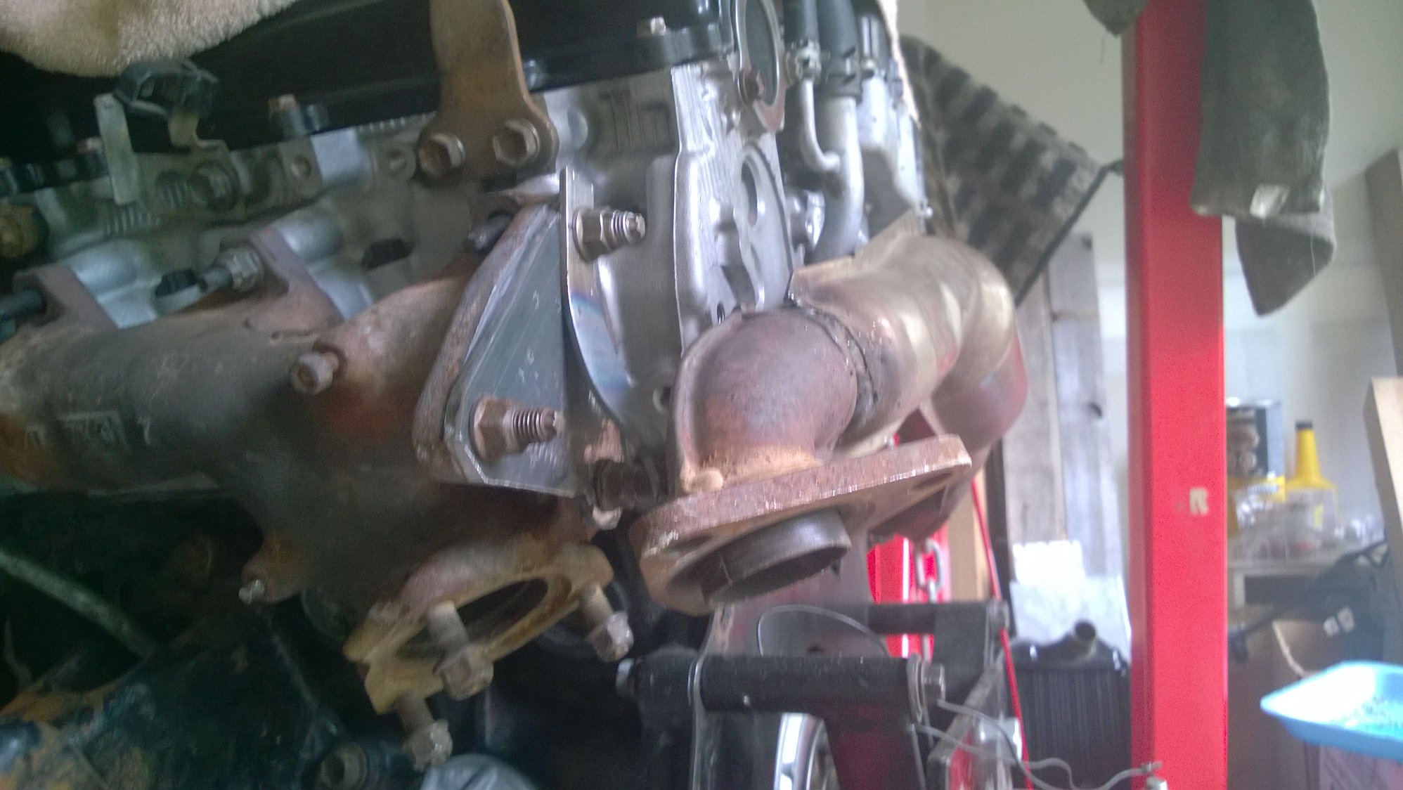

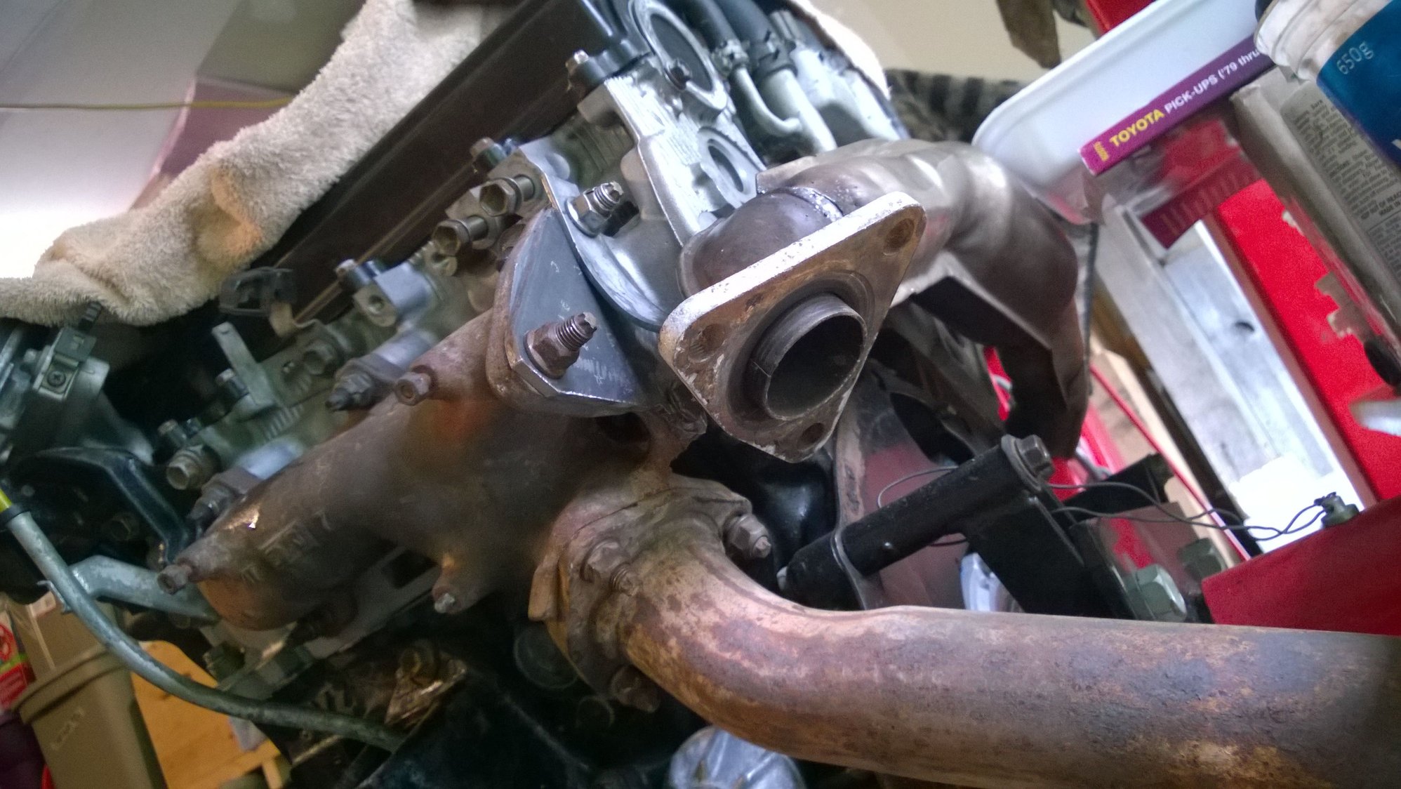

Hi,
1994 4 runner with rebuilt top end of motor (fully rebuilt heads and lightly honed cylinders after motor blew OEM original head-gaskets and previous owner was using non OEM green coolant (Worst thing you can do on a 3vze 4runner!)
Mileage on vehicle: 317,000 kms
Been running the grey top injectors for 6 months now. I will give me feedback and comments on using these injectors from my perspective:
1. Bought the set and didn't install them for 8 months (rebuilt topend of motor) After fitting motor and starting, two injectors were stuck closed. probably due to cleaning fluid dried up inside the injector, so gave them a gentle tap on the metal body while motor was running which freed them up. Ran full tank of gas and bottle of injector cleaner and injectors were great since.
2. I have done a few other mods which i will detail here:
modified exhaust:
This alone has to be the first and biggest improvement you can make on any 4runner with the 3VZE motor!!! Why in god's name Toyota though it was a good idea/an engineering decision/cost saving to dump all the exhaust gas from three cylinders into the other side exhaust manifold is beyond me. This has to be the worst design elements of any motor!!! This creates sooo many issues regardless if you drive this to the corner store only or drive highway miles or drive flat to the floor everywhere!!!
3. Used Toyota super long life coolant - Updating the coolant is 100% must in a 3VZE motor. Use Toyota Red (00272-1LLAC) minimum, DO NOT USE ANYTHING ELSE!! (not really a mod, but a must. I have done this to every 3vze motor I have owned, including several other toyota motors and Nissan motors and run this coolant for 300.000 kms with no cooling/headgasket issues, even with no modifications)
4. Adjusted my AFM - I know there are other threads with this adjustment, but most of those people who adjusted the AFM did it on gut feel and did not have the exhaust modification done either, so the usual 3 clicks lean is probably fine.
I have adjusted my AFM using an AFR meter to achieve MPG, not performance. my AFM was adjusted 6 clicks lean to achieve an MPG combined of 19-20 MPG
Performance is vastly improved also. In comparison, with previous 3VZE 4 runners I have owned, cruising the highway at 100 km/h with the cruise control active, approaching a hill the cruise control would dis-connect the TCC lockup and downshift to try and maintain speed, but could not hold 100 km/h. I can now do the same section of highway in cruise control and the TCC lock is the only thing the transmission needs to maintain cruise speed. Low end torque has increased from 1400 rpm to 2700 rpm, with only 30-40% throttle applied.
So general notes about all my modifications and the injectors:
As the grey top injectors are re-manufactured, they do leak under pressure, so hot starting after 30-40 minutes requires some additional cranking and opening the throttle fully to start the motor is required. I think the yellow injectors which flamethrower is now using are probably a newer, better design. The grey tops also flow more fuel than the standard for the same pressure, so you can definitely get more out of using his injectors by leaning out the system which was already en-riched from factory and wear and tear on the AFM with high miles
As I have an auto trans, I don't rev the motor past 4,000 rpm in general and at WOT (wide open throttle) for two reasons:
1. The motor design - it's designed to produce adequate torque for the weight on a heavy SUV, not for power. I have seen too many 3vze let go on the bottom end (hole in block from big end bearing cap bolt failure, might be that owner maintenance is a contributor, I don't know but the big end bearing cap bolts are not very big!)
2. With the OEM computer map at 3.5k and higher RPM's - above 3,000 rpm up to my personal rev limit of 4,000 rpm, the AFR are in the region of 10.5 to under 9! I have no control over this AFR at these RPM's and I'm sure Toyota took the extreme safety with mapping WOT so it's just wasting copious amounts of gas, it's not making any more useful torque or power and not contributing towards my main goal in my modifications which was economy, not power.

Welcome nilezy. First of all I like the exhaust mods you did. I would like for you to post some more pics of the rest of that pipe. In another thread perhaps as it is a bit off topic here.
Also off topic, but a response to your post about coolant. It seems thousands of people are running ethylene glycol based coolants with great aiccess, including myself. The color is green. I dont think its right to use such absolute language as so much experience here on the forums shows otherwise.
