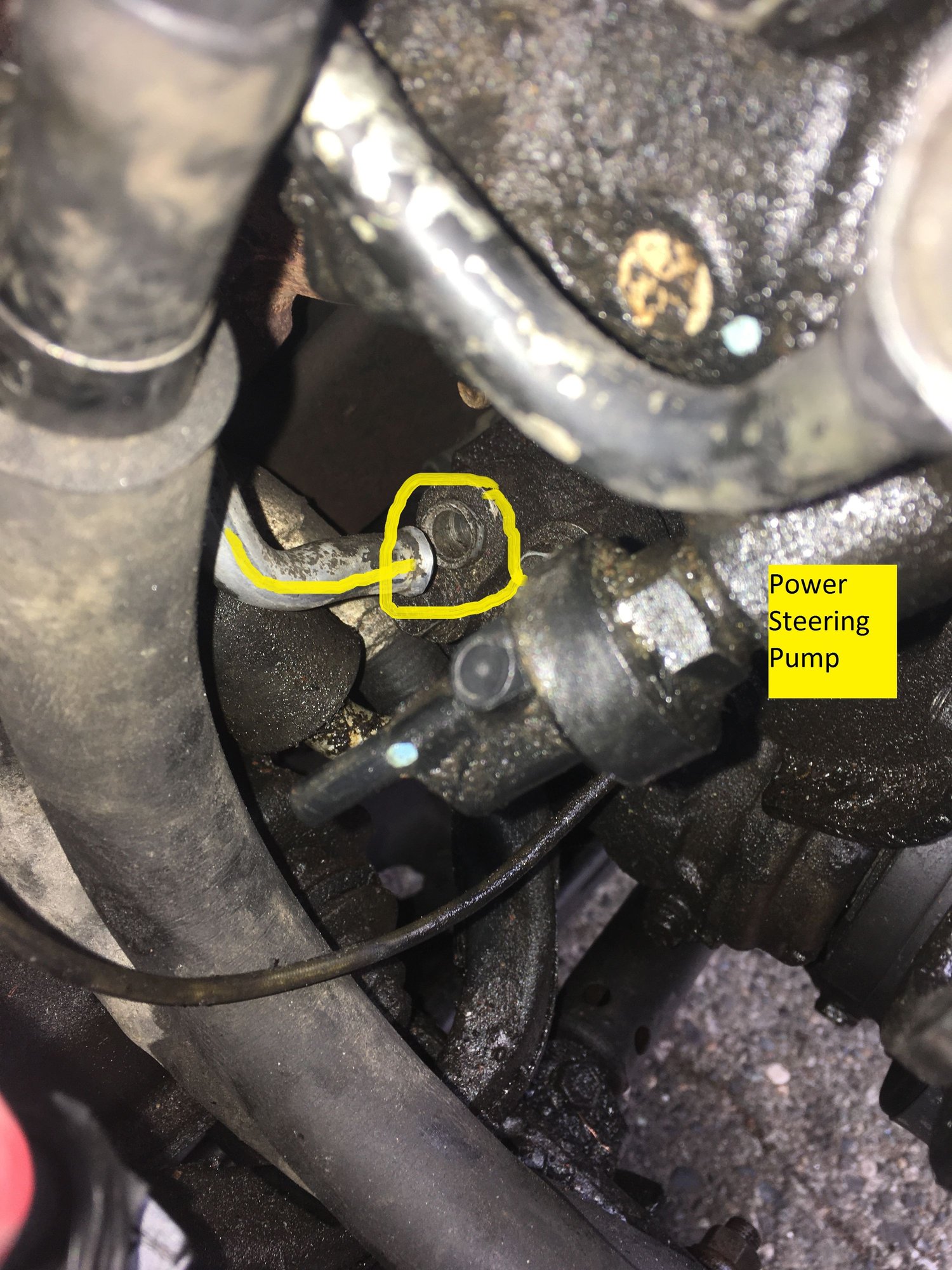

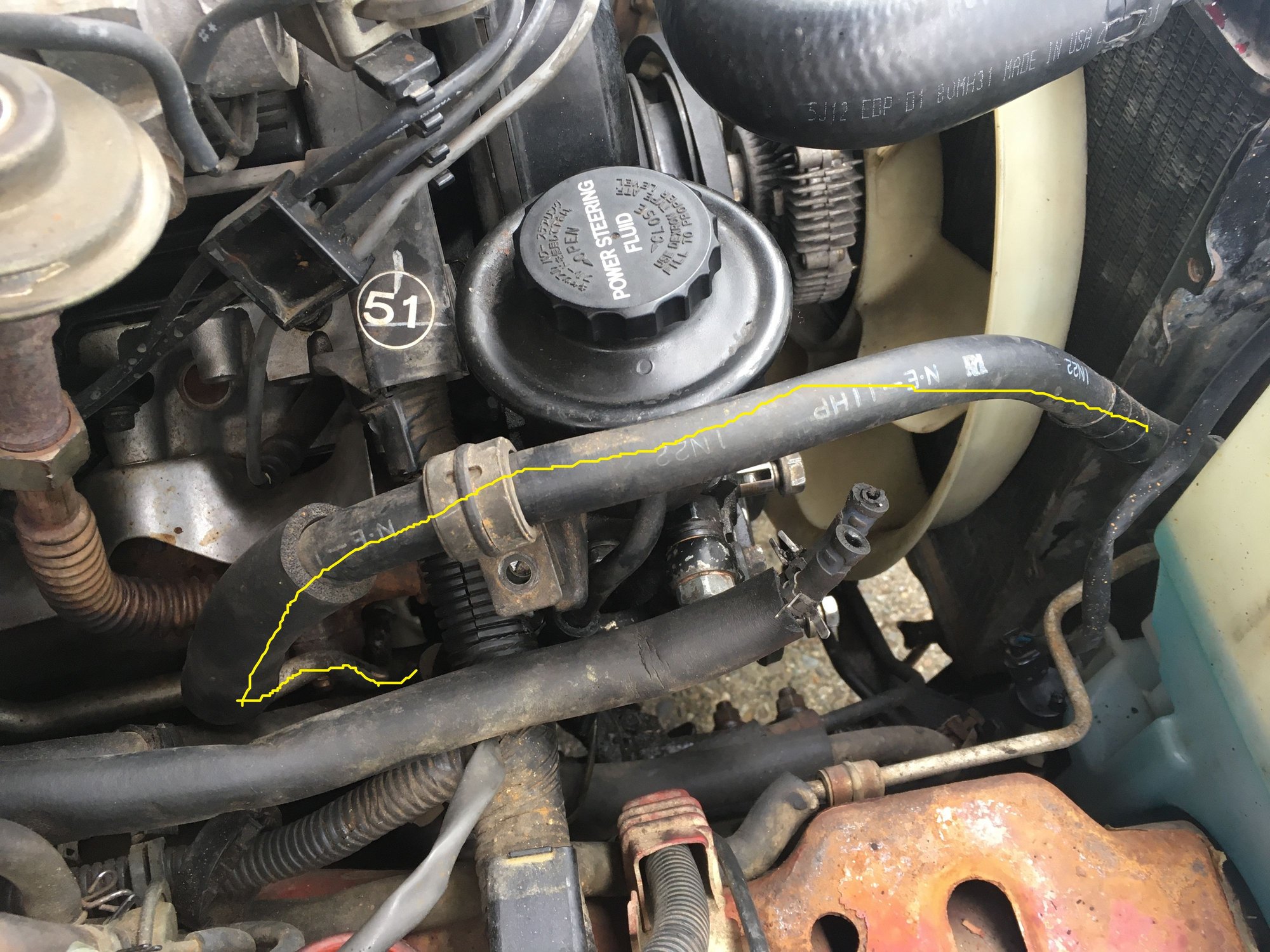

Hey guys I'm back with another post about helping me find out what part i need. I pulled my power steering pump out(wow) and found this hose that has been disconnected for who knows how long. Can someone tell me what it is? I swear I saw what it was online a few days ago when i was shopping for other parts but now i forget. Thanks!

That looks like a refrigerant hose for your Air Conditioning.
I assume that your Air Conditioning hasn't worked for a while.

It has not worked for at least 2 years! Luckily I don’t need it much in the PNW. Do you or anyone happen to know if it is a problem as is? Could I just pull that line out and plug that hole? Do I even need to plug the hole? Thank you so much for the reply!

Do you plan on fixing the A/C?
If so, sealing it up will keep any further debris from going into the A/C system. There are already some debris that would need to be cleaned out before fixing the A/C, but capping it off would reduce further damage.
If not, It probably doesn't matter at this point because moisture and debris have already gotten into the system, and the A/C compressor and hose are only needed if you want the Air Conditioner to work.
