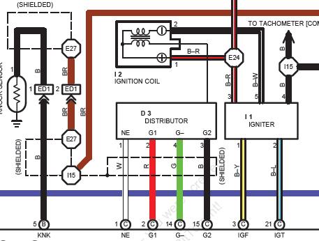

Check the ignition signal wires, specificly the shielding might be damaged.

the ones going to distributor correct . ?
from ecu and ignitor

Yep, between dist and ecu.
