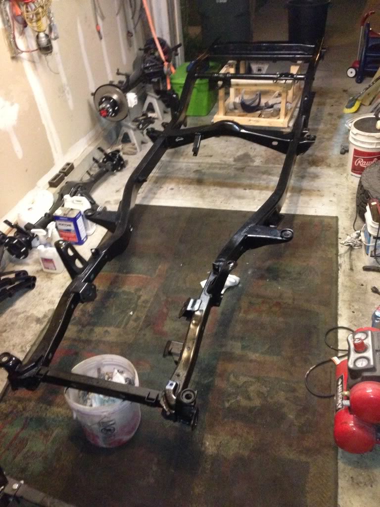

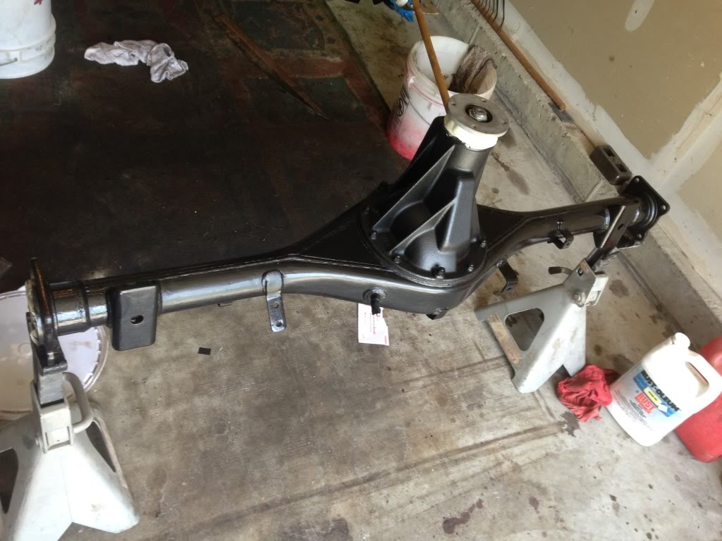

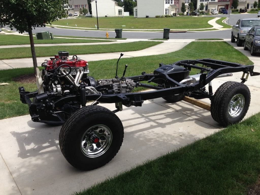

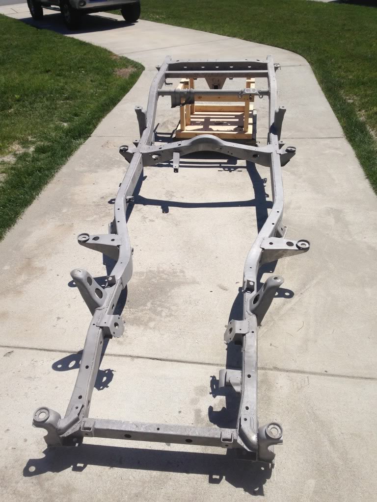

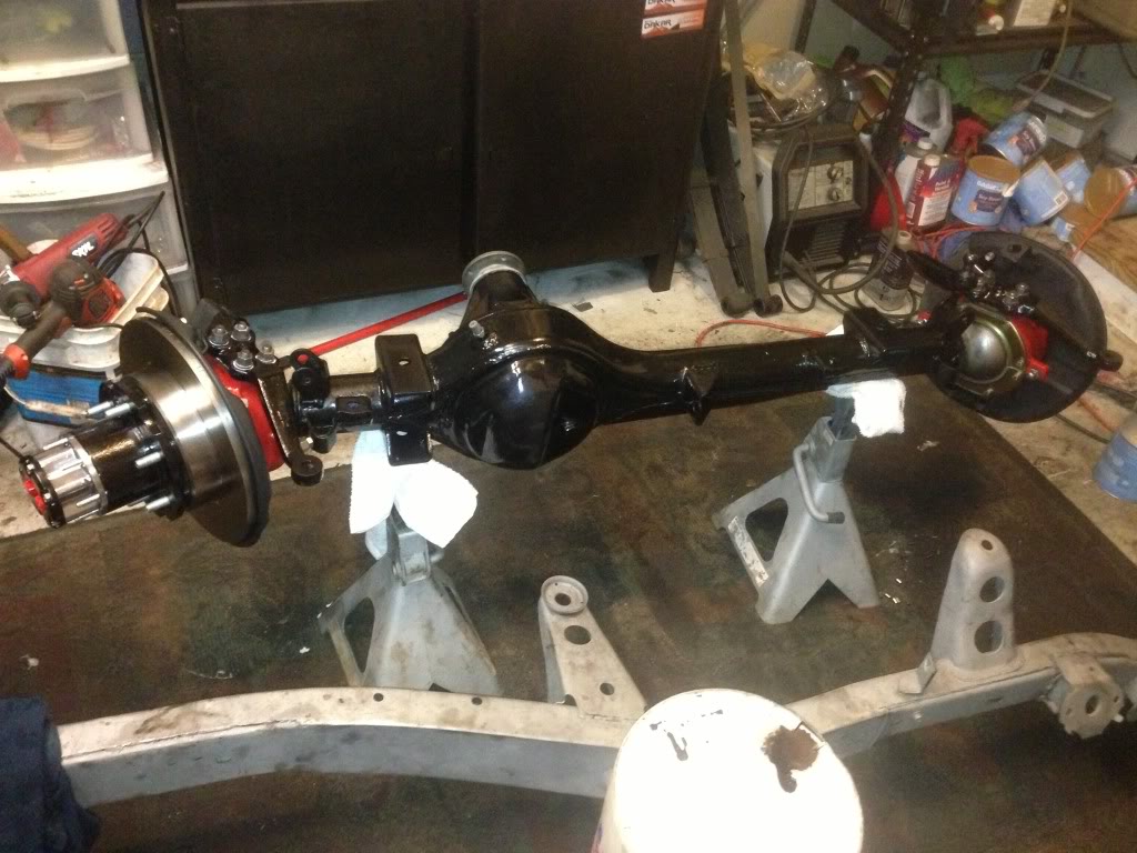

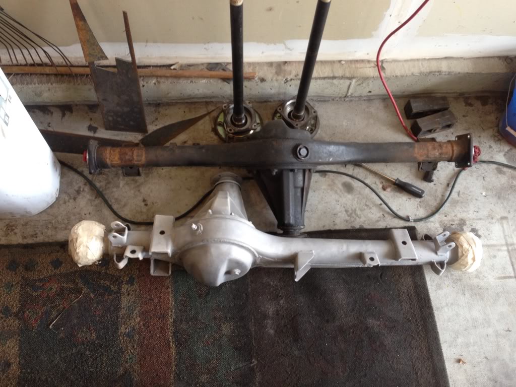

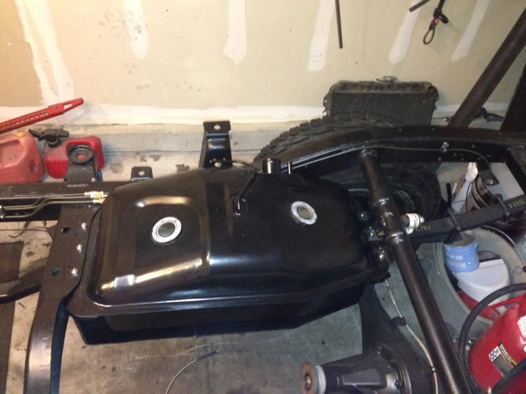

You can use Hydochloric acid to remove rust rather easily chemically, but if you are the slightest bit clumsy you might want to try a weaker product such as Muriatic Acid because hydrochloric acid is very painful if it comes into contact with your skin.
If you want to remove the rust mechanically, I would go with a media blasting. You can get a cheap Harbor Freight blaster for around $75, but get good glass media such at Black Diamond available at Tractor supply or it can take forever to cut through the gunk.
I blasted my entire truck (frame, chassis and axles) when I was restoring my 83 pickup and it was the perfect (and recommended) substrate for POR-15. I brushed on two coats of POR-15 and sprayed the third. Then sprayed two coats POR-15's Chassis Coat as a top coat while the base coat was still tacky (have to top coat it or it or the rust preventative paint will deteriorate under UV light). It took about 2.5 quarts of POR-15 Rust preventative and 1.5 coats of Chassis Coat to do my entire frame, axles and driveshafts. POR-15 may seem expensive, but a little bit goes a really long way. The stuff is rock solid, durable and looks good - I am very please with the results.
Here are some pictures of the stuff I did:

WOW-that is some seriously nice work!
