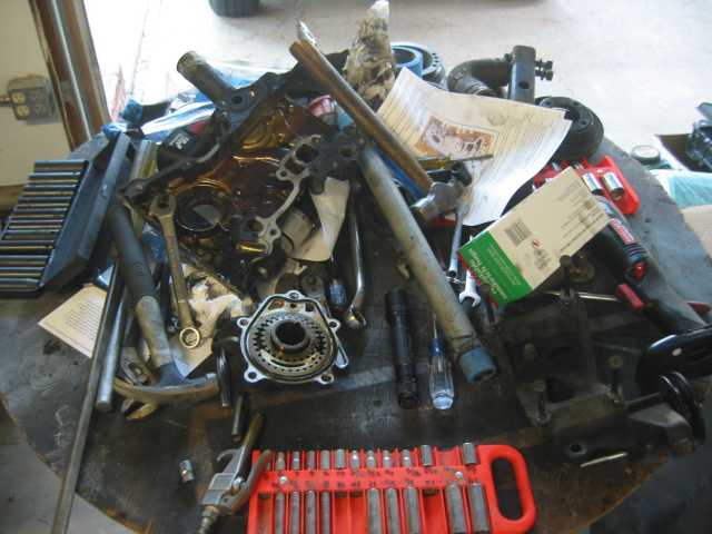

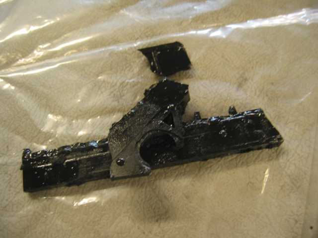

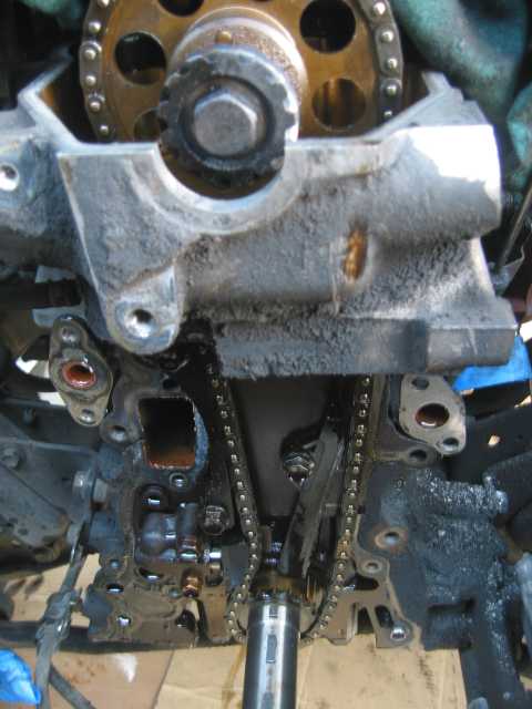

Well 5 hours and I have it all apart. The worst part was getting the oil pan off this 2wd. The streering linkage is right under the pan. I got the little joint to break free with a separator fork but I could not get either of the larger two that would allow me to drop the linkage. The solution is to drop the sway bar. I just clears with some force. Anyway I now have a table full of parts and a bunch of peices of a broken guide.
Woodo
