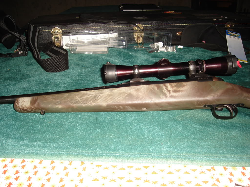

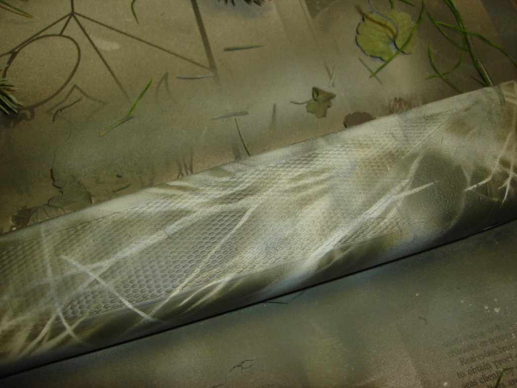

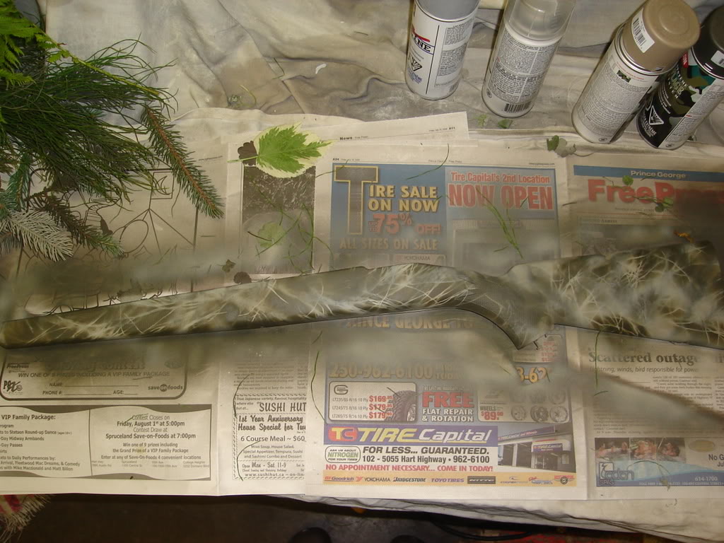

Originally Posted by yodercrawler55
dang that skull idea is pretty tight, when i camo my stuff i find ferns and branches then spray over them to get a mossy oak look
like this

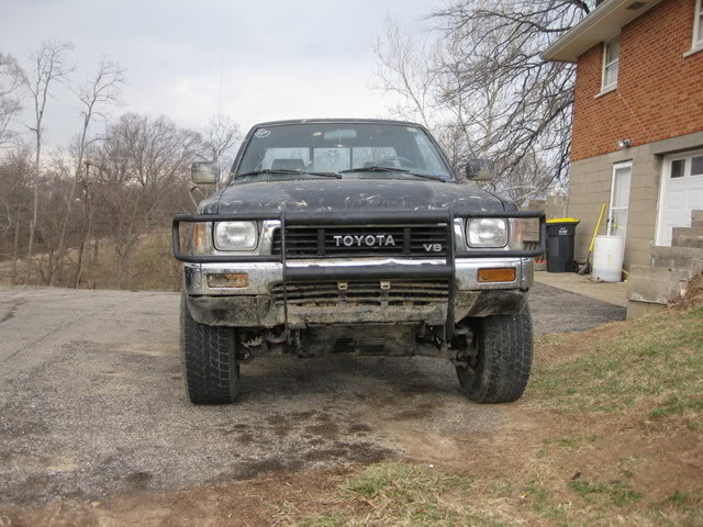

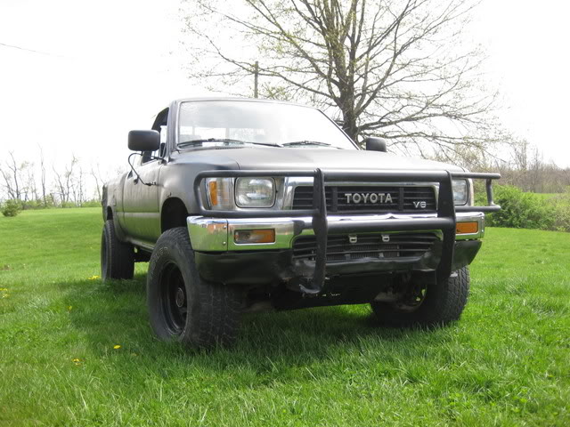

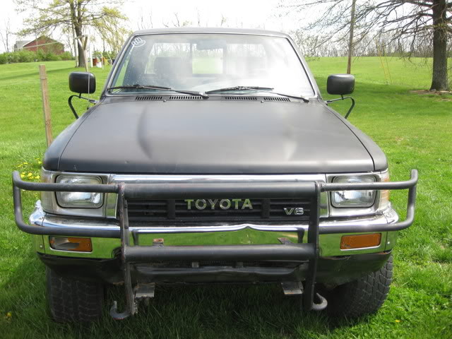

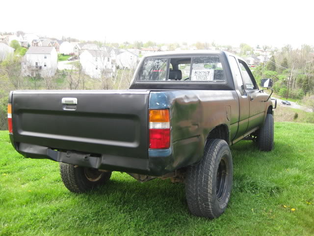

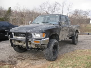

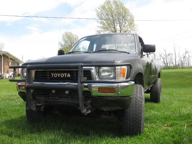

It took me about 20 somethin cause i didnt want it to look too ty haha. Sanded everything down with 180 grit and a sanding block. Then i used like 4 cans of rustoleum primer, 10 or so cans of walmart cheap gloss black and about 5 cans of Krylon matte finish.
Before: Real dirty and beat up

After: Clean and still beat up

The tailgate turned out the best. I didnt bother with the big ass dent in the bed yet

I didnt bother with the drivers door either cause its beat to hell and back. i'm gonna hit the wheels the same way when i get my new tires on. I think it turned out pretty good for rattle cans. the pics dont really do it justice

^ hahah, my tailgate turned out the best too

must be somethin about the tailgates haha, took it off and did it separate, maybe thats why i dont know lol
