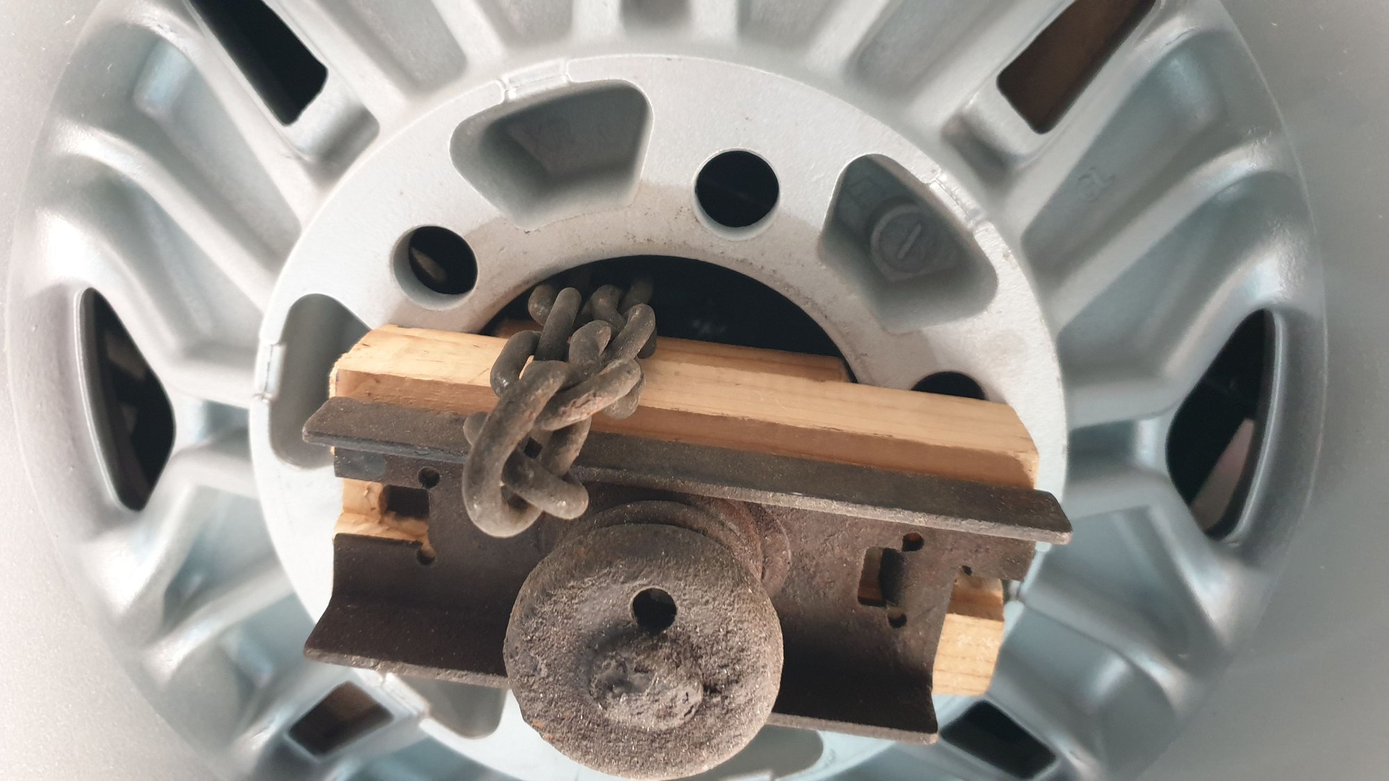

I'm looking for a T4R first gen spare tire hoist/winch for alloy rims. My truck has the one for steel rims, but the base doesn't fit, that is the reason I'm using it with a piece of wood as you can see in this pic:
That solution's good enough for me, it's not visible, I could leave it this way, the problem is the chain keeps hitting the rim.
So do you know if the T4R first gen spare tire hoist/winch for alloy rims has cable instead of chain?

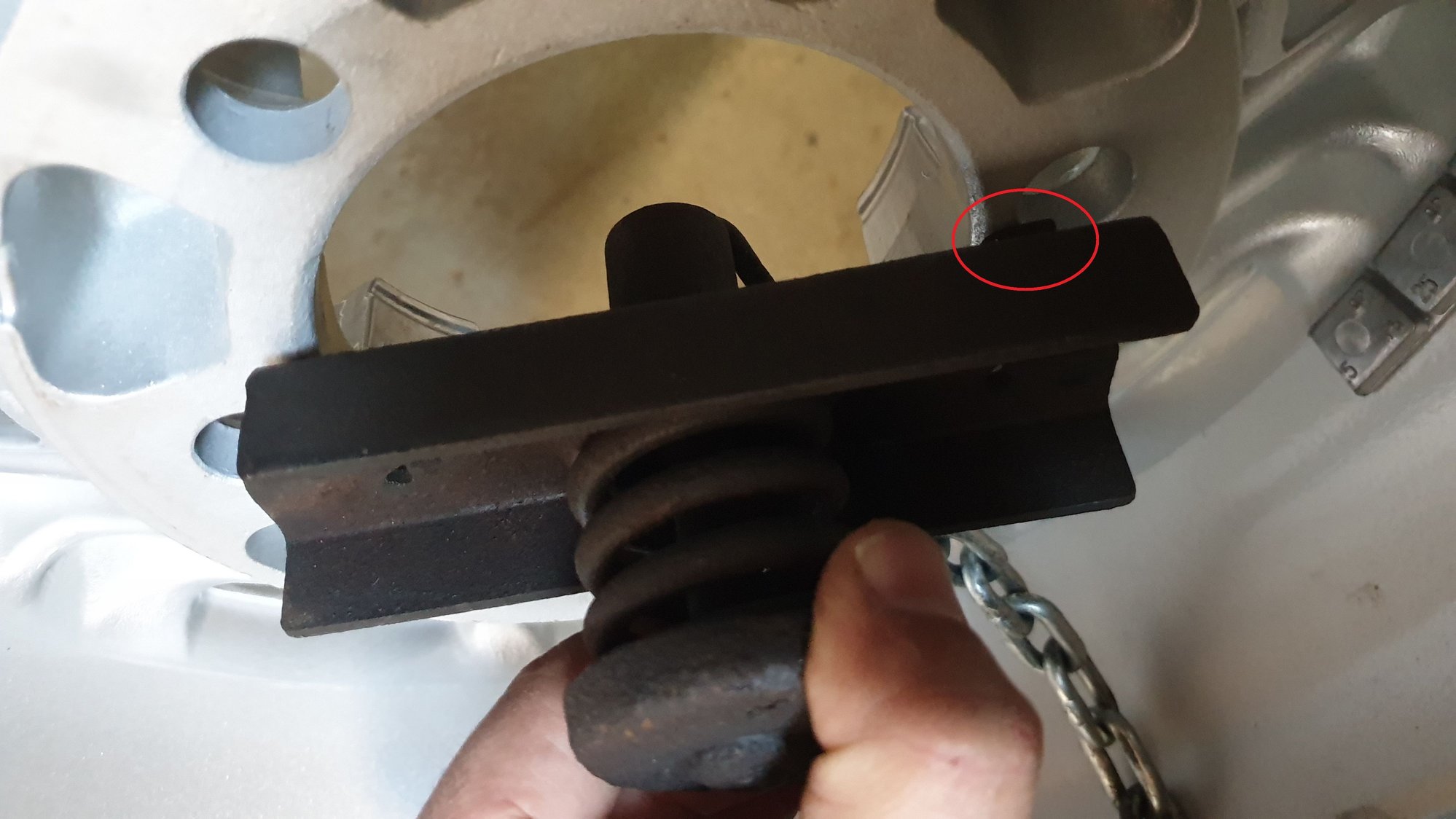

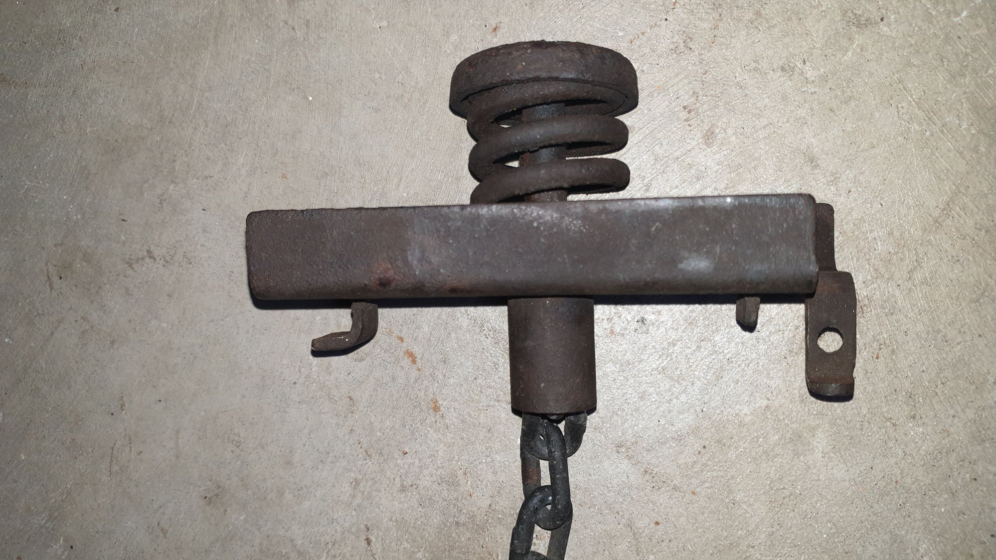

Is yours similar than this one? The problem is this tab:
You can see it here better:

Spare Hoist
Cut-off Wheel time.....

I'd heat and bend, or cut that down and never look back.

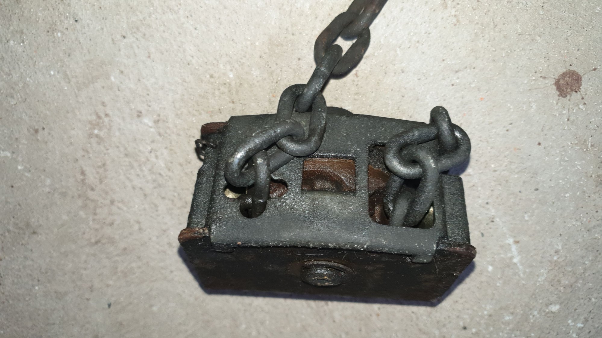

Mine has 3 holes in the top:

I can remove the tab, that is ok, the problem is the chain hitting the alloy rim when I drive the truck, that is the reason of my first question:
