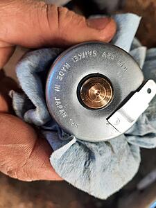

Shouldnt have messed with it, but here we are... Anyone know if the oil pressure gauge on these trucks is repairable or replaceable without having to swap the whole cluster? Any sources for one, or am i relegated to junk yards?
I replaced my sending unit, because my reading was low ish and it was annoying to have the needle at zero once the oil was hot (not that useful). New sending unit seemed to work for about 4 minutes, then it pegged the gauge to max. Was thinking water may have got up under the cover and shorted the unit... Driving around a bit more and it dropped to zero at lights, then all the way to max if rpms went up at all. Got home and went through some diagnostics.
Test light goes on between sensor hot and ground. Test light was measured at ~10ohms. Gauge stays at zero. Gauge is now always at zero even when driving around... Any tips?

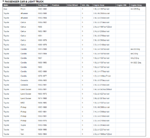

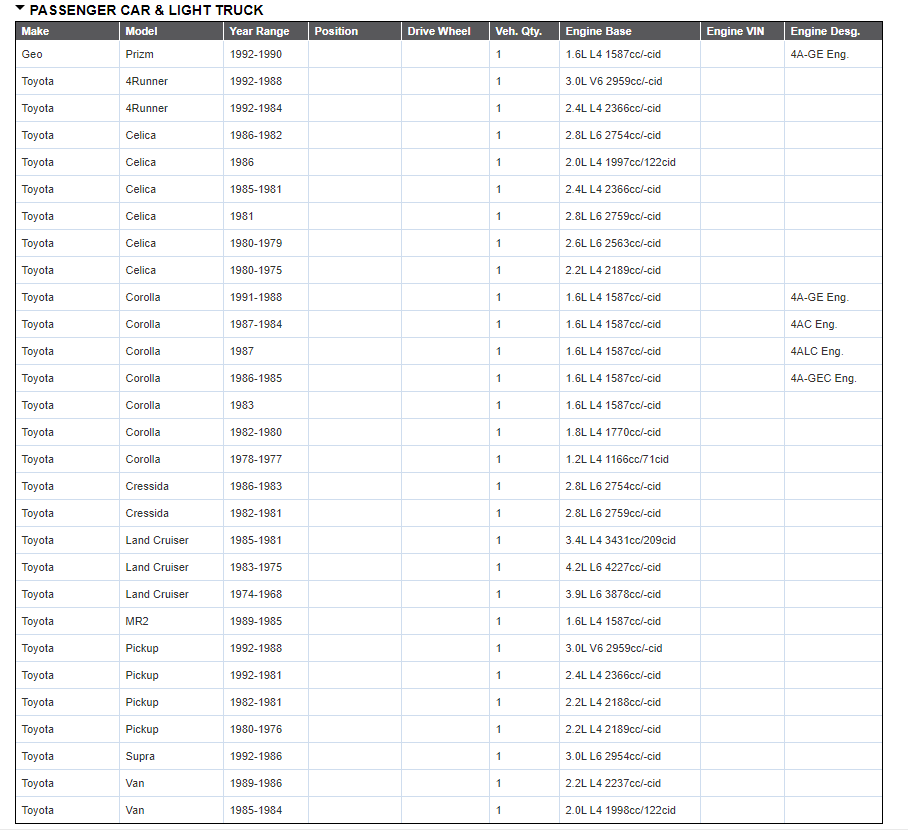

You dont need a toyota specific one, but any old pressure sender probably wont work the way you want. The way it works is the gauge grounds through the sender, which has some large resistance. Gauges may have a different "excitation" current. The sender has to match the gauge in terms of resistance curve with pressure.
BECK/ARNLEY 2011130 cross refs with the following:
Alternate/OEM Part Number(s): 8352014020, 8352014021, 8352014022, 8352014023, 8352055011
I might recommend just getting the OEM toyota one.

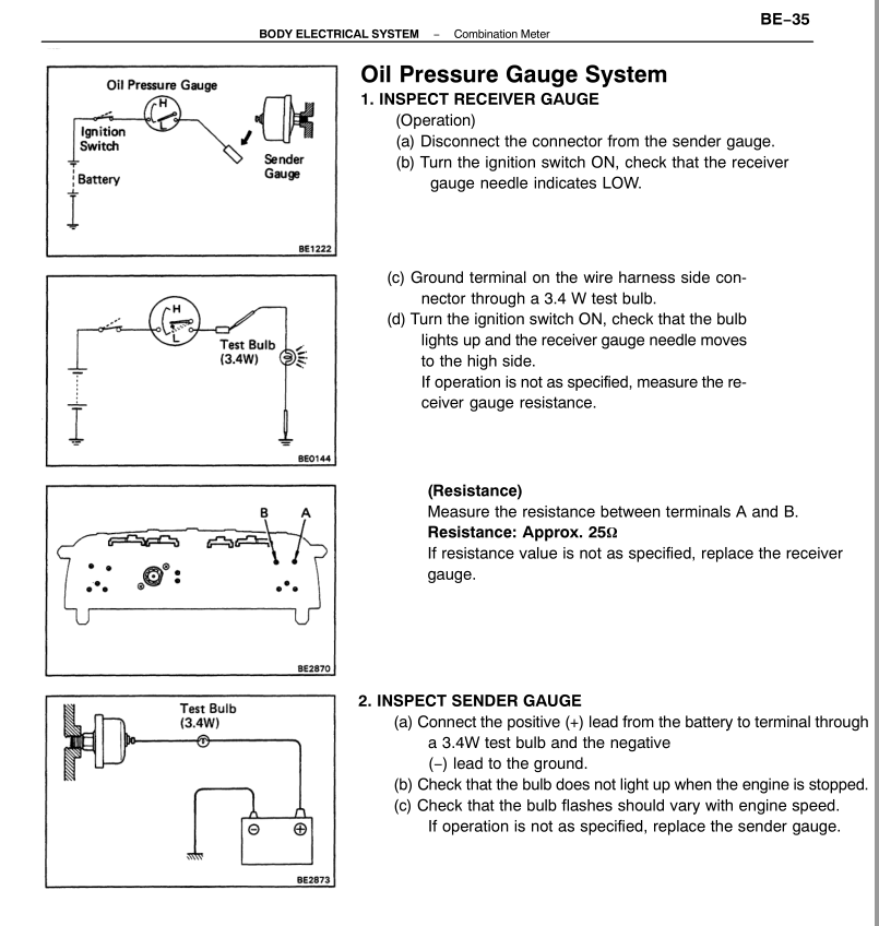

Approximately 25 ohms for the gauge. The sender does not have a spec. http://web.archive.org/web/201102052.../6combinat.pdf
If you grounded the gauge you probably destroyed it. This is a common issue with those who swap their combination meter (instrument panel) with idiot light for one with a gauge. If they don't replace the oil pressure warning switch with a sender, as soon as power is applied the switch grounds the meter and destroys it.

Just in case I'm completely wrong about the result, use the test method described in the manual section I linked to test the gauge.

Check the sender and the gauge using the described procedure in FSM. If both check out, PERSONALLY i would just buy a new toyota OEM sender and install it, as they can get off enough to read low (what was happening to me).
The other thing to do is just check oil pressure using an actually accurate gauge. I would first always assume the factory gauge is lying.

That is exactly what I need, thanks for posting! Just got a new dvm
