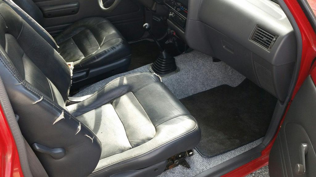

Or... you could just do what I did and go to a wrecking yard and pull some from a later model in good shape. I got some for $7.50 at a local wrecking yard on their half price day. Not a perfect fit, but a lot cheaper and a whole lot less work...
Quick, simple and cheap!
and looks plenty good enough...
