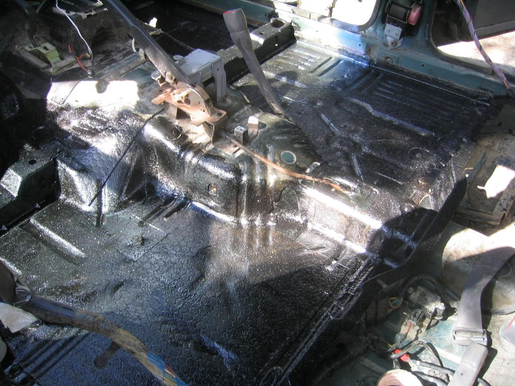

Duplicolor sucks. It's not anti slip at all.
I did my Heep's interior with Herculiner and was very pleased.
I moved any wires out of the way, put tape...guess you could say balls into all the various holes for bolts and what not then just started rolling it on.
I can't stress enough that it is all in the prep. Clean everything and then clean it again, whip the floors with the pad provided in the kit, then go over the floors with Acetone and a rag (do this a few times). Make sure everything is VERY clean or it might peel up on you.
I had 2 small areas in my rear hatch peel up simply because I didn't prep the back as well as the front.

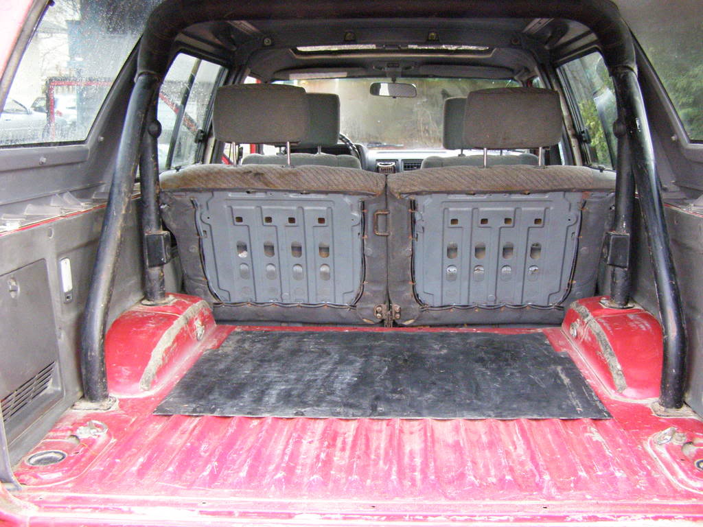

i tore the carpet outta my 4runner...so much better
gonna be doing the hurculiner or durabak pretty soon..heres what it looks like without the carpet...
very convenient when it gets full of dirt i just sweep/spray it out and dont worry about the carpet getting all stained.
