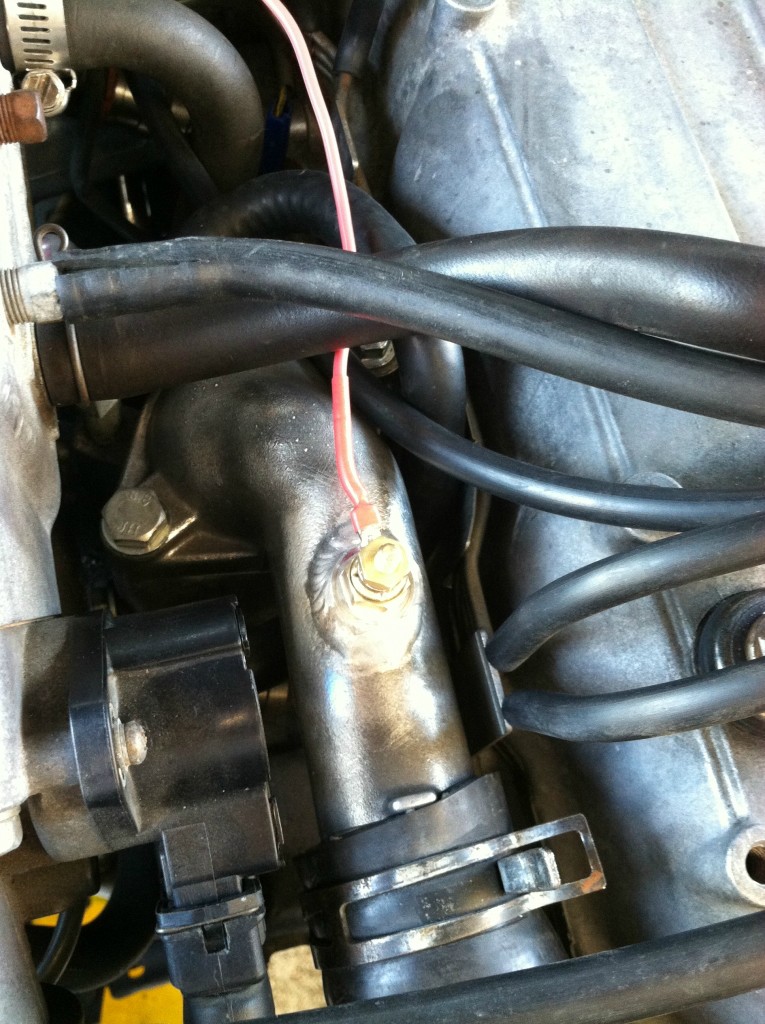

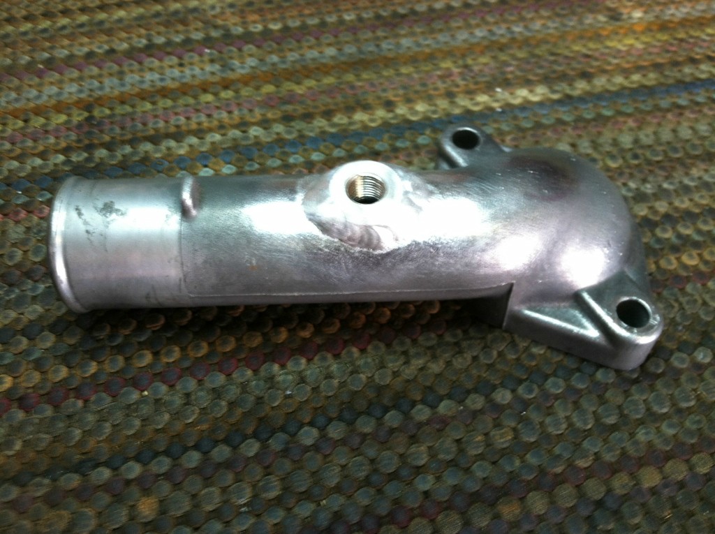

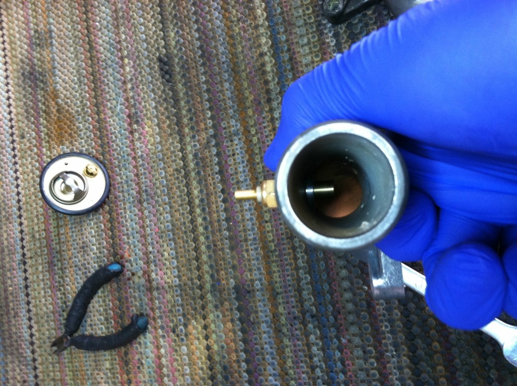

Took my thermostat housing down to the local weld shop and had them weld in the sender bung for 20 bucks.

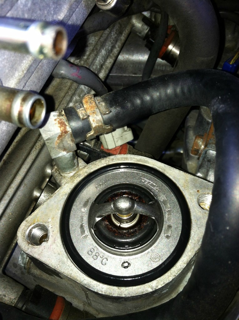

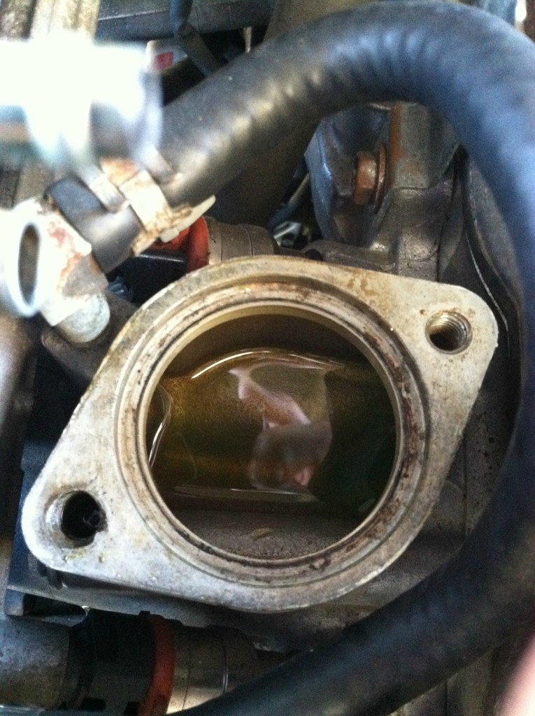

Upon removing the thermostat I destroyed the threads on the intake manifold that bolt the thermostat in place. Notice the non-existent threads on the left hole.

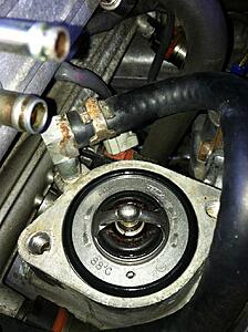

A helicoil fixed that right up. Also brand new OEM thermostat.

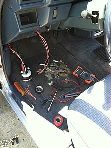

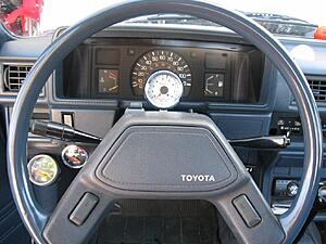

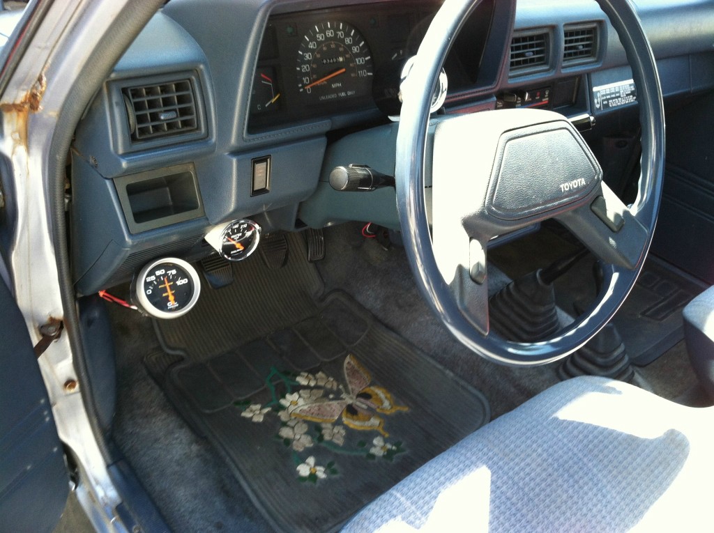

Now for the gauge install. I am getting a gauge pillar soon but for now this location would suffice.
Little bit of Scotch double sided sticky tape and its mounted.

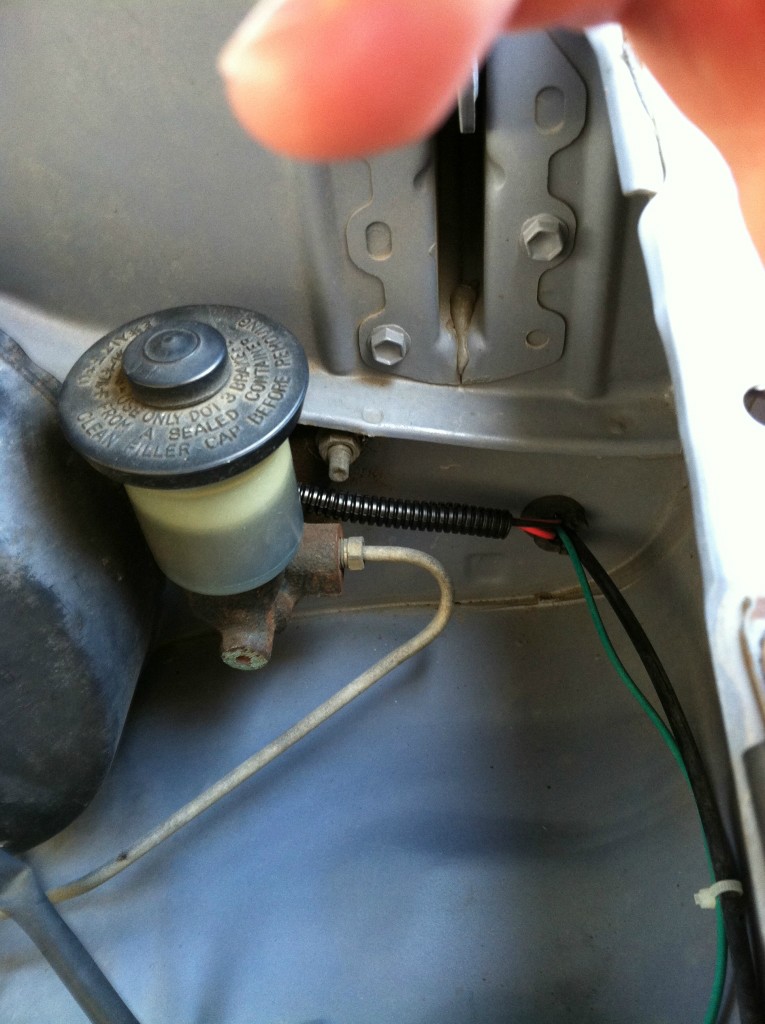

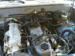

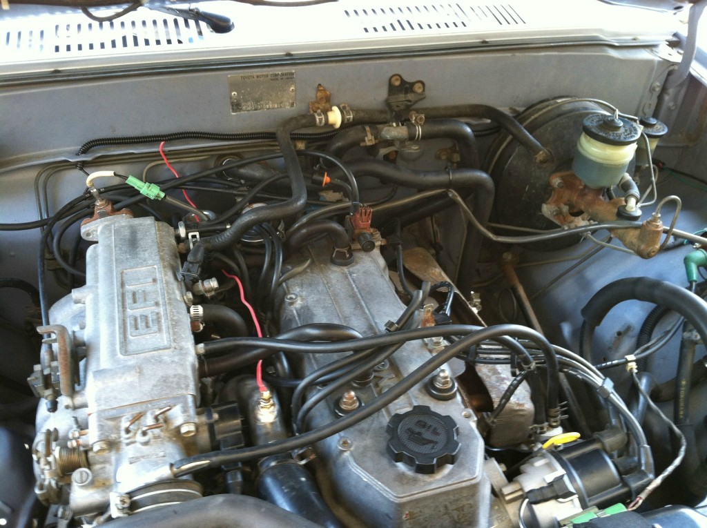

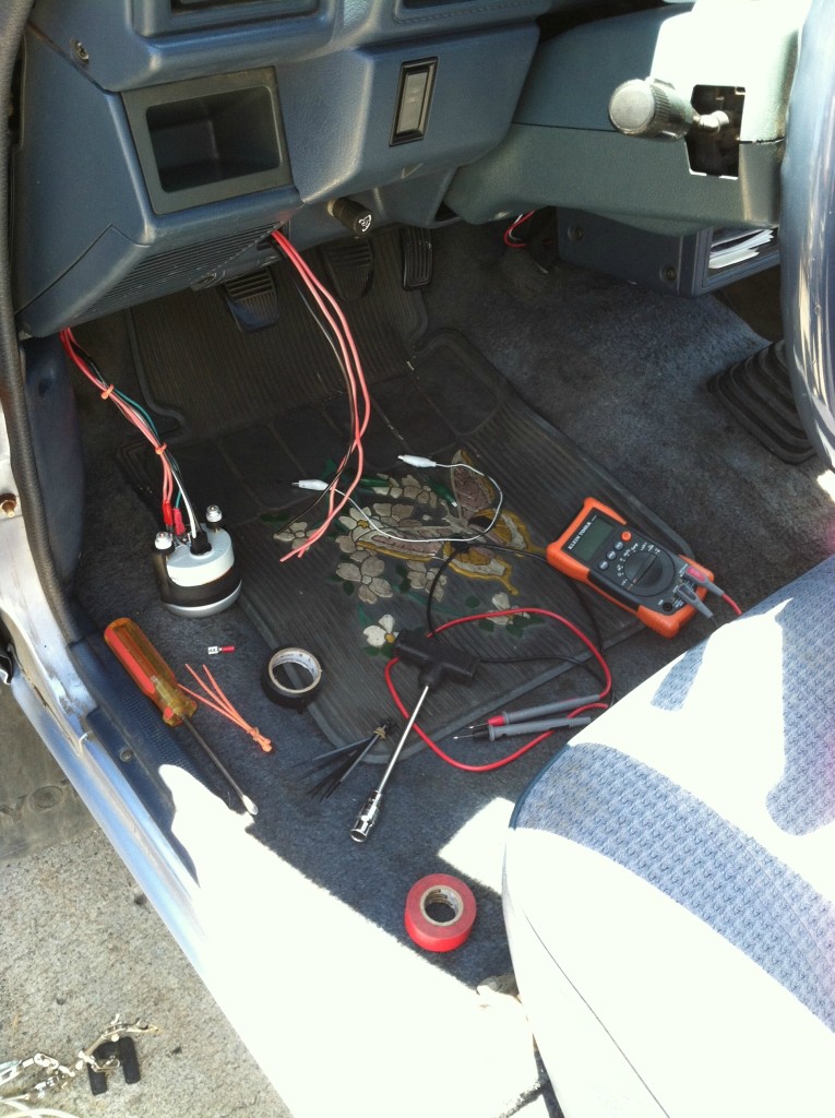

How I routed my wiring.
I should've used a color that stands out a little less.

Cover that wire with wire loam and it will blend right in. Nice idea on the bung.

Now you just need to reconnect your vacuum lines.

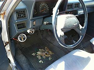

Dude those butterfly floor mats are so cool!!! Retro written all over them!!!! Also did you fix that split line in pic 5? Anyway looks good.
Old Jul 22, 2012 | 05:49 PM
xylicon's Avatar
Joined: Dec 2010
Posts: 197
I couldn't remove those vacuum lines so I had to cut them, I have since replaced them.

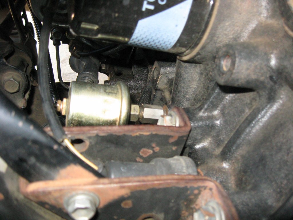

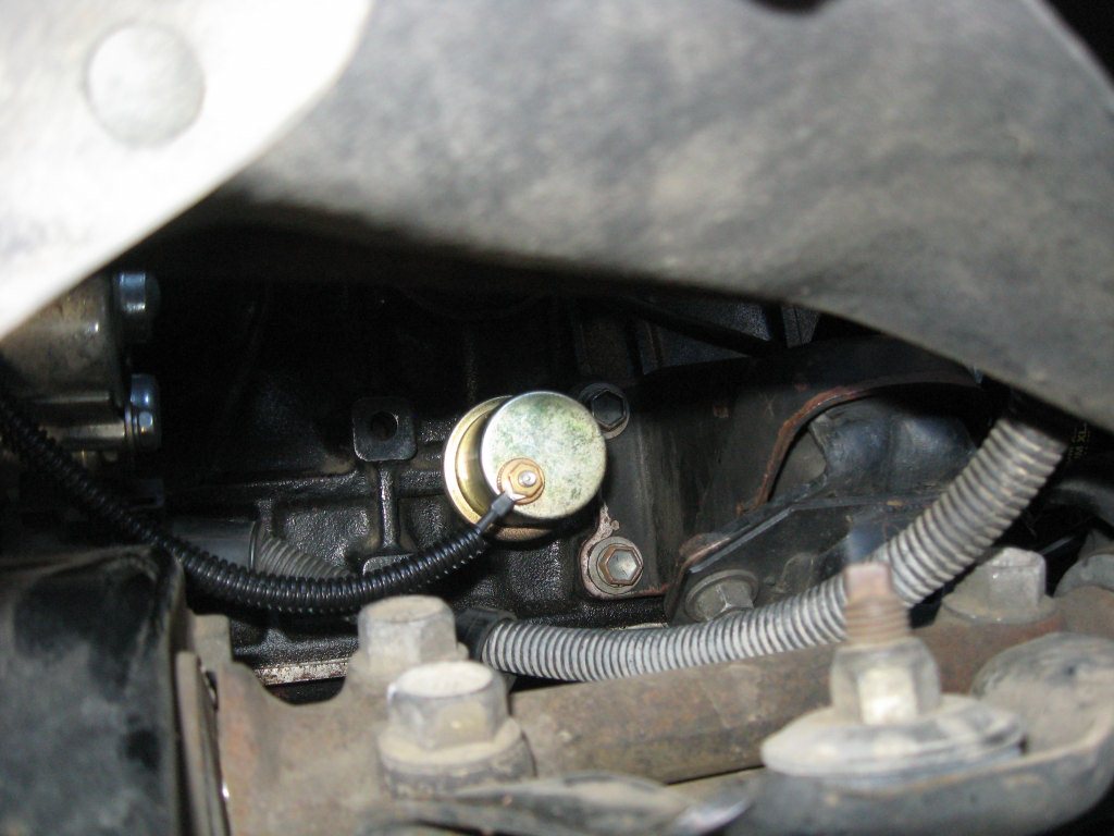

Figured someone would like to see how I installed my oil pressure gauge as well. See pics.

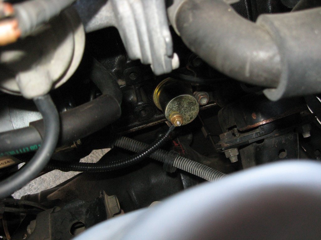

Installed gauge sender, had to use a converter for it to fit. LCE has the converter.
I moved the stock gauge sender to the forward location right inside the engine mount, I like to have some kind of redundancy in all my gauges.
Side view

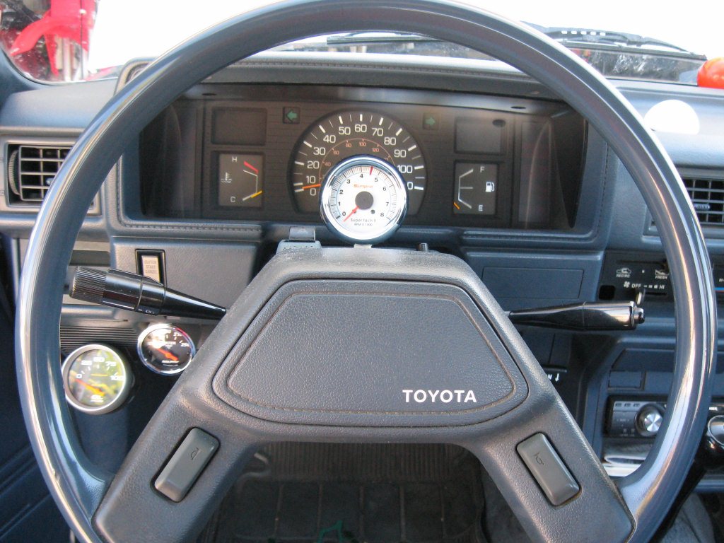

How I can see my gauges for the time being

How did you ever get the water neck clean enough to weld??
Or did you just buy a new one.:jessica::jessica:
Old Sep 8, 2012 | 07:14 AM
xylicon's Avatar
Joined: Dec 2010
Posts: 197
I just ran it under a wire wheel for about 30 seconds, cleaned it right up in no time.
