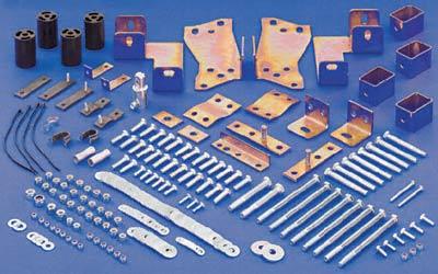

i have a 3" body lift for my 4runner i was wondering how hard it would be to install the lift by myself? has anyone else done this before? and also i dont know if this kit comes with instructions or anything so i dont have a great idea of where everything in this picture goes. if anyone near baltimore knows how i to install a lift i would pay them for thier time helping me. so please anything you got on this tell me i wanna know everything about doing this.

Its really not THAT hard, just time consuming. What kind of kid did you buy?
It should come with instructions, my Performance accessories kit did BUT there are some things that they dont bother to tell you
First thing you want to do is soak all your body bolts with some kind of penetrent lube for about 1-2 weeks in advance.
I used liquid wrench and sprayed all of the bolts probibly 4-5 times, really helps!
for tools we had
1 jack
Impact gun
Breaker bar
socket set
screwdrivers
and some 2x4's to spread the force of the jack equally on the body.
torch ( to take off a seized rubber body bushing and bend my shifters)
Make sure you have LOTS of time for unforseen problems. my body mount and a few other things set me back a day.
The steering extension that they gave us did not fit by the steering pump like they wanted it so we had to install it by the steering wheel.
If you have the stock air intake you might have a few problems, we had to flip the elbow unside down to lower the intermedite pipe enough to make it to the throttle body.
The body MIGHT shift, mine did a little but just had to shive it around a little to get it back in place.

As mentioned its not that difficult of a job but there are a few things you do need.
The first things that come to mind are a friend and instructions. You can't do it alone with no idea of the order of installation or where this stuff goes.
That kit appears to be missing a few things too. There should be 6 pucks for the cab and 8 for the bed.

I am in So. mD. if you think you need a hand let me know I will try to get there and help with it. I never done one but did my suspention lift and it was a bitc@@@ without the correct directions but the body lift should not be to bad. Just remember that you will need a steering and gear shift extention and radiator, bumper brackets so make sure they come with the kit. Also try Roger Brown for a quility kit with great directions.

Keep in mind that a lot of online retailers don't take pictures of every kit they have. Most retailers just use a generic picture of a kit.
