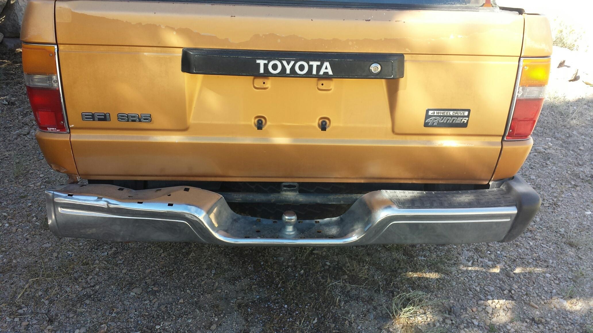

Here are the best pics i could get from them:
Front
Rear
The hood, fenders, and grill all seem to line up. The front looks to be pushed in and the obvious gap on passenger side. I havent been able to see the car in person yet. Anything i should look for that will tell me whether ill have to bend it back or not?

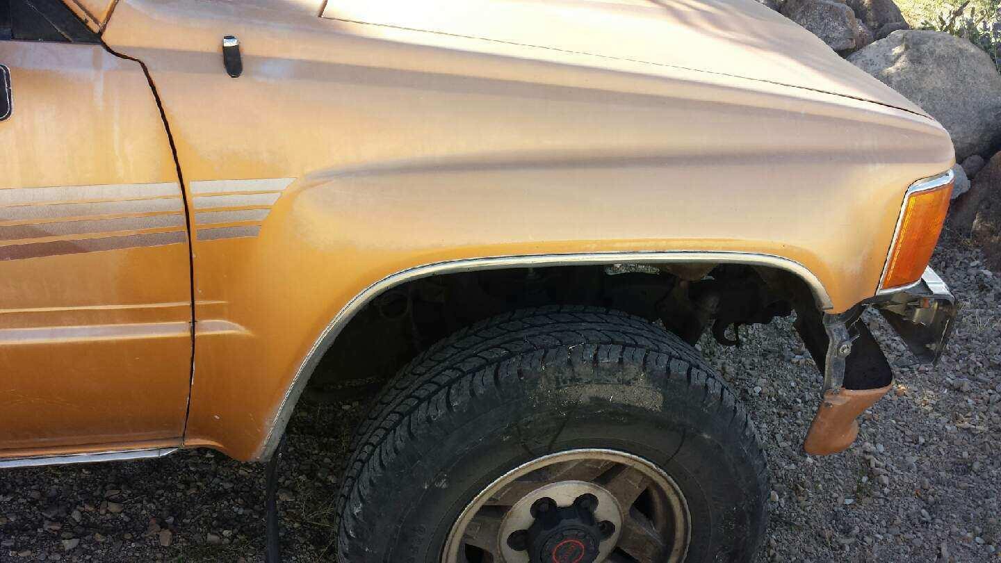

Front passenger side and fender
Attached Thumbnails How to align front and rear bumper (86 4runner)-image.jpg

Front driver side and fender

Front passenger side fender again

Rear. Need four more words

Is your final goal to have it look factory original??
Being it is a 86 finding new bumpers from Toyota will be very difficult you most likely will end up with after market.
Other then the dinged bumpers the paint looks better then any of the ones I have.
If the price is right and the rest is in good shape go for it.

Luckily i have another one in my driveway with all the original parts i would need to swap over. So one could be factory original while the other could be aftermarket or just sit around until i source the oem parts to but back on.
In your opinion, just from the pictures given, would you guess that the mounting brackets would need to be bent in order to get everything to line back up? If you havent noticed, and if youve seen my other projects, im pretty ocd when it comes to things lining up. Gaps make me

I would say the mounting bracket is bent as well. Replacing it is easy to do. Dont see where you are located but those are fairly easy to find.
The end caps will eventually come off. I use carriage bolts about the same size as the bumper bolts and remove the tab that is glued on and run the bolts thru the center in the back side of the caps. It looks like it could of come from the factory this way and they are never going to come off again. I have lost Toyota and aftermarket end caps on the road and this is how I fixed my issues. This is an old picture and I have it algined and painted but the only one I could find right off.

If the bumpers themselves aren't damaged, you should be able to use a BFH and some muscle to get the brackets straightened back out. Looks like a nice runner. More pics!
