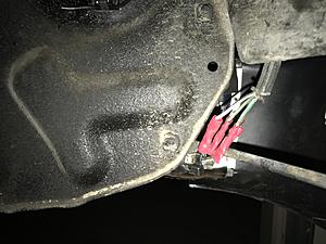

4) I followed the wiring from the horn and it looked damaged where the horn and Passenger Blinker wiring connect in front of the passenger wheel well. I rewired it but still no horn.

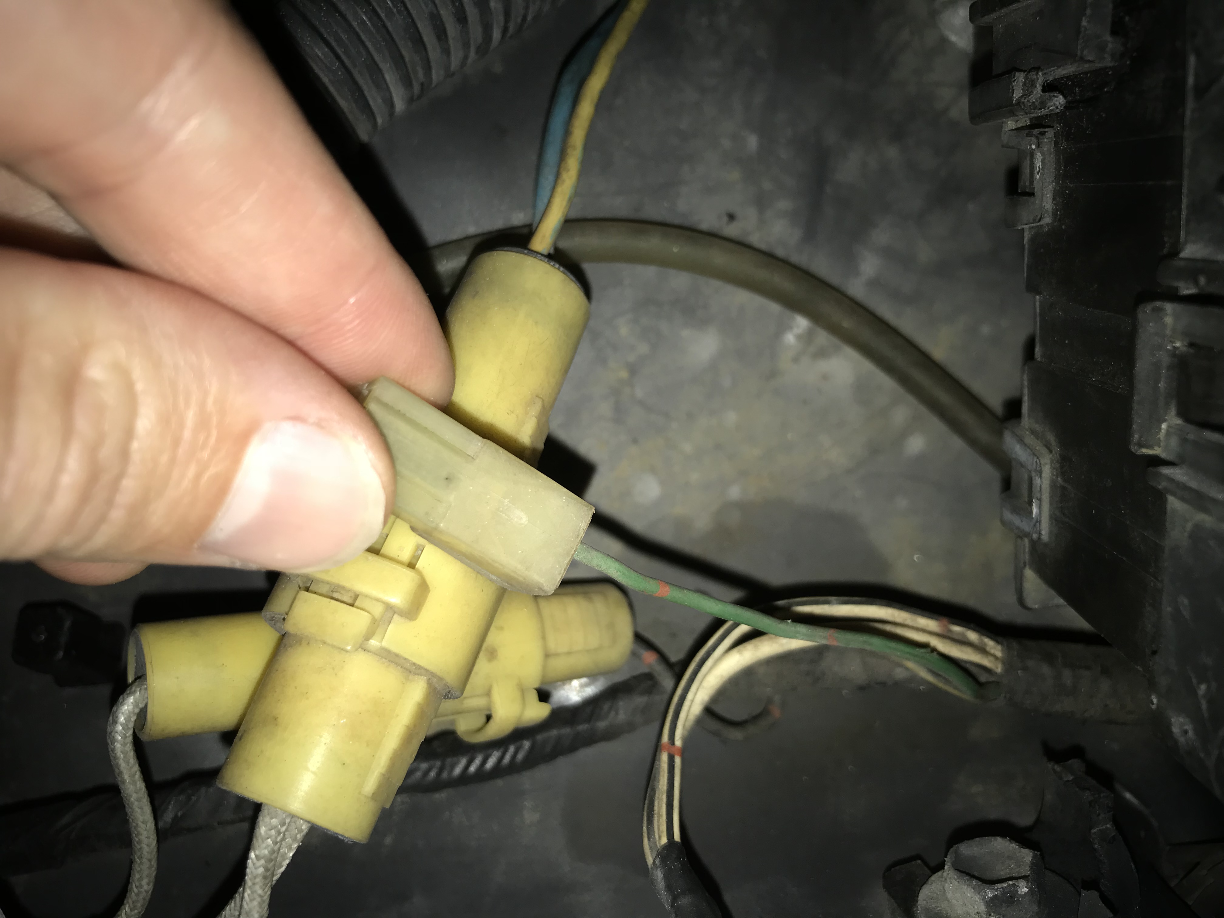

Pics below. I cannot follow the wiring after the wheel well.
I did find a random connector not connected at the ground location near the engine bay fuse box, but looks like a different wire.

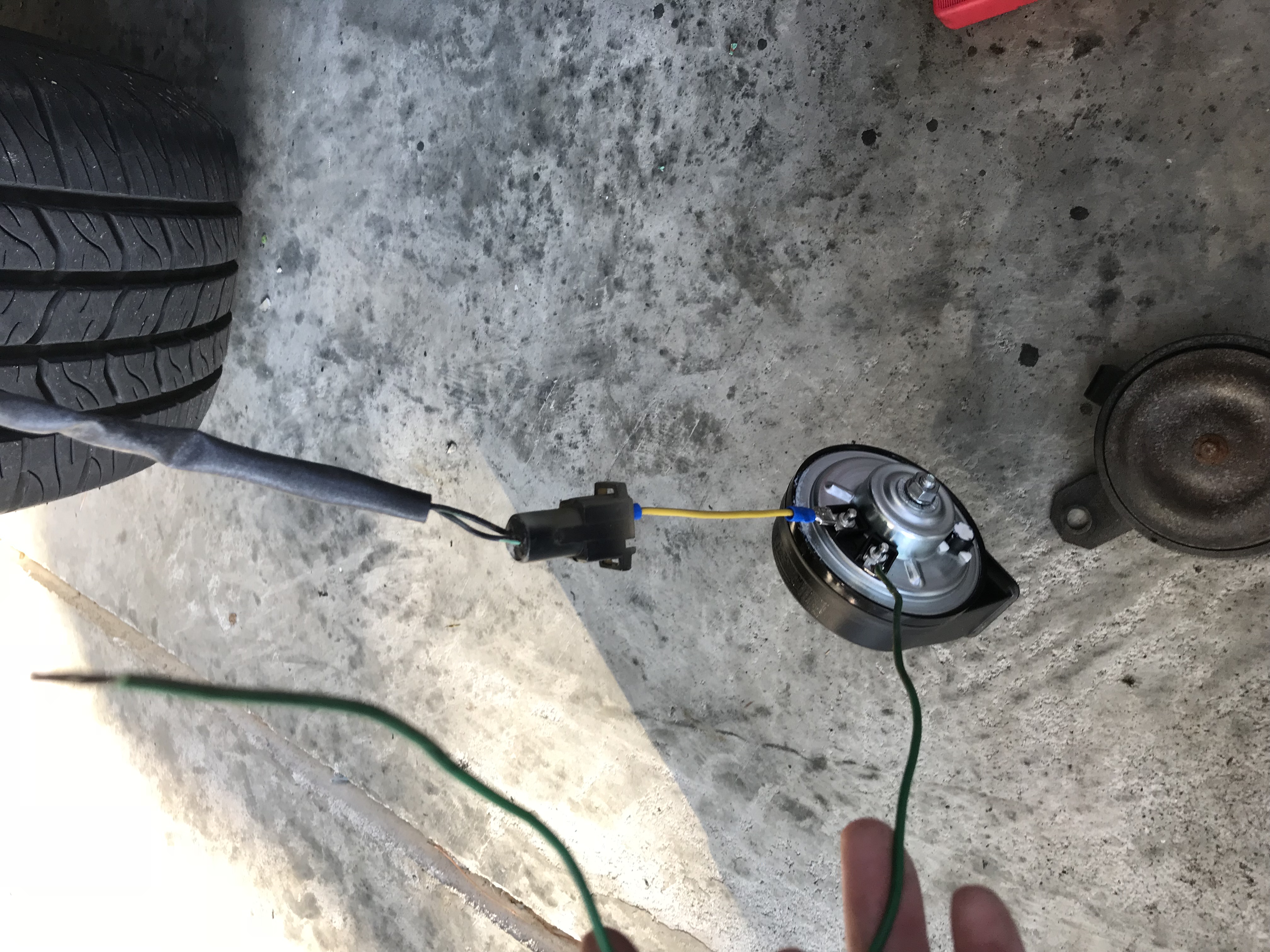

Yes. I hooked the new Amazon horn to the positive side, then manually grounded it and the Horn worked. Which means the ground is the issue. Now what?
Ooh, and I think Green with White Stripe is + and Green with Red Stripe is Ground. The wires turn perpendicular inside the plug, so it’s hard to tell for sure.

Update: It works. I messed with the wiring and re-ran wires from connector to Amazon horn and it works for the first time. Horn sounds good too. I guess it was the wiring all along.
